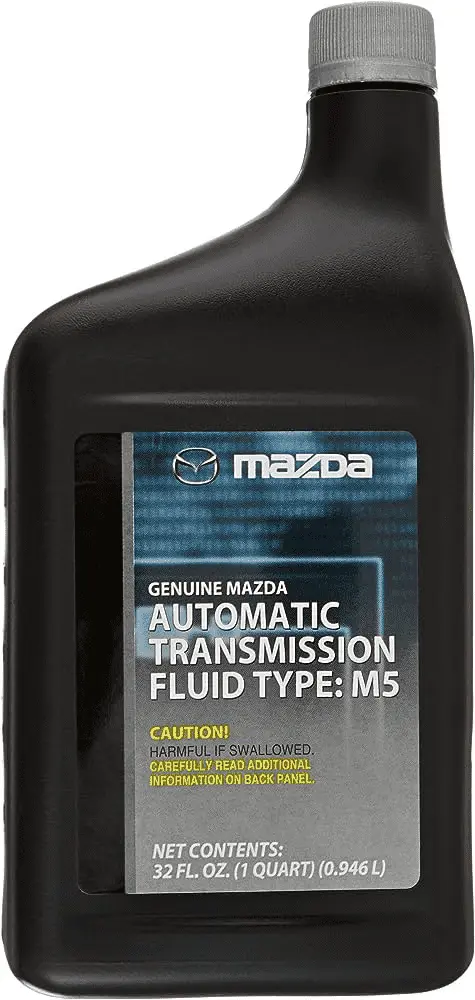

M5 is $12/qt at my local dealership.
But even going by your $20/qt, do the math. Once every 30,000 miles, you spend $80 on some ATF vs $24, a difference of $56. That's an extra $2.34/month for the correct fluid vs risking damaging a minimum $3000 transmission using the wrong stuff.
Could you pls give me the part # for the ATF from Mazda?
What is the name of your dealership?
This is the stuff. Most dealerships are +/- a couple of bucks from one another.
Thanks all and specially @theblooms
