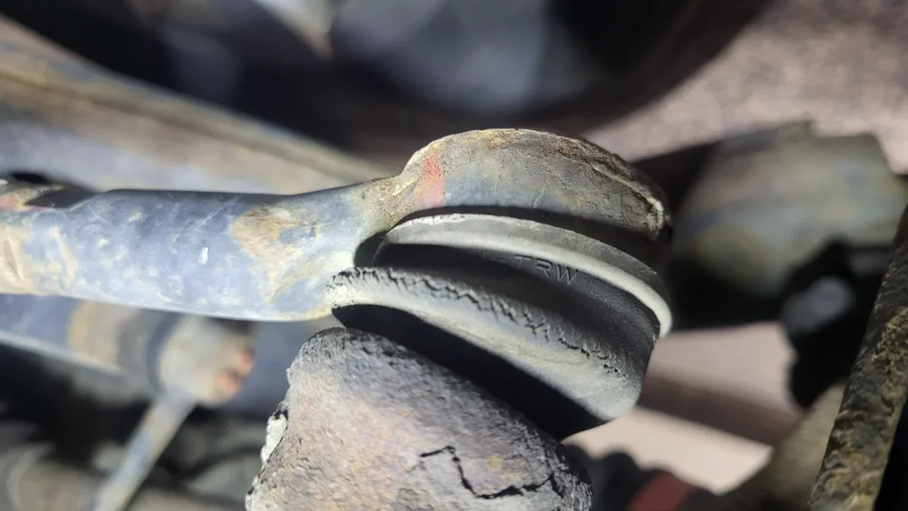

Just a bit of a update, for anyone looking in the end.
After doing the tie rods, balljoints and sway bar links with CTR parts.
(I chose them since they are a very big OEM)
But while doing it, I can see the factory tie rod end say "TRW" on the balljoints.
The lower balljoints, I would say are likely the same, and similarly the sway bar links, but I am not able to confirm as of now.
That said, the tie rods end do not look to be sold by TRW to the public. However the ones sold by 555 look to be the closest match, just unpainted which is a commonality for 555 aftermarket parts.
So for further reference I would go TRW, 555 or CTR on a personal account of the parts being high quality but certainly their own design.
