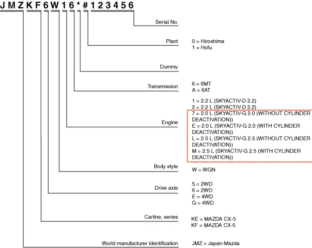

I just bought a '24 preferred as well in early March. The VIN number is the way to tell. An M in the 8th digit position means it has CDA and an L means it does not. If you don't have I-stop you don't have CDA...
OK, I'm confused. Our 2019 CX-5 does have an M in the 8th digit position, so it has CDA. But it does NOT have i-stop, which from your statement says that it doesn't have CDA. Was that a typo?

I don't have that particular North America VIN section but from European specs this is the decoding:
2.0 engines and Diesel aren't sold in NA and 2.5 Turbo doesn't have it. If you check Mazda USA new 2024 models 8th place VIN #, they're all L, compare that to any previous year.
European (L.H.D. U.K.) specs.

That’s one way to tell, and the VIN number:
... NOTE: To identify vehicles with cylinder deactivation, examine the (HENRY THE) 8th digit of the VIN.
• L
(ove): 2.5L without cylinder deactivation
• M
(isery): 2.5L with cylinder deactivation ...
