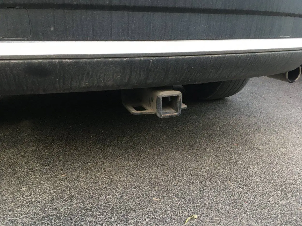

I have a canadian dealer installed hitch. I think the canadian OEM hitch is not really OEM. I am pretty sure it is an aftermarket hitch installed by the dealer. I don’t remember the brand on top of my head but can check on my cx-9. It also does not involve cutting into the bumper. It sits lower and under the bumper. Doesn’t look as clean, but way better than a 1.25”.

Here is a photo of my Canadian hitch installed by the dealer. I think it might be a Curt hitch, but couldn't confirm 100% (The ball mount they gave me is a Curt. But I couldn't see anything on the receiver to confirm the hitch receiver is also a Curt receiver).
The US dealer I bought my CX-9 from offered a Class III hitch in addition to the "factory" Class II. We went with the Class III (Curt brand if I recall) and it was well worth it as you mentioned. I don't tow anything heavy but even things like trailer hitch baskets stick out far enough as-is that I didn't want an adapter in the mix.
It'd be worth asking the dealer you leased from if they offer a Class III option that they'd be willing to install. It sticks down below the bumper so there's no cutting body panels.
