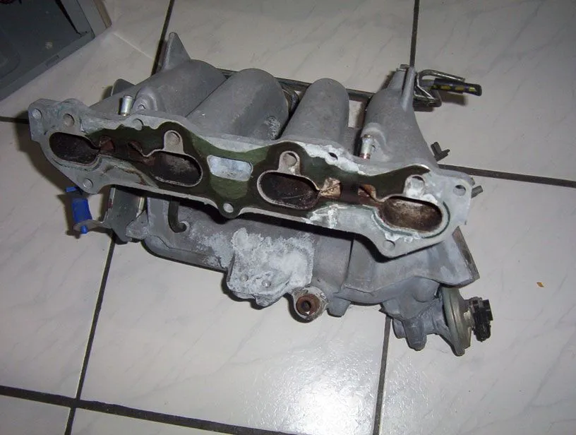

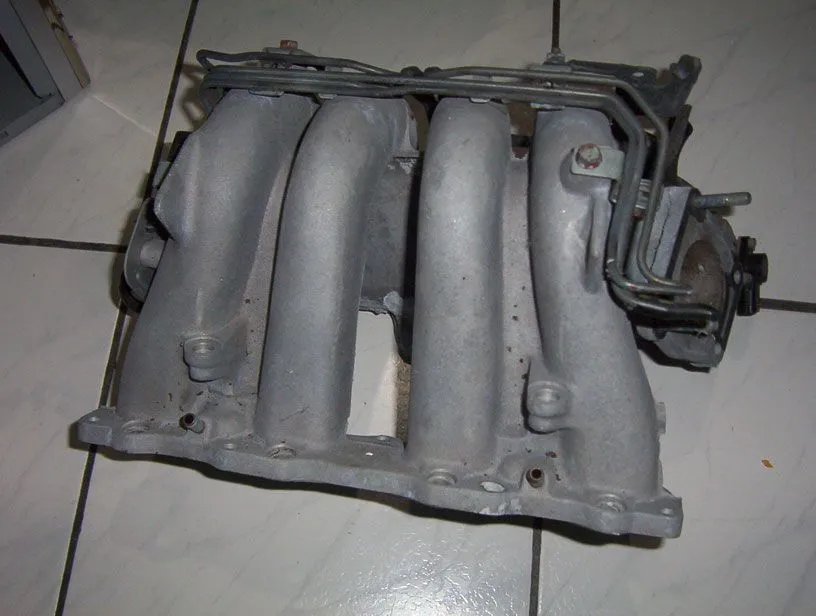

how about the Ford Probe SE 2.0L FSDE Intake Manifold?
Long runners, no flappers or anything...
just took these pics right now.
looks similar to the one i am using... It "should" fit, but dont quote me. I went with the one i did because ********** did all the dyno testing on it already and it has proven gains.
It really does suck for cullen and ********** that this manifold is the exact same. I feel really bad for them because they did all the r&D and now it comes to light it is the same as an oem piece.
It is unfortunate, but thems the breaks I guess.
-Bryan
It fits perfect on my spare engine here. Only issues is the brake booster and egr... And it needs a custom fuel rail or the stock probe fuel rail.
