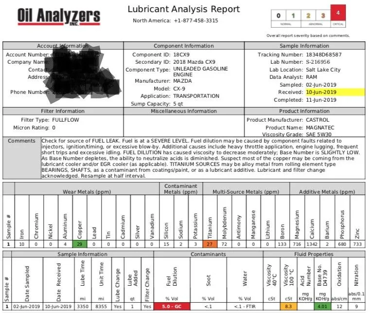

Got an analysis for my 2.5T from oil analyzers... aaaand 5% fuel in 3350 miles.. ouch! (nailbyt)
attachment.php
The oil happened to be a cheap Castrol GTX magnatec. If I understand correctly, it should not affect fuel levels? Better oil should have just maintained the viscosity better.
Possibly more relevant fact was that I ran only 87 gas this time, as a low interval experiment :)
Switching to 91 and AmsoilOE, will check again in 3500.
attachment.php
At the same time got a report for a q5 with 70+k miles. Only 1.6% over 9500 miles. Most of the mileage was rough due to carbon buildup.
It's the first time to me seeing an oil analysis on a 2.5T with oil dilution issue. On the other hand we did see several reports that when they check the oil level on their 2.5T, the oil level is over the "MAX" mark. It could be caused by over-fill from factory, or the oil dilution? Only time can tell.
I don't agree Castrol GTX Magnatec is a "cheap" (bad) oil though. It's a full synthetic oil and 5W-30 is the recommended viscosity. It's API SN PLUS/ SN, ILSAC GF-5, and GM dexos1 Gen 2 certified.
I also don't believe 87-octane gas has anything to do with your oil dilution issue either. We shall see with your next oil analysis which should confirm many things. Please keep us posted.
