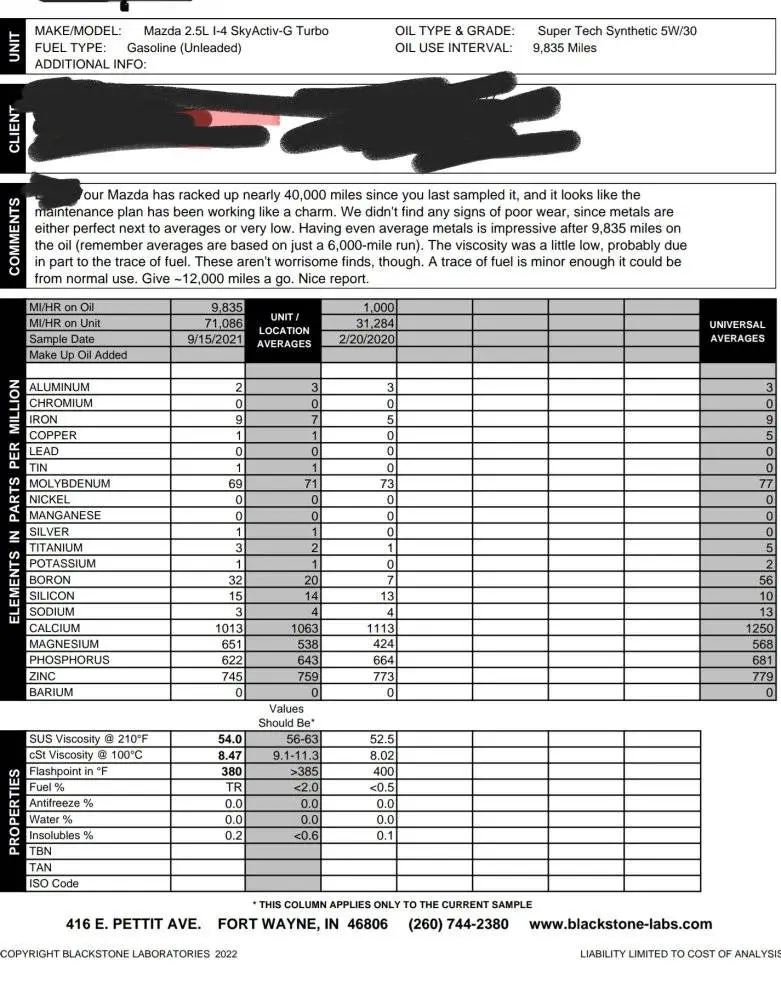

Hi there. Just tossing my two cent into this matter. Here is my cx 9 2016 Grand touring at 71k. Heads up I purchased car used and the owner might have not did an oil changed for 24k miles... When I purchased it, it did 2 flush (Liqui Moly 500ml Pro-Line Engine Flush) and cycle 3x fresh oil in 1k intervals to flush out any issue. That is why my first oil sample only had 1k on it. From what it seems my Viscosity is low with both sample. So it might be a normal thing with these. Blackstone didn't really made a big deal on it. First sample used. "Castrol GTX Ultra Clean 0W/20". 2nd one was " Super Tech Advanced Full Synthetic SAE 0W-20 Motor Oil rated for 20k miles.
I'm guessing you meant 5W-30?
Anyway, nice report! Glad to hear your CX-9 hasn't given you any issues thus far.
Ya, 5-30w. Going to keep this suv as long as possible. Mazda is ending the cx 9 in USA market. They are switching to Cx-90 soon.
