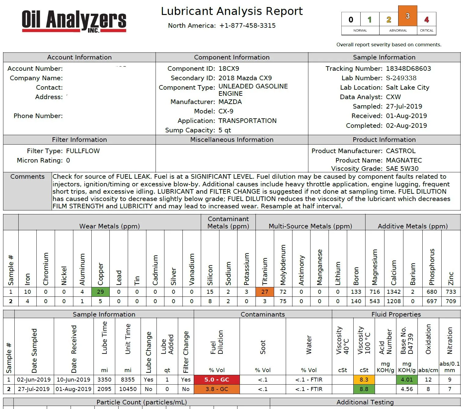

OK, 3.8% in 2.1k.
attachment.php
Difference:
1 sample:
- winter, jan-june
- 60% short, non-highway trips
- Regular gas
Oil level dropped alot after first 2k. Had to add 1q, then stable. Never seen it going up.
2 sample:
- all-summer
- 70%+ highway
- Premium gas
Oil level possibly a bit up at the end. Mid-level after fill, a bit above middle at sample.

OK, 3.8% in 2.1k.
attachment.php
Difference:
1 sample:
- winter, jan-june
- Regular gas
2 sample:
- all-summer
- 70%+ highway
- Premium gas
Haven't had a chance to open a claim yet, now I plan it in couple of weeks.
I was a bit skeptical after 1st sample. I have been changing oil and sampling 3 other turbo engines in last few years. None had oil dilution. And with this one I don't notice any difference in smell etc... I kind of expect it to be obvious if it is that severe. This sample adds some confidence :)

Well just got my analysis back from Oil Analyzers and it showed the fuel dilution as 4 which is critical and there is a little loss in viscosity. I guess I will be making a trip to the dealer. Has anyone taken there car to the dealer for this problem? I would like to know what your dealer said. Thanks
