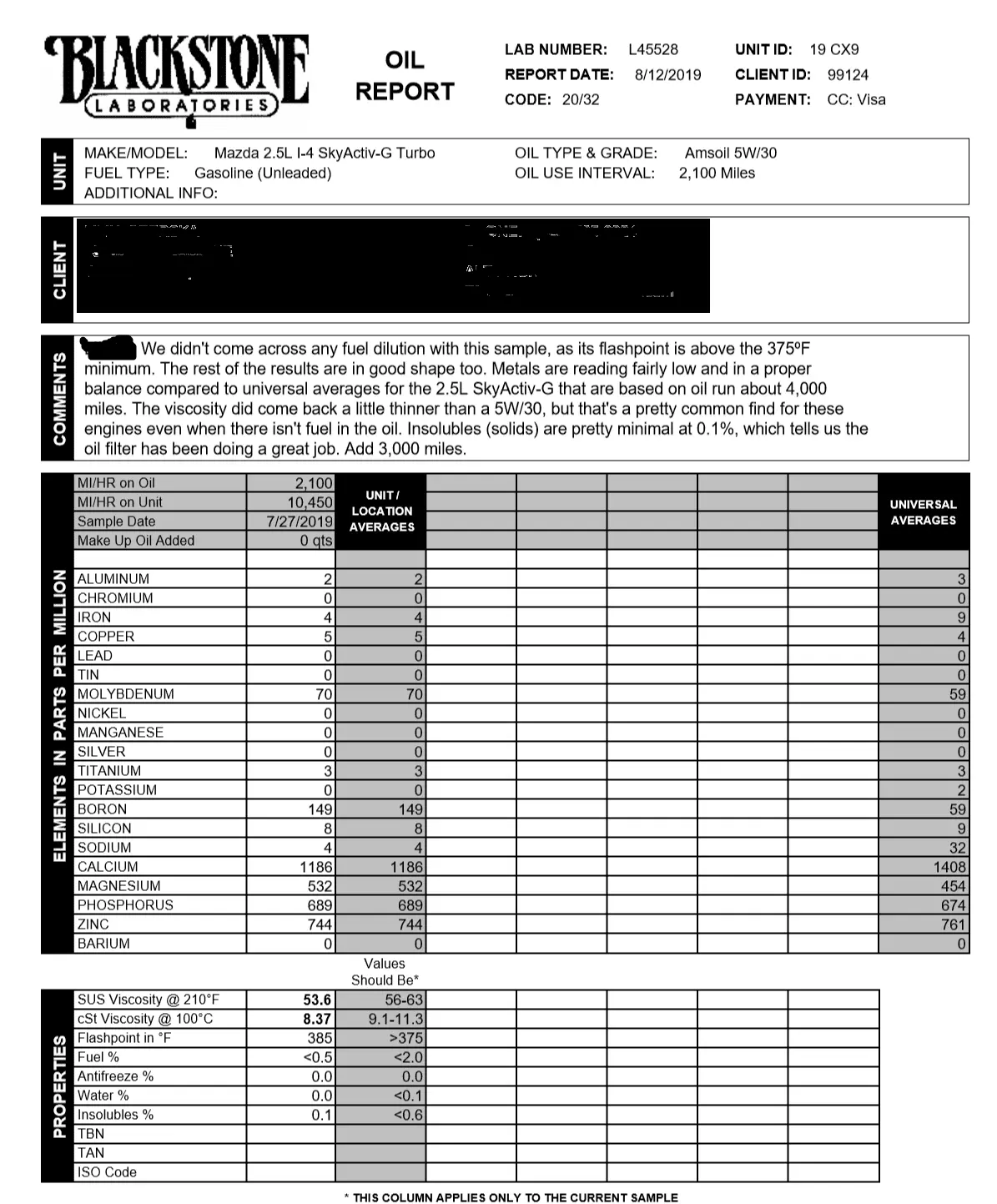

One more point on labs. The Blackstone is very popular lab, but they don't do proper fuel dilution analysis even though they provide the "Fuel %" value in the report.
They simply derive it out of flashpoint test. Their staff seem to think its a reliable test. I have send my previous sample with 3.8% to them in parallel and their recommendation was totally misleading:

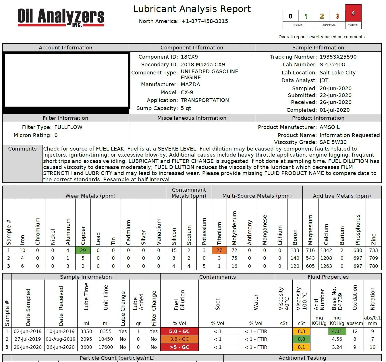

Got an analysis for my 2.5T from oil analyzers... aaaand 5% fuel in 3350 miles.. ouch! (nailbyt)
attachment.php
The oil happened to be a cheap Castrol GTX magnatec. If I understand correctly, it should not affect fuel levels? Better oil should have just maintained the viscosity better.
Possibly more relevant fact was that I ran only 87 gas this time, as a low interval experiment :)
Switching to 91 and AmsoilOE, will check again in 3500.

1. Now I do 2500 oil intervals using cheaper oil. really just use Costco synthetics. And changing oil filter every other time. Since I do the oil change simply because it got diluted - I can save on a mess and environment a bit by leaving the filter :)
2. Make sure I get accurate dilution value. There is one trick to Oil Analyzers. On other forums, I learned that they don't always run the advanced dilution test. Unless you specifically ask in sample notes, they might run a simple test that normally just shows 5% instead of like 3.8-4% or 0% instead of a small dilution. The difference is important because 5% is a max dilution they can detect. If you get that, it could be anything above. Viscosity value is usually a good secondary indicator, though.
So I asked for a detailed analysis, Oil Analyzers ack'ed my request in analysis notes, and the result was 4%.
