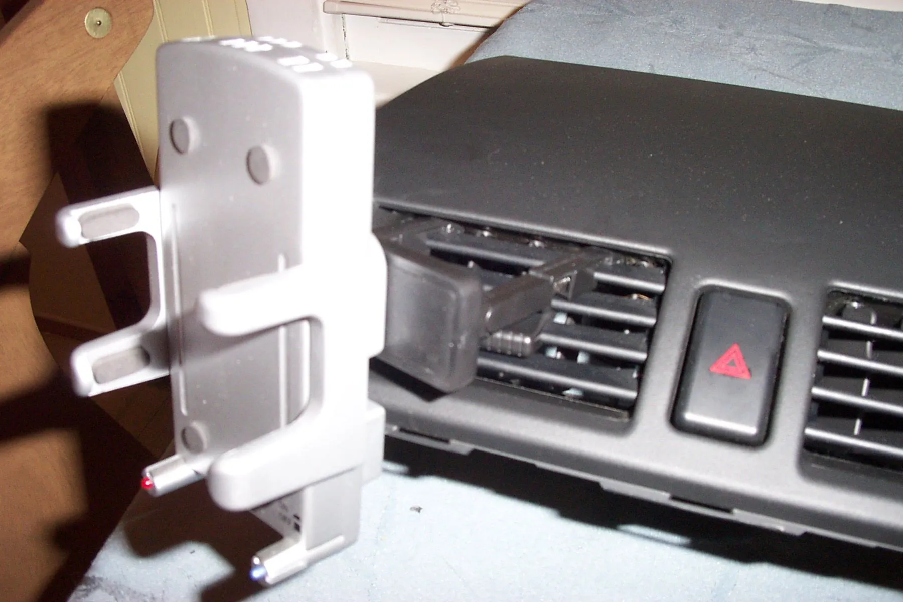

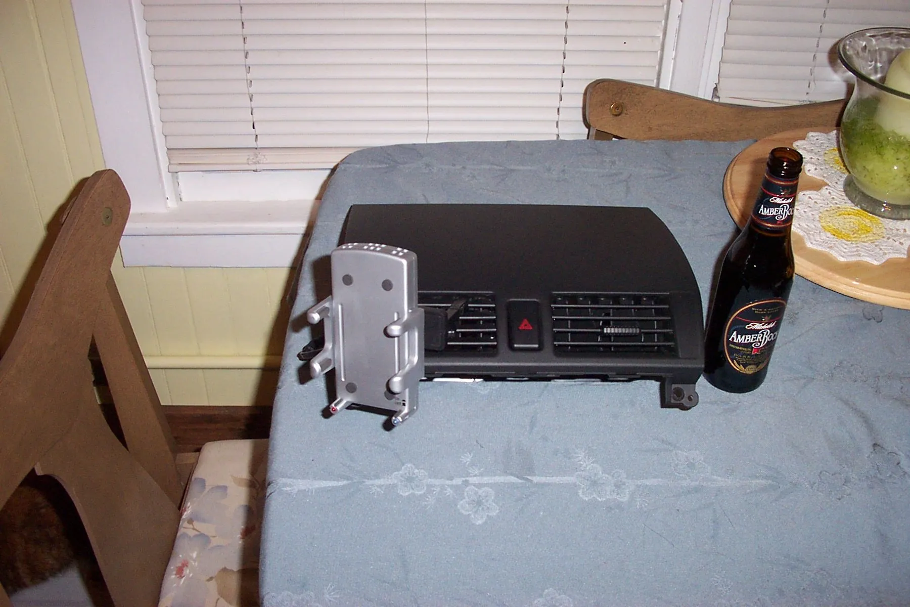

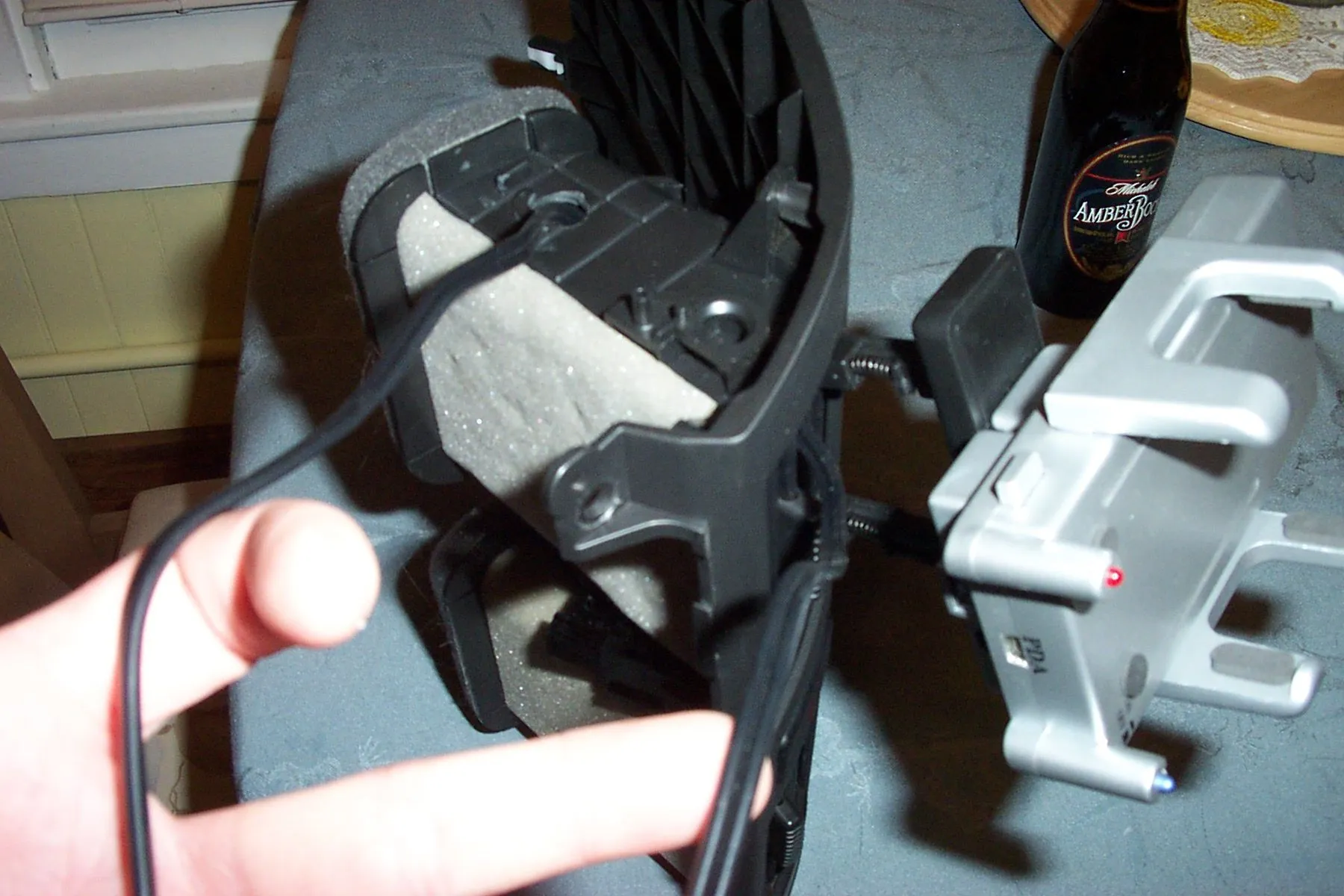

notes: have been using this unit for 4 months. Finally getting to use it for media in the car..... check out the link, it's pretty hot for the price......(802.11b, bluetooth, Infra-red. Many good things..)
http://www.gomadic.com/pdamoauho.html
notes: flexible and strong, alot more positioning options than the pic looks...
relatively CHEAP plus the silver and black color scheme goes nice w/ my sunlight silver metallic 3s 5dr.
Tonight I just did the mount,.... Tomorrow I'll get the in-car done.
later. (smoke)

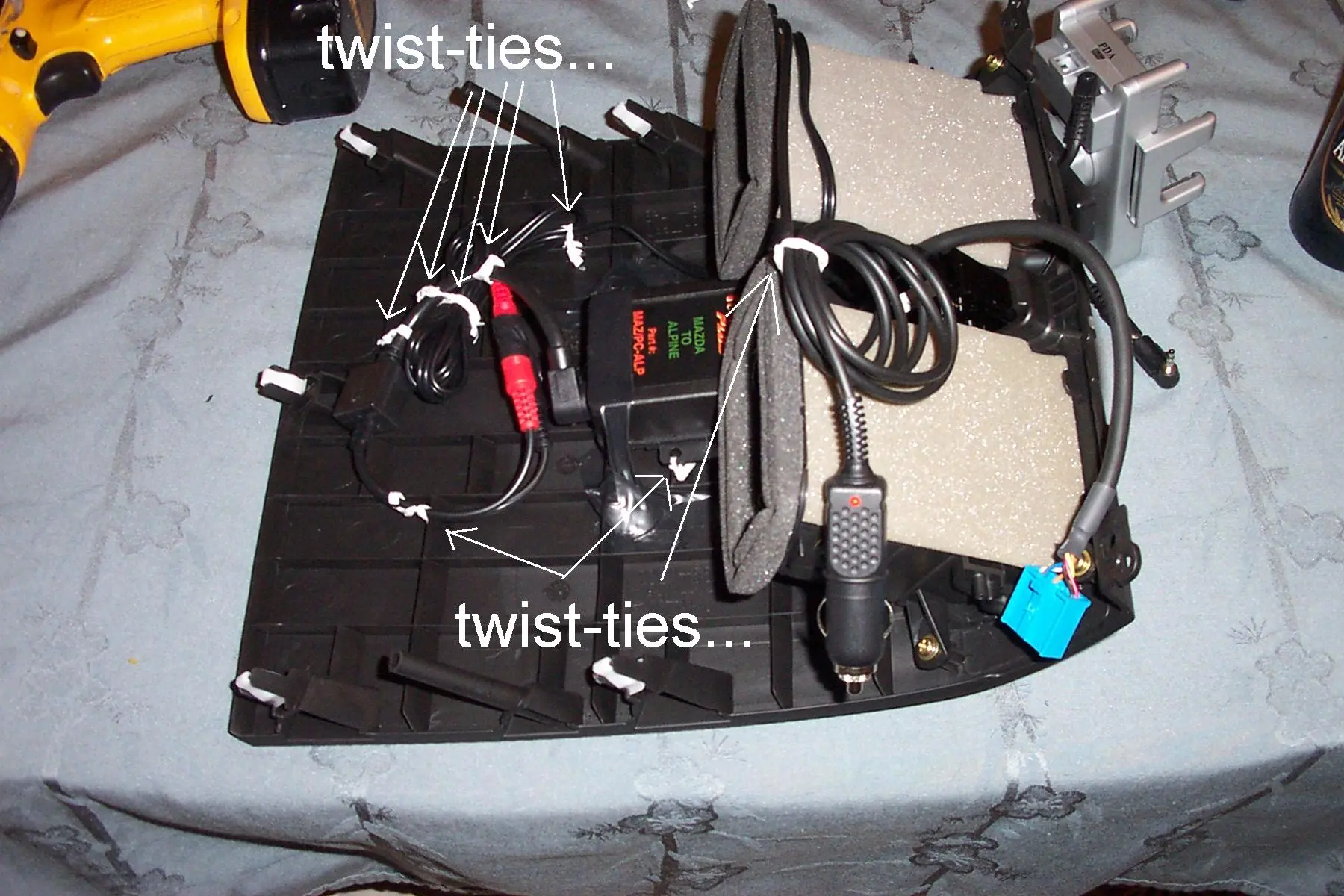

On the last pic, most of the twist-ties loop through a hole drilled in the closest panel brace.. (little piece of plastic used as a brace for panel integrity (RTM) )
doesn't show up very well, but it helps keep the whole setup secure to the panel..

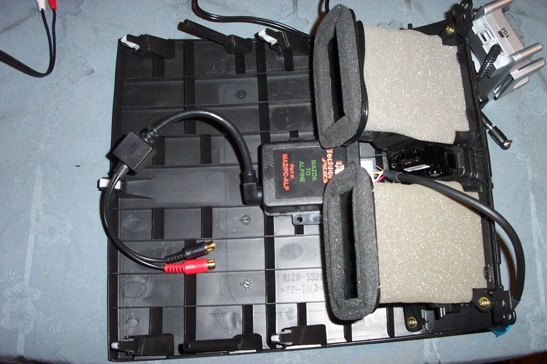

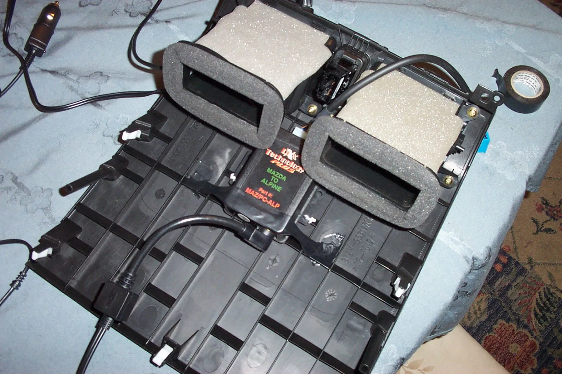

Silver Bull3t said:
rest of pics
Add the optional PIE ALP/M-RCA adapter to this item and you will now have a set of RCA auxilary inputs instead. Devices such as XM Satellite Radio, VCR, MP3, Video Game Systems, and DVD can then be added to the Mazda OEM radio without FM modulation.
DPX technology maintains full function of all factory built-in steering wheel and/or rear seat controls.
Compatible with the following Mazda models that have an available 16-Pin CD changer data port on the back of the radio:
* 2004 Mazda 3
try here:
http://www.myradiostore.us/auxadapters/pie/factory/no-external-changer/maz-pc-alp.html
Everything installed nicely. Sounds great, very happy... Had plenty of room
for the maz/pc-alp unit and cords.
Did some led mods too.. I'll try and get some pics 2nite. (usa)
