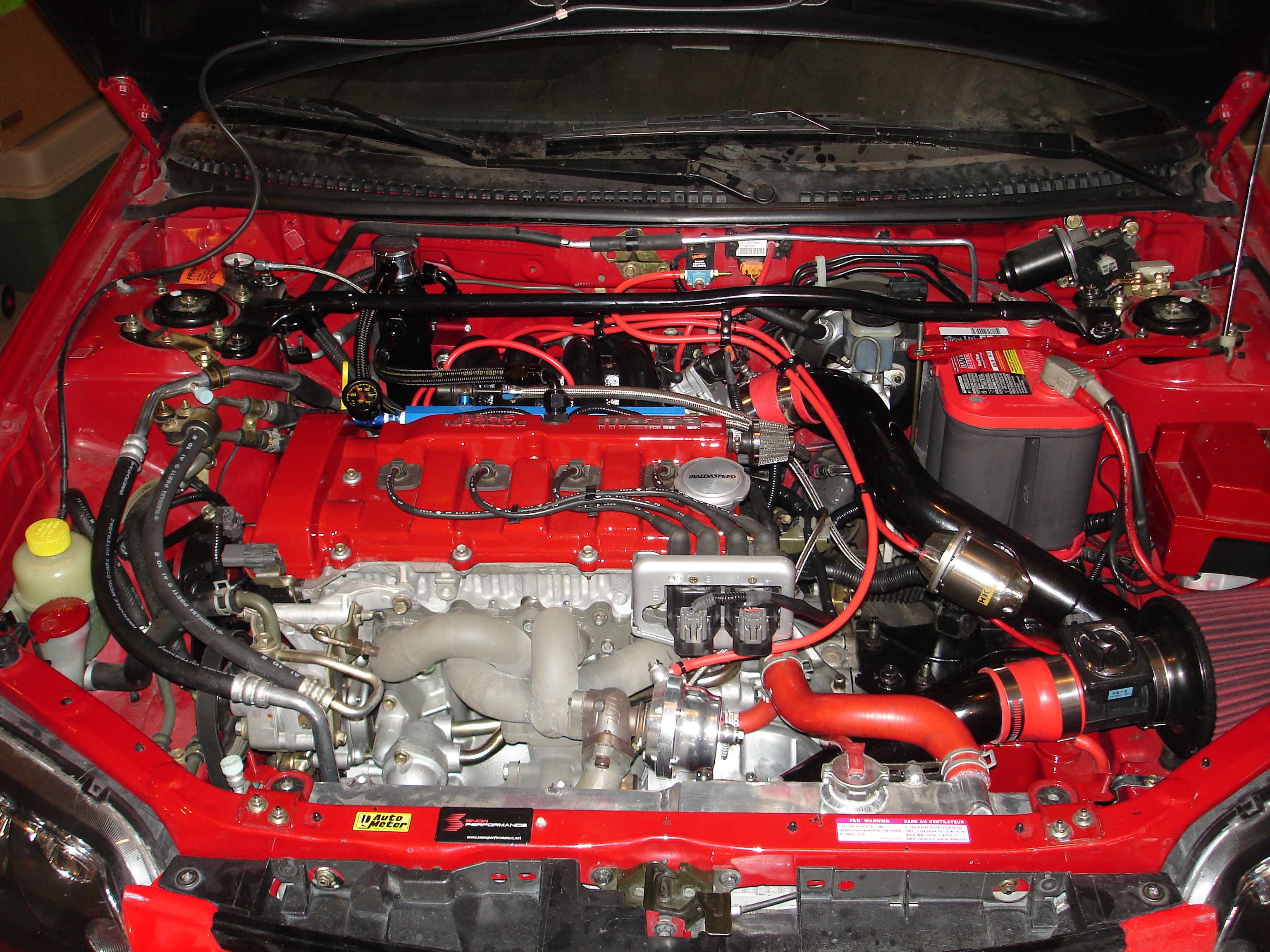

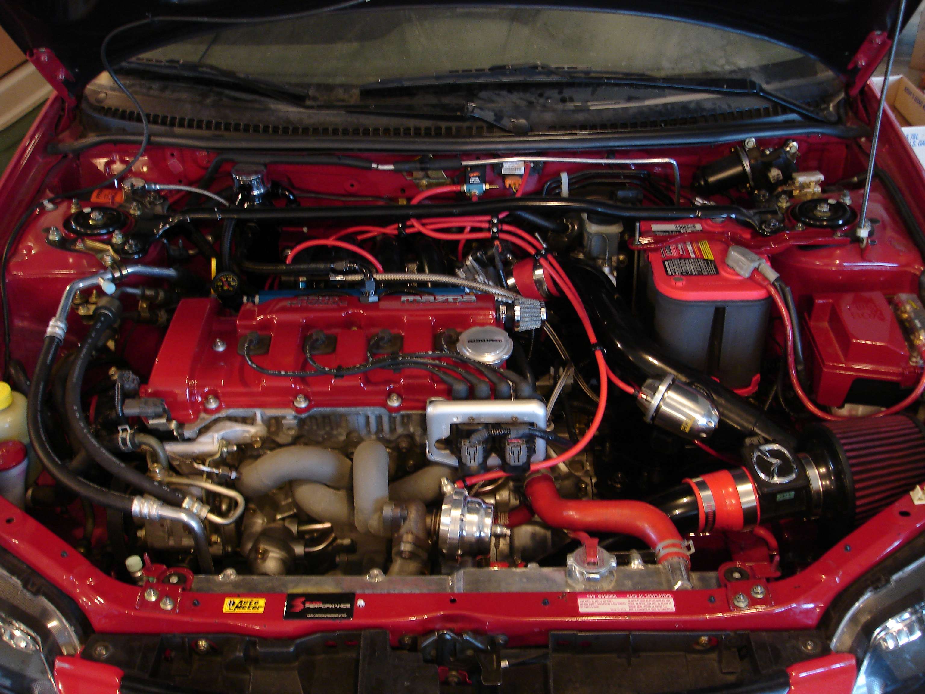

The finished product:
I've got most issues worked out now, a few remain. Oil pressure is awesome after switching to Shell Rotella 15W-40 for the remainder of the break in. Idle pressure is 25psi, up to 75psi by 4,000RPM. Mint. Had a small exhaust leak, just needed to loosen the pipe joint, wiggle it and re-tighten. I'm not happy with the idle, the IAC is almost a little too sensitive. What I may do is build another block to space it our farther from the throttle body, giving the stepper motor more room to move in there. The charging light is on. I have the stock ECU still connected for two purposes only. Regulating the alternator, and running my stock gauge cluster. Believe it or not, disconnecting the stock IAT probe will cause the charging light to come on. Why Mazda thought it was realavent to link those two systems together is beyond me, but since I actually de-pinned the ECU connector but for about 10 wires, it will be very easy to reconnect the IAT sensor. I will leave it hidden under the ECU cover in the floorboards, since it now serves no purpose other than for voltage regulation. I will post findings after, but right now voltage at idle is 13.51V with it disconnected.
Other than that, it's purring like a kitten!

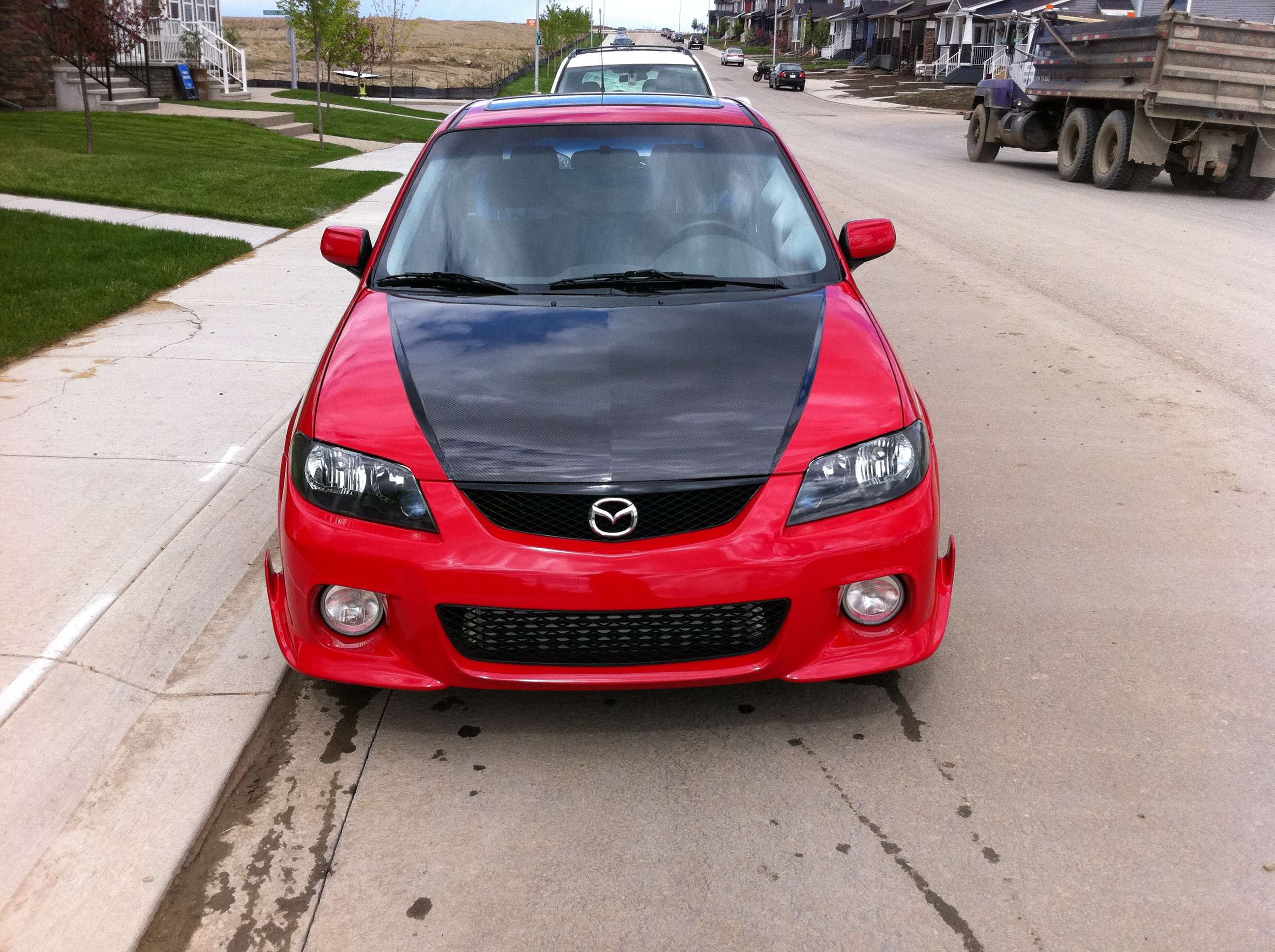

Washed the car and pulled it around front to snap some pics. Used my iPhone, but hope they satisfy the masses. Taken in front of the parent's new crib:
Is that an intercooler hiding in there?

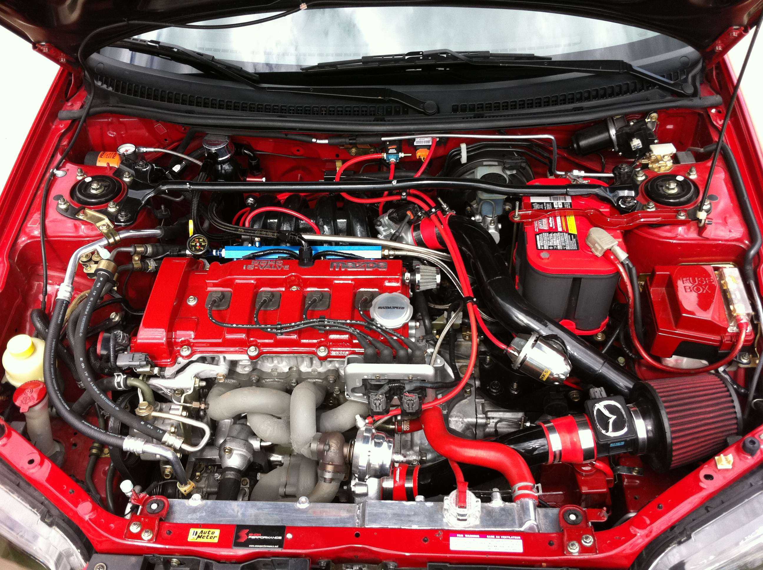

Engine bay:
