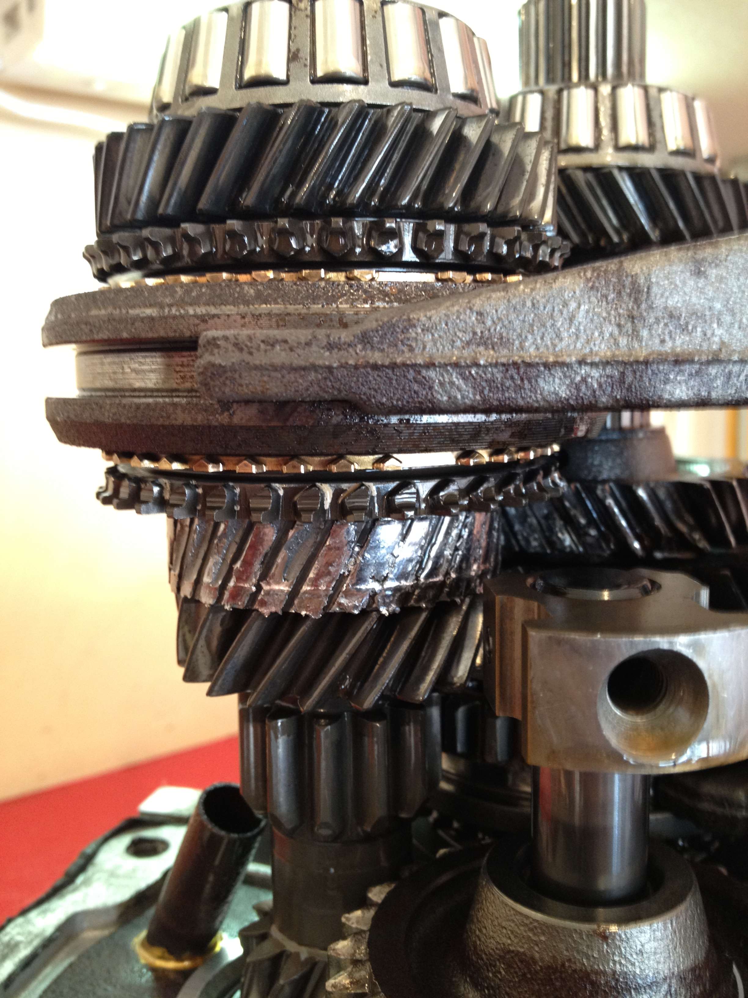

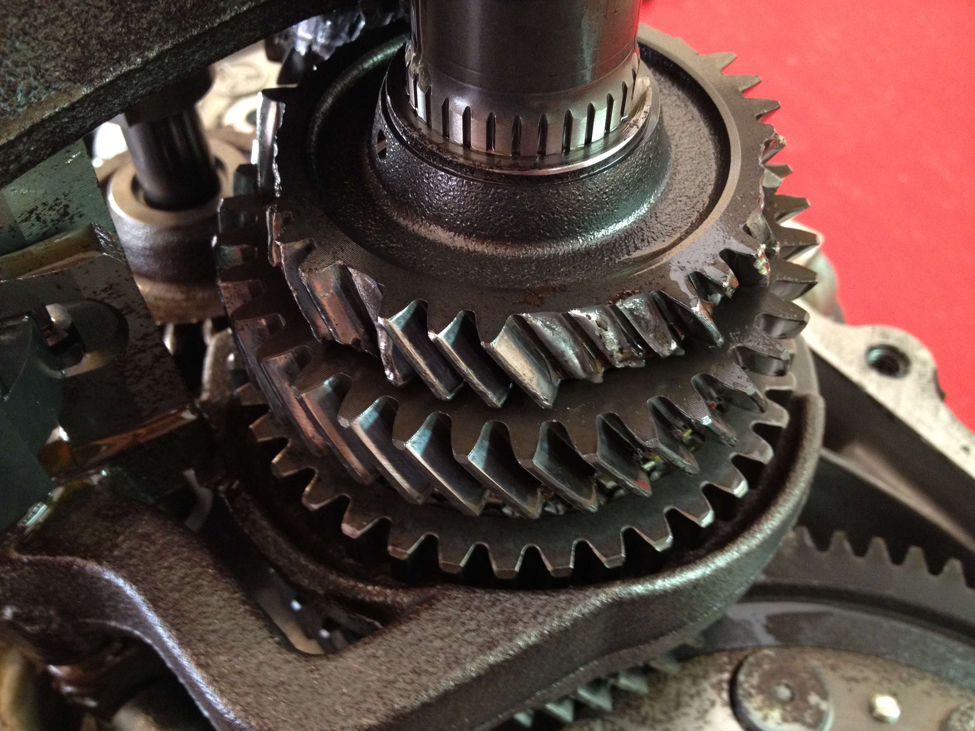

looks like you had transmission case flexing there Maxx.. why dont you contact Gerard Chan at Par and get them to make you racing Helical cut gears. they are as strong or stronger than Straight cut according to him. you just need to hold the input and output shafts together to prevent this problem.. my tranny and par racing helical gears are holding strong 26 psi of boost with our custome brace we have designed to prevent this problem. PAR cups are useless. i can privately send you the proper brace picture that really does it work preventing case flexing in that particular area holding together engaged the gears.
Now THAT looks like a viable alternative for once! I always shim my trans way on the tight side of spec to keep the shafts from pulling apart, but I suppose a brace like that is worth a try.
I've decided I don't want to run straight cut gears, now whether or not I run PAR helicals or something else is another story.
