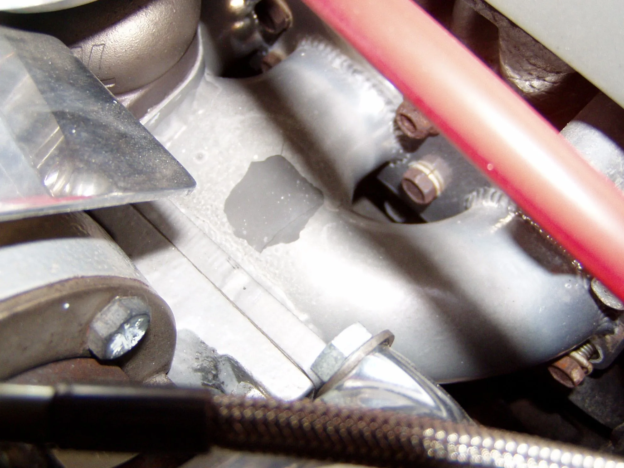

that coating is not suppose to flake off (mine has too) anyway beau said they would recoat it for free?? only problem is you'll have to wiat who knows how long?? oh, and mine actually cracked too!
wow... sounds like they only cured it to like 300degrees F >_>
it chips like that when you don't cure.
Ya mine came off in just about the exact same spot...
http://www.msprotege.com/forum/attachment.php?attachmentid=77131
That pic was when it was just a cracked/bubble. Now it's a big bare patch! I got all the same assurances from MAM CS about getting it recoated etc (even though I'm a 2nd party purchaser)... said they would let me know where to ship in the next day or two. That was 2 weeks ago and haven't heard anything since. **** it. I'll get it media blasted and powdercoated locally. At least I'll know where it is and that I can contact someone when I need to.

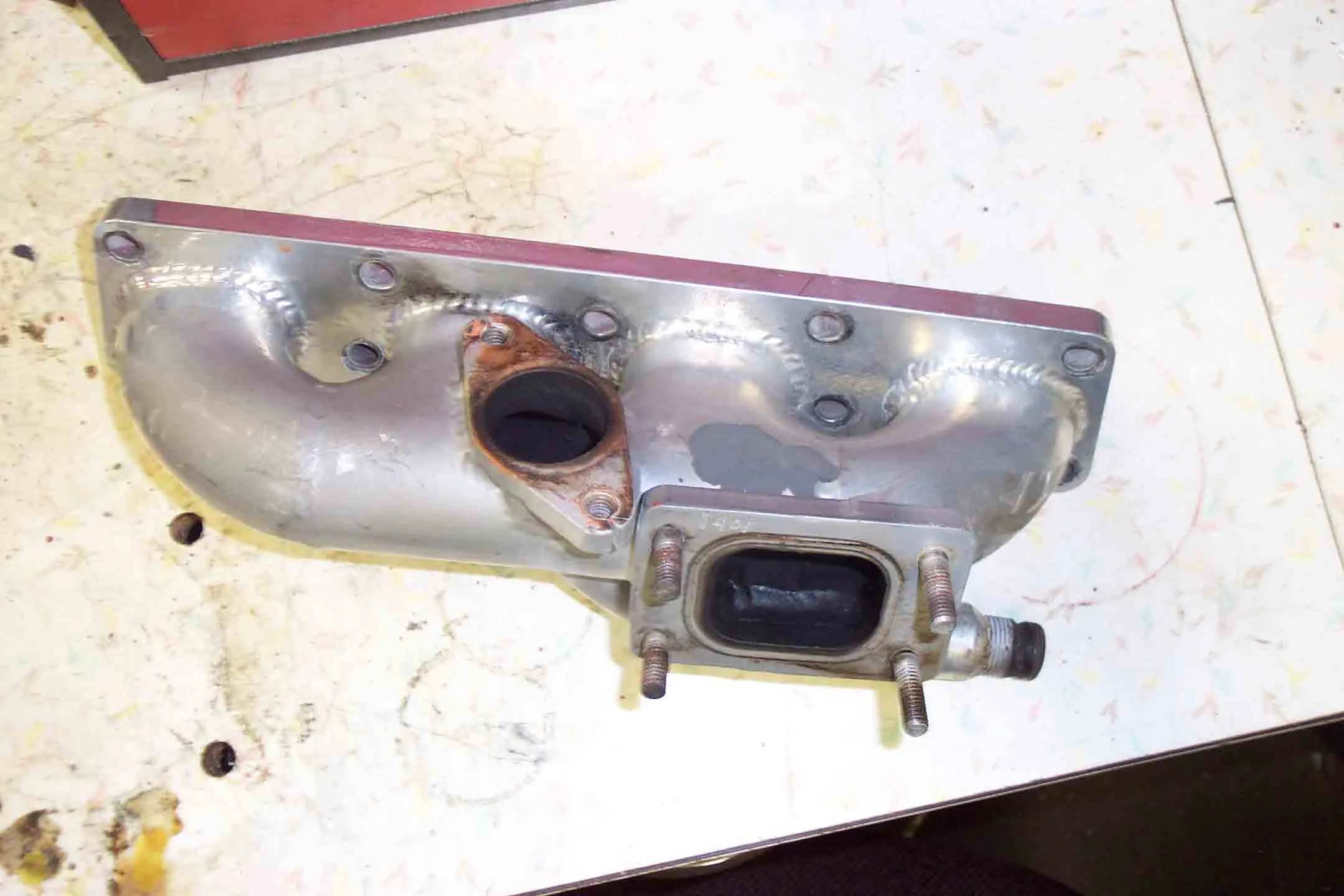

LinuxRacr said:
Mine flaked right there too, before I had it stripped.
So that's three. And all in the same spot! Wonder how many more there are out there.
The local powdercoating shop won't guarantee a high heat application like this so I'm still shopping around for alternatives. I really don't want to have to ship it half way across the continent to get it recoated... lol
Here's a current pic of mine.
