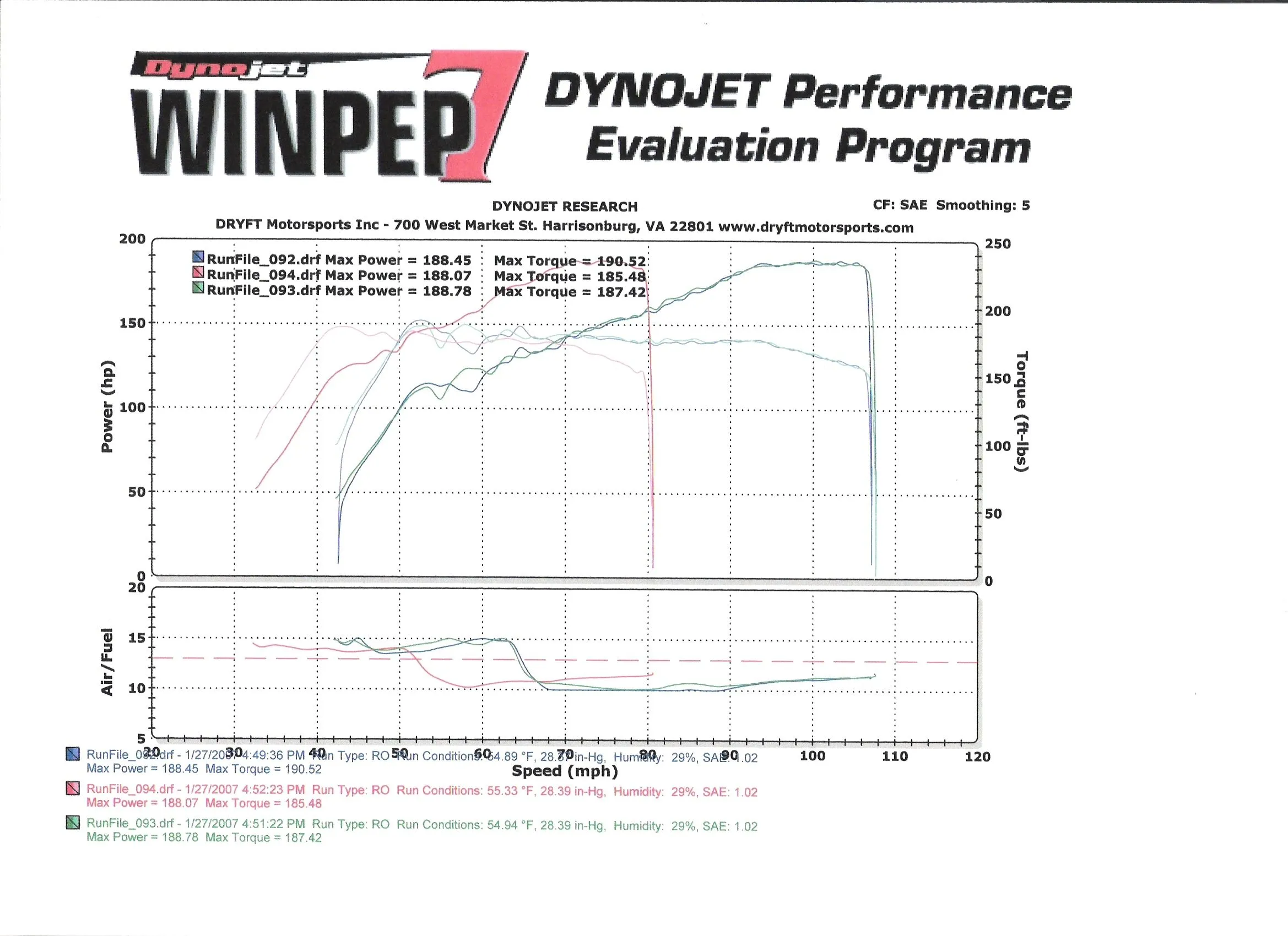

Alright, I know you have all been waiting for this... I went to a dyno yesterday with the rest of the local college car club (CCVT). The shop is run by one of the alumni and was pretty far away but it was quite worth it as you can see. Anyhow, the best run was 188.76whp and 187.42wtq although the first run made over 190 wtq. The first two runs were done in 4th whereas the last was done in 3rd but it didn't make much of a difference. All mods are listed in the sig (minus the "Completed" mods of course) and I am really impressed. I went into yesterday thinking maybe 160-165whp but this surpassed anything I could have imagined. The boost level is sitting at 7-8psi with an occasional creep to 9psi.
The funny thing about the curves is you can still see the 2.0L's characteristic peak tq at 3500RPM and peak hp at 6000 ROM as well as Mazda's pig-rich A/F ratios. I do like the fact that the tq curve is relatively constant.

very nice :)
edit: what engine management are you using? I don't remember. I know I run a lot richer than that on my MSP ecu (unflashed).. I hit 9.2ish when I hit full boost (shocked)

Kansei said:
very nice :)
Just saw the edit - I'm using the MSP ECU as well although I really don't know if it has been flashed or not so maybe that could be the difference? Aside from that possibility we have nearly the same setup minus a few small differences so I don't know what would cause you to run richer. Either way, I know my wideband lays flat at 10.0 aroun 4k RPM and stays there at full throttle.

Do you get any odd hesitation in 3rd gear? I'm not sure if my ECU is a flashed one or not. Even with a bigger turbo, I still run super rich at WOT. My AEM A/F sensor is pinned at 10 when I get on it.

From what I can tell I don't have any hesitation in any of the gears. I also really don't know if my ECU was flashed or not. Then again I can't really push the car right now because my clutch starts to slip at about 1/2 throttle in 3rd and 4th. I looked at the Vibrant though - it would be good if I didn't already have a j-pipe and a midpipe. Does anyone know if the Corksport exhaust attached at all the same points? If it does I'll probably go with that and weld in a flexpipe and a O2 bung and just go catless until I have to go to inspection and then just put my MAM back on. Either that or I could just use the latter two pieces of it...
Edit: Oh yeah, after about 4k RPM my wideband is pegged at 10. You can even see it in the dyno pics (they also had a wideband)
