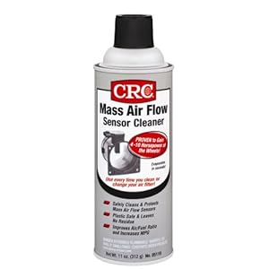

Do you have a CAI? If so, you may have just got your MAF dirty and/or wet. You could try (carefully) cleaning it with MAF cleaner... they sell it at any autoparts store for like $7. I would be very surprised if you have this issue with the stock airbox. If you're stock, and under warranty, they should fix it. If you have a CAI, and are under warranty, I'd swap that out for the stock airbox, or they'll most definitely tell you it was bc of the CAI, and NOT cover it.
Give this stuff a try..
I have used it on several cars and it seems to work well.

yeah i tried the can, resetting my ecu, and all the connections didn't seem to help. And I also have the CAI so I didnt even wanna try my warranty. I just bought the 250$ MAF at the dealer, car is back to normal. And please people this may happen to in the future, dont be cheap an buy an autozone re-manufactured one, they work fine but your car wont have any power lol
