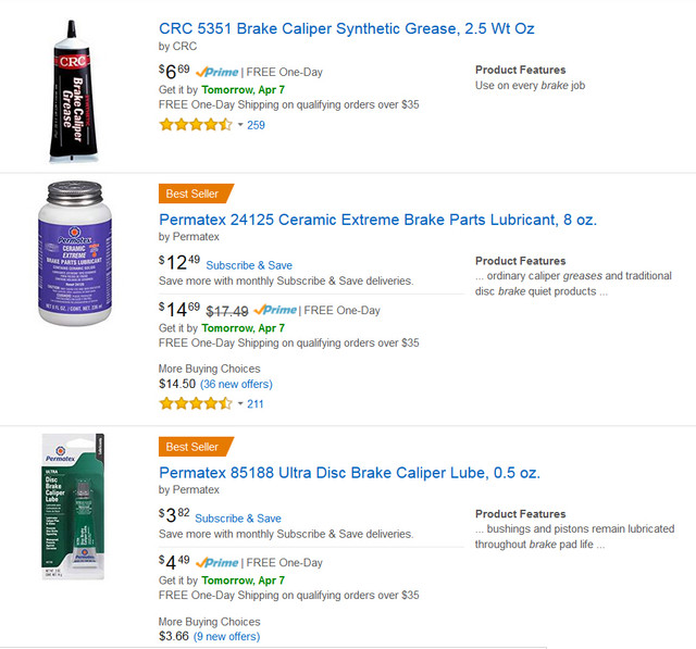

DO NOT USE ANY OF THESE PRODUCTS SHOWN BELOW for the caliper pin they will congeal or swell up the rubber boot bind up the sliding action or turn to dust at high temps (just use Sil-glyde and you will be fine),
these metal / ceramic based greases are for the back of the pads or those tiny ears on the pads only, not the pins.
the word "grease" is very confusing to newbies, you can;t just use one "grease" for all brake parts.

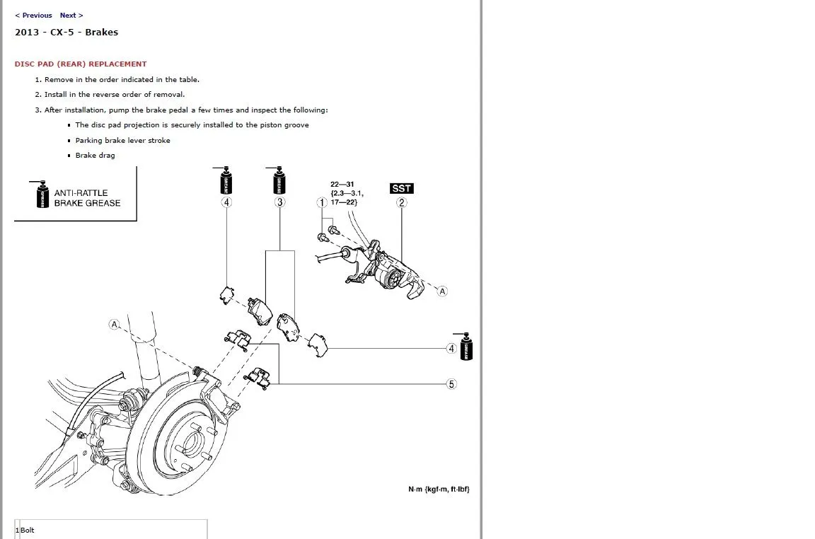

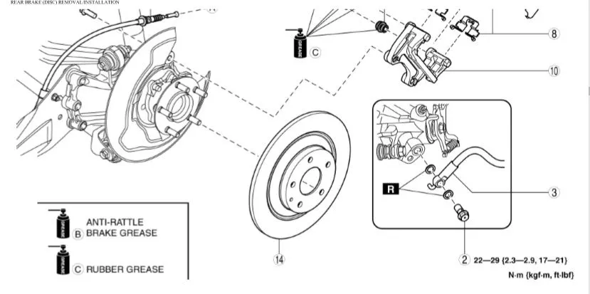

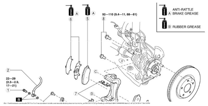

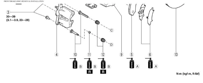

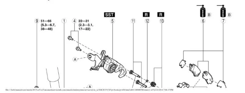

use whatever listed in the picture above for brake pads back and ears
