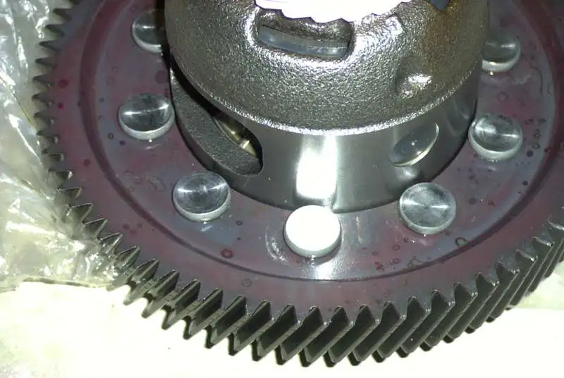

Well here is a pic of my diff. You can see the seam where the ring gear is a little off from the diff body. I'm going to have that gap between each of the "studs" welded so that the gear is fixed to that part of the body. that should prevent it from ever shearing the body off at all.
ddogg777-
The lsd is in 2 pics where the gear and the spool is shown
Its supposed to be attached to the center piece of the drive gear.
Damn, seeing this picture of the complete one, and then seeing the picture of the sheared one puts it into perspective. I may follow your lead on this one.
