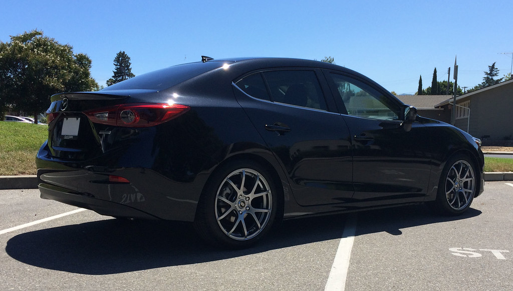

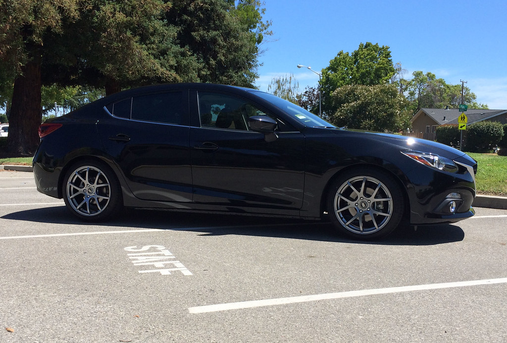

I surprised the wife by buying her a new car, her first question was....so when are your going to lower it?
Later that week....Eibach Springs/18" Hyper Black Enkei M52

What's the offset on your rims? +40? +50?
Debating if mine can be lowered with +40mm without rolling...
...and what are your thoughts about the ride/handling of the Eibachs, now that you and your wife have been driving it for a while? How does it compare to the stock suspension?
18x8 50mm, i went for a mild drop with eibach. if i went coil-overs or corksport springs i probably would've needed to roll fenders.
@concept....the only time i drove the car before lowering it was home from the dealership. the ride is much stiffer and handling is better, but it could use a stiffer rear sway bar and better struts and shocks for my taste. But it's fine for the wife as a daily driver. I got a new company car so traded in my 2010 Mazdaspeed3 since my wife doesn't drive a manual.
