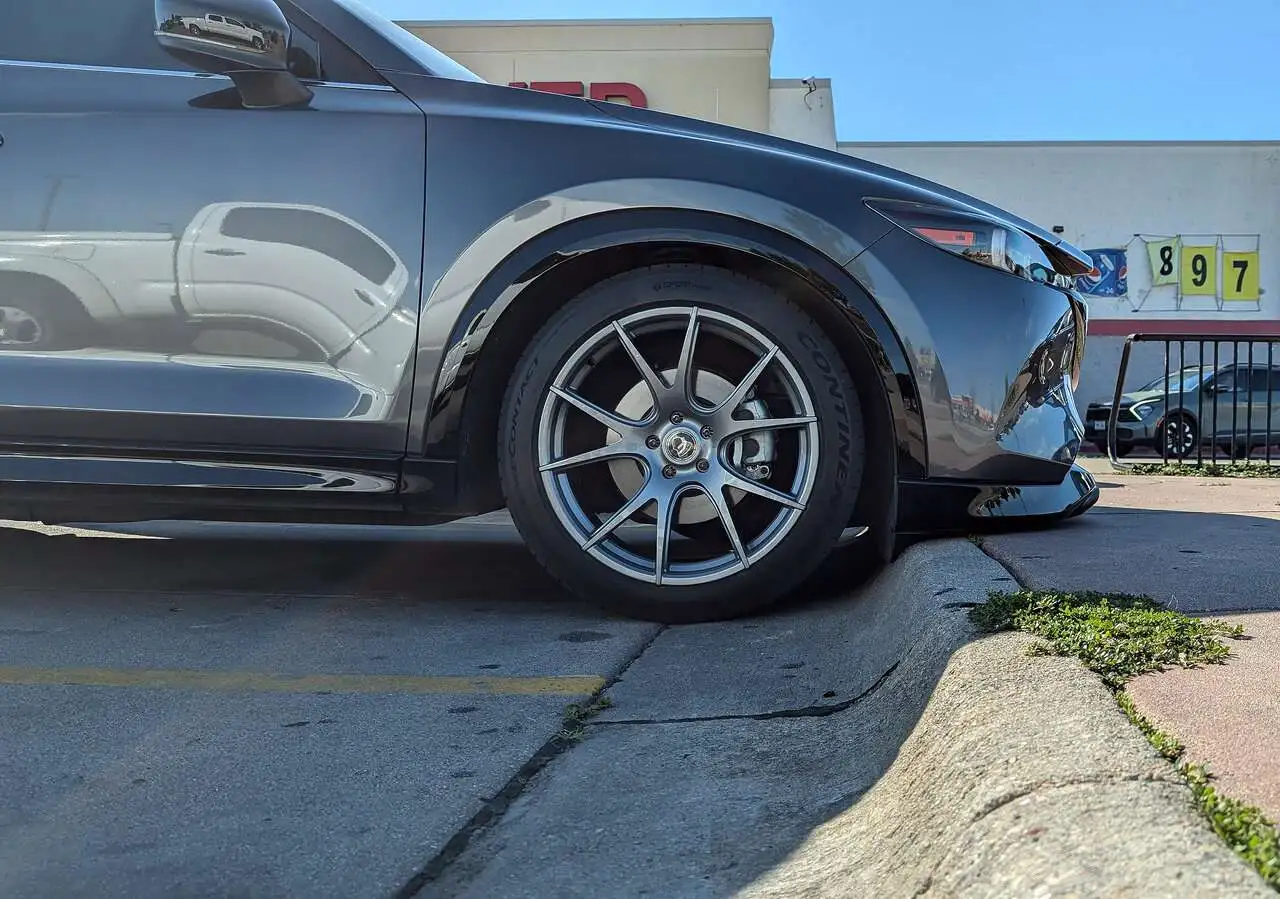

Here's a side profile showing the Corksport 2" drop.
I can see what @AL Cx5 is saying with wanting more in the rear. Corksport set their springs so that they would be level when an adult sits in the back or something of similar weight is loaded in the cargo area. Knowing they will come down when loaded, they could potentially sag in those cases. And since spring travel is already reduced quite a bit, I think this is a fair compromise.

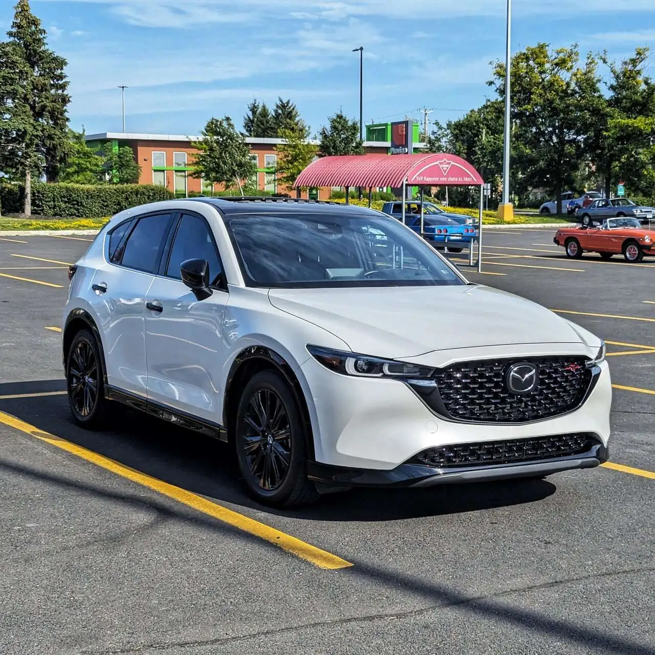

Nice looking! The larger diameter wheel fills the wheel wells nicely. My 24 T is almost a twin, same color paint and gun metal wheels. We stayed with 19" wheels.

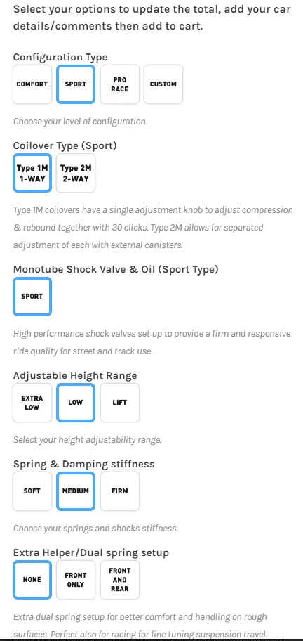

I installed the front BC Racing struts today on the front and test the parts before lowering.
The front ended up 1/2" lower than stock. The dampers have 30 settings. I set them 7 clicks firmer from zero.
My road tests confirmed the parts WORK. I started with five clicks but the car was porpoiseing so add 2 clicks.
The car passed the supreme test, "princess and the pea" test. My wife drove the car around town over rough roads and confirmed it road like stock.
My tests confirmed it rode nearly stock, with 20 pounds less unspung weight it was more responsive.
I'll install the rears in the next 5 days lower the ride about 1.75 to 1.5 inches...

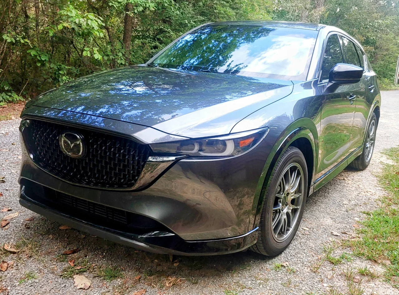

Here is our 2024 turbo we took last weekend to the mountains.
It's lowered 1.5" front and 1.75" rear with BC Racing RC coilovers, Megan front and rear sway bars, Prothan urethane sway bar bushings. 19" Enricii spun forged wheels. It still has factory A36 tires. Also changed out squeaking front brakes to high performance pads with drilled and slotted rotors.
We are in our 70s and not looking for a Tuner ride. These BC coil overs give us fine height adjustment and the ride quality we like. The car was a joy to drive on the twisty mountain roads and rock solid on the interstate highways.
I've made a few hard braking and turning to avoid an accident. This suspension setup is a dream under these conditions.
I installed all of the above parts. The front sway bar was the biggest challenge until I learned the trick.
This 2.5l turbo averaged 32.6 mpg over the weekend, including daily trips of less than 3 miles. Tuned Ecu and a few of my own engine mods. Not a hot rod. More like a sport mini SUV.
