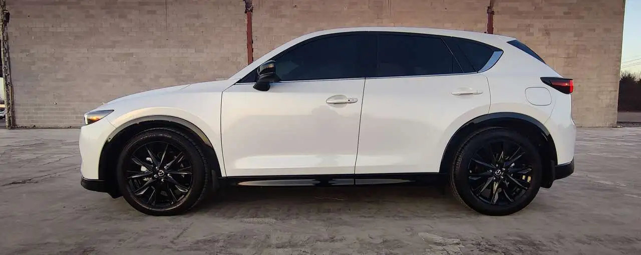

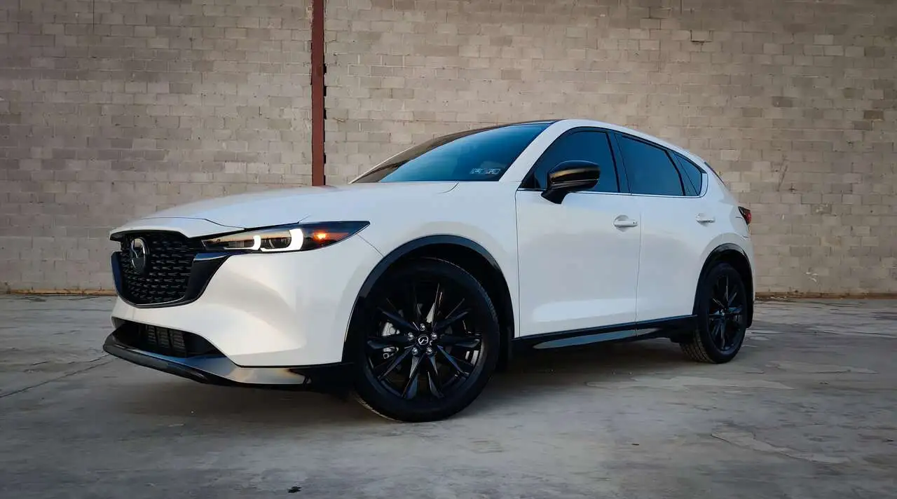

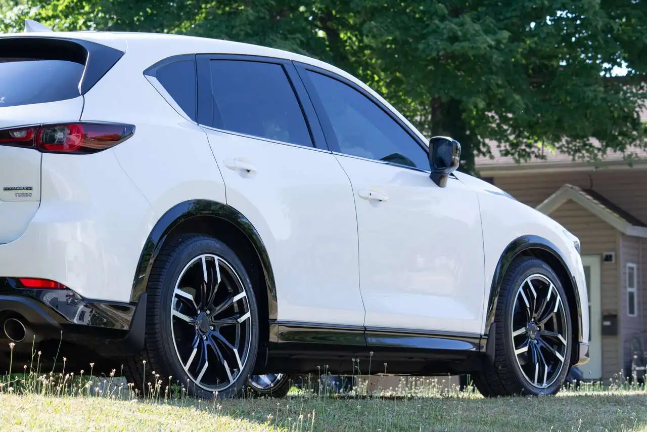

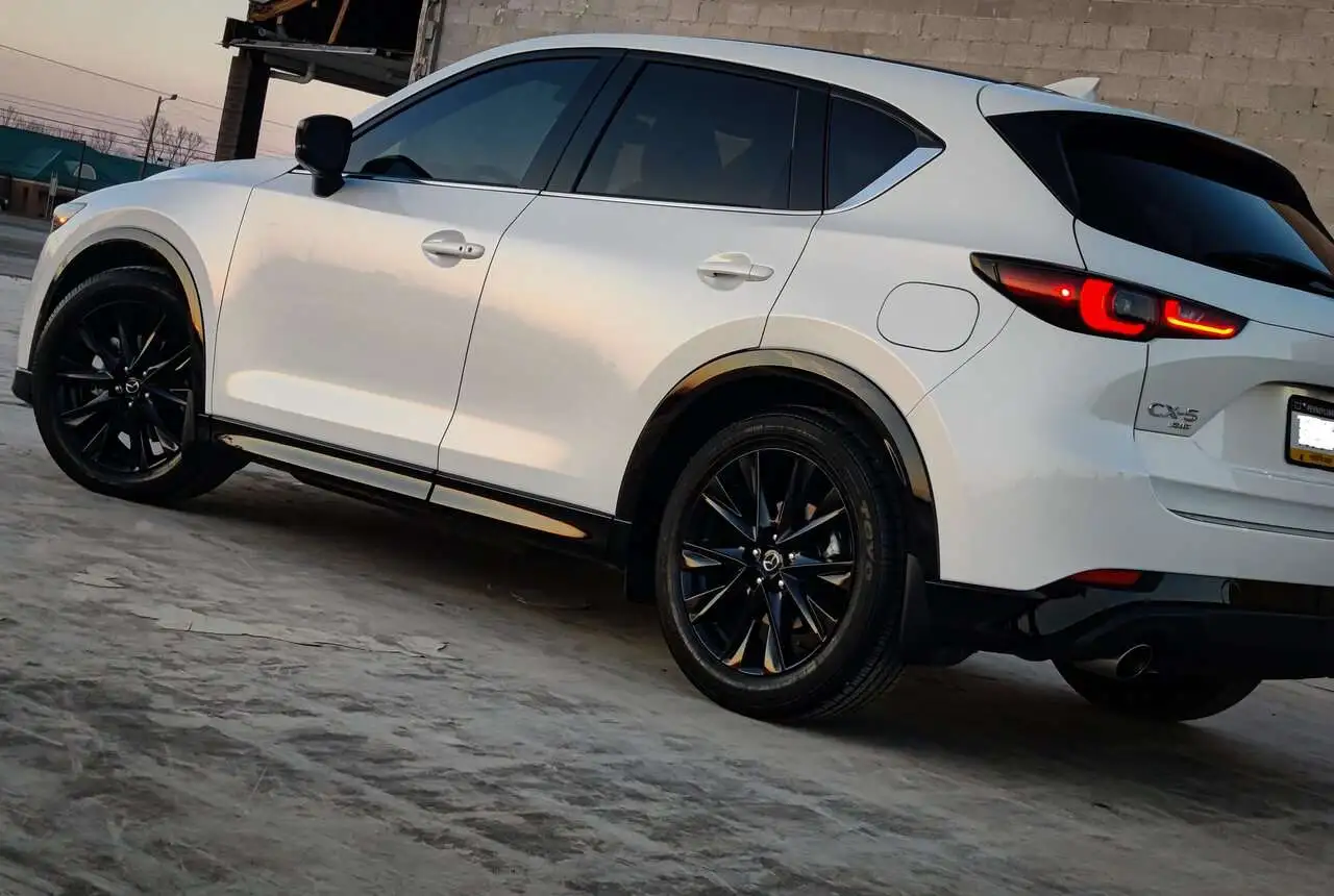

2024 Carbon Turbo dropped on CS springs. So fresh it hasn't even had its first oil change yet (2426 miles).
Other mods/upgrades: blacked out roof (PPF)
Full frontal clear PPF
Professionally applied ceramic coating
Full interior carbon fiber trim (real)

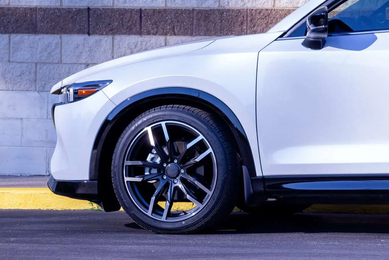

Upcoming: 20x8.5 245/45 DWS06s
possible rear spoiler, undecided
visors? idk. Tryna keep it clean and not ricey.

Looks really nice.
I have those tires waiting for my 20x9 wheels to arrive.

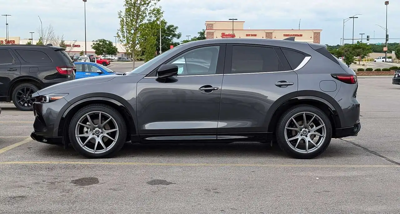

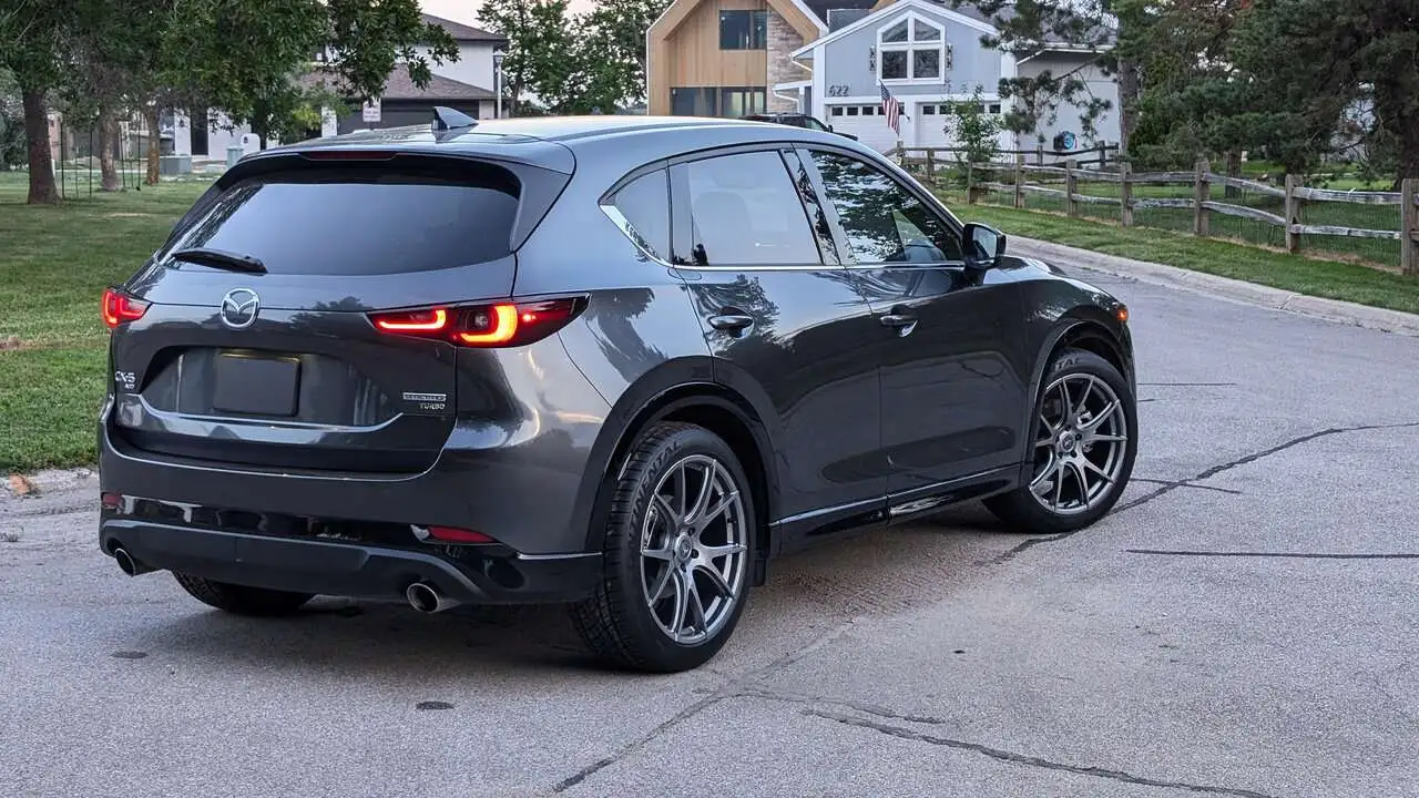

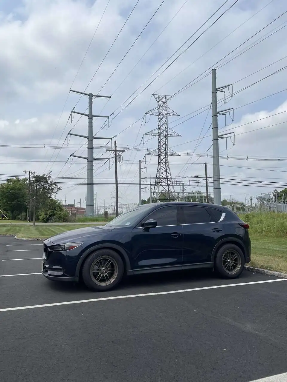

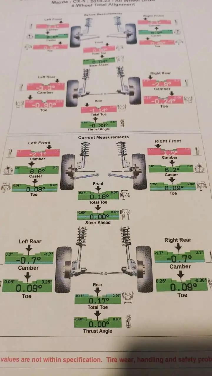

2024 Premium, Turbo, lowered front 2", rear 2.5" with BC Racing BR coilovers, Megan Racing front and rear ASBs, Maxspeed adjustable ASB end links, 4 front camber bolts, rear camber lower control arms.
Attached before and after alignment without front camber bolts. I've got it close after installing camber bolts but will get it dialed in on an alignment machine next week.
I have a set of gun metal wheels on order.
DRTuned turbo tune. Woke up this CX-5 and the suspension eats up the extra power.
Fun grocery getter..
EDIT: I removed the BC Racing BR coilovers over the weekend. After installing replacement dampers on the front, in about 30 miles the same noise returned. I removed the passenger side front strut looking for loose parts. I didn't find any. I set the spring tension per the YouTube video. Still rumbling over cracked pavement and rough road.
I put the OEM parts back on the car. No more front end noise.
I have at least 40 hours wrenching on this suspension. I'm giving BC Racing one more shot. They are sending a 2nd set of front dampers and mounting plate bearings. I hope this works...

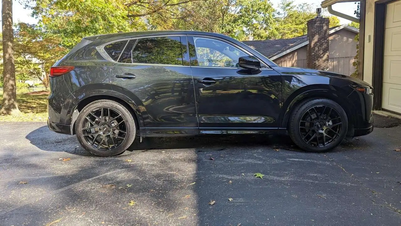

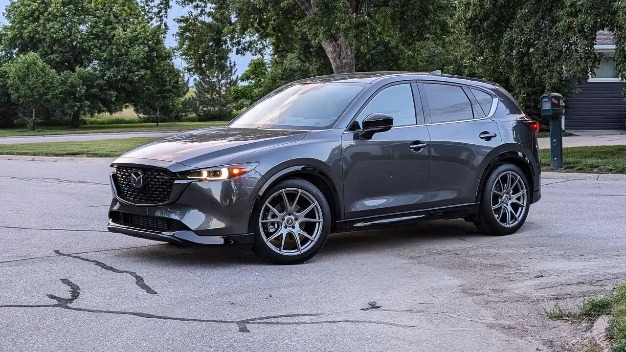

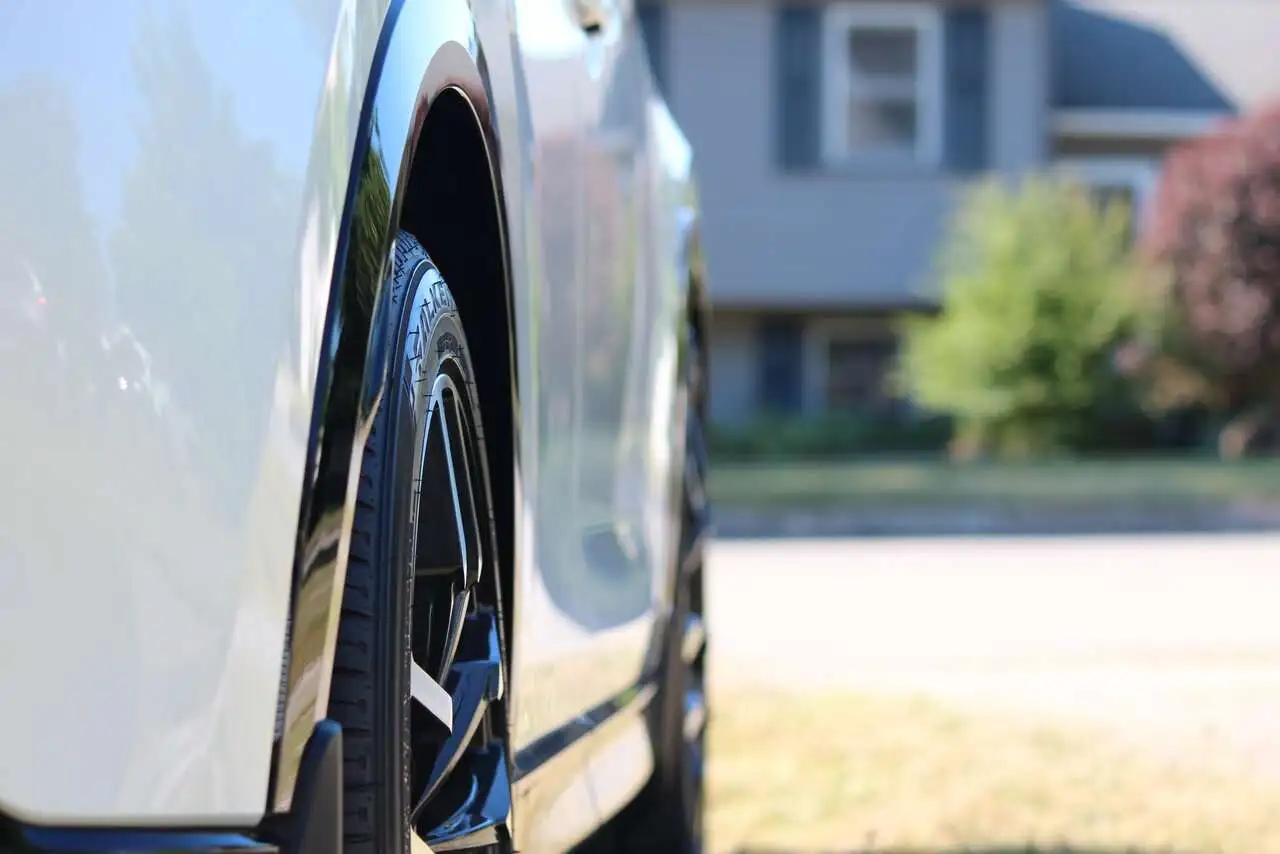

Here's a side profile showing the Corksport 2" drop.
I can see what @AL Cx5 is saying with wanting more in the rear. Corksport set their springs so that they would be level when an adult sits in the back or something of similar weight is loaded in the cargo area. Knowing they will come down when loaded, they could potentially sag in those cases. And since spring travel is already reduced quite a bit, I think this is a fair compromise.
