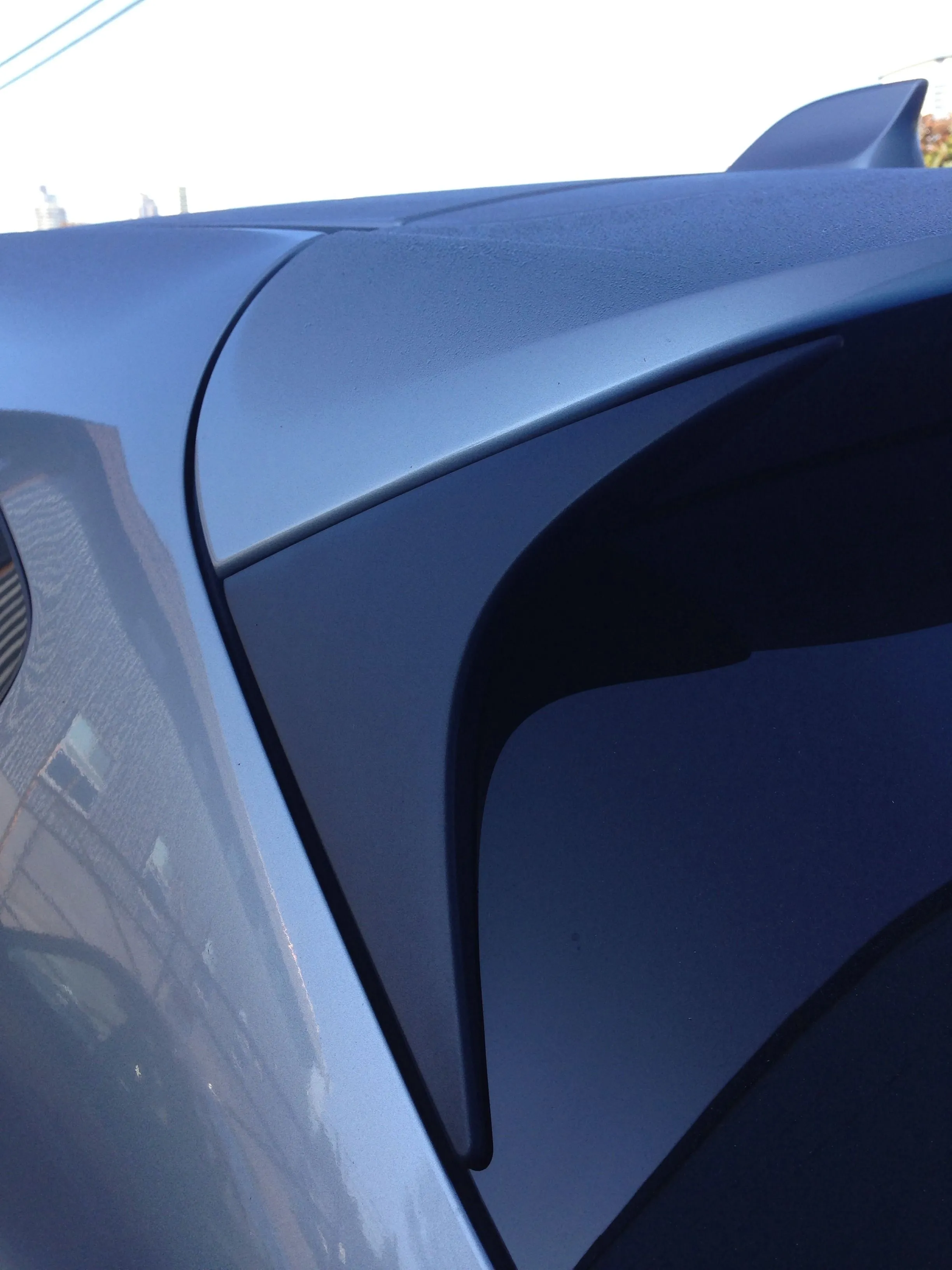

Hey guys, anyone have loose spoiler inserts on their rear hatch. If so how do you tighten them up. They rattle quite a bit..well atleast one does.

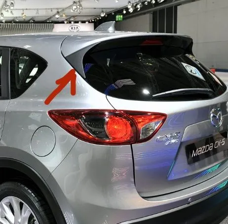

I posted something about those parts a few days ago but no one has replied. I also want to remove those.

To remove the insert you have to uninstall the whole rear spoiler to gain access to the bolts securing the plastic insert and the spoiler. hope this pics help .
Thanx for all the info. I havent heard of anyone else having this issue. I came across it while investigating a strange rattle coming from the tailgate area when hitting large cracks and potholes in the road. I think Driving on the crappy Jersey Highways may have shook em loose. I may wait until my first service to get it taken care of with a few other rattles. Thanx again.

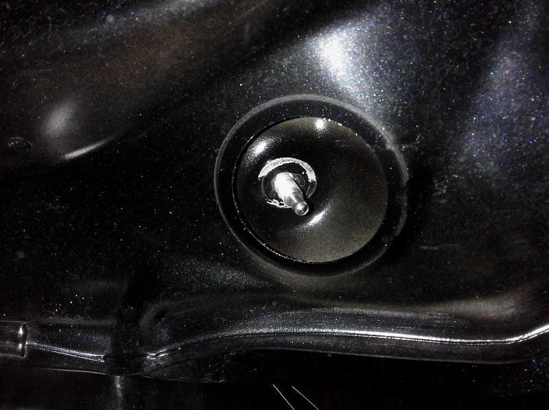

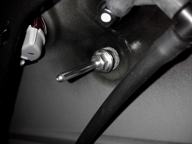

Bringing this thread back again. I've had the strange rattling in the rear since I bought mine last month. One day last week, as I was closing the hatch, I could hear something actually rolling around inside. I tore into it and found one of the 4 nuts had completely come off and another was about to!
Passenger side outer:
Passenger side inner holding on by about a thread and a half:
I feel like if Mazda had simply gone with a serrated flange nut, we wouldn't be discussing this. These are smooth on the bottom and don't really provide any bite. I took off all of them and reinstalled with a dab of blue Loctite on each of them. I took it for a ride and didn't hear anything, so hopefully that's all it was.
