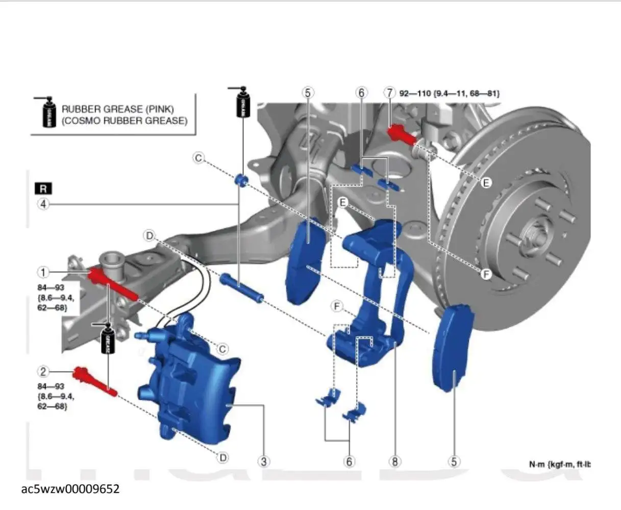

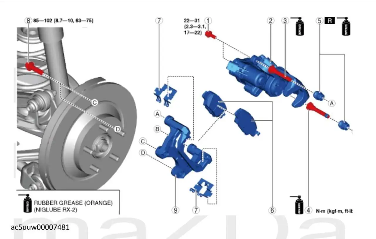

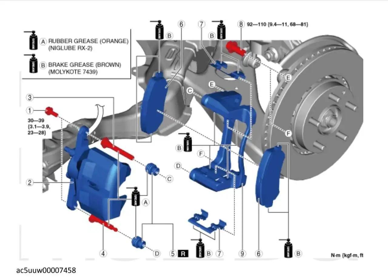

Here are the torque settings on caliper slide pins and caliper brackets for gen-2 CX-5. The first picture is for 2.5L NA with single-piston front brake caliper. The second picture is for 2.5T with larger dual-piston front brake caliper. The third picture is for rear brake caliper. Notice that the torque spec for caliper pins at front on the 2.5T is significantly higher than the 2.5L NA at 62~68 ft-lb.
And the workshop manual states the rubber grease needs to be used on the the caliper pins and the replacement of rubber boot on pins is required.

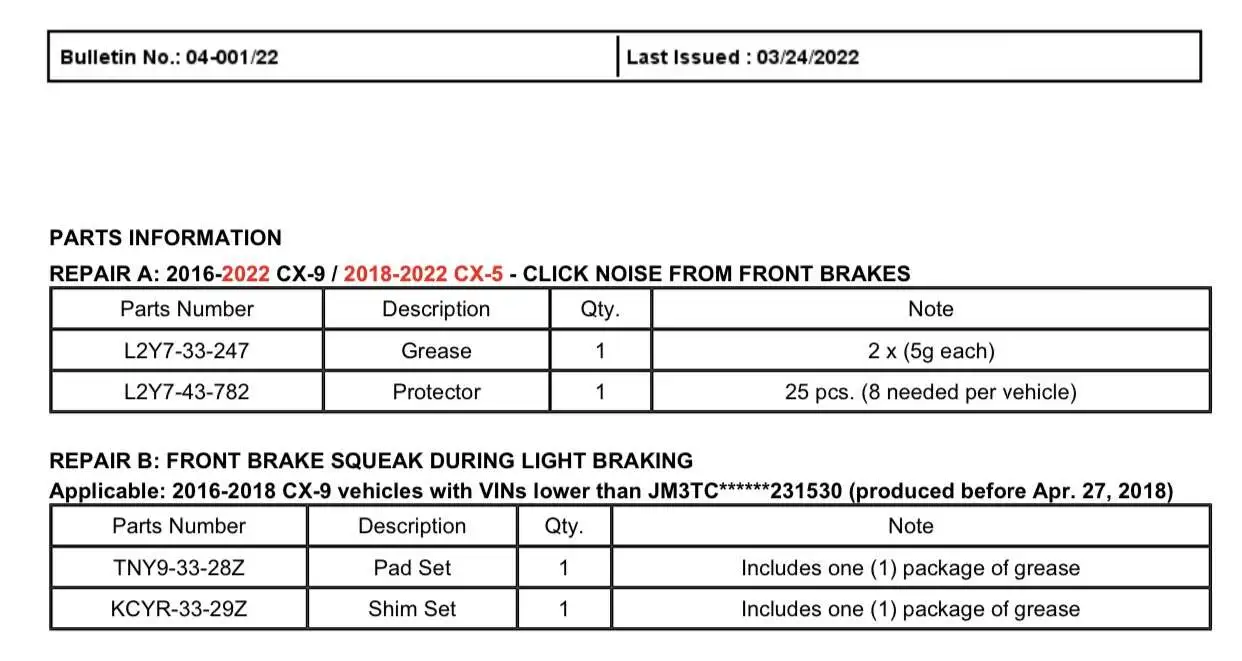

After I did some research on OEM front brake pads for the 2.5T, I found it’s really confusing. Based on the latest TSB 04-001/22, the current part number for 2.5T front pads should be TNY9-33-28Z (actually it’s now TNY9-33-28ZA), and the shim set is KCYR-33-29Z. Most Mazda OEM parts online sellers don’t list front brake pads for the CX-5 turbo, not even for the CX-9! The TSB did mention “For CX-5, only vehicles with the “PAD SUBSET, FRT CALIPER” TKY8-33-28Z, TAY0-33-28Z or KCYR-33-28Z applicable for the VIN are subject to this TSB.” This indicated Mazda has been using several different pads for the 2.5T. And this means the TNY9-33-28ZA pads don’t need that expensive “protector”.
I’d call the parts department at my Mazda dealer giving my VIN, and see what is the most current part numbers for pad set and shim set.
As for where are these made on Mazda OEM pads, I know most of them (not the “Value Line” pads) including those for 2.5L NA are made in Japan. As for TNY9-33-28Z pads for turbo, it’s hard to tell.
Searches on a couple of Mazda parts online sales using the vin only come up with the TKY83328ZB for a 2019 CX5 GTR.
I believe the TNY9-33-28ZA applies to the 2016-2018 CX9 in this tsb. It is a little confusing
I do have the click from the pad moving in the caliper when changing direction which appears to be a CX5 issue by the tsb.
