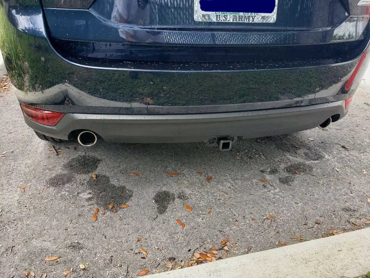

Bought the flat black curt hitch on etrailer for $150 and paid mechanic $80 to install it...no wiring setup...was still about same as or cheaper than uhaul. Call you mechanic and get pricing.
Its now $162 for the etrailer matte black with hardware. Its really a Curt hitch branded for etrailer.

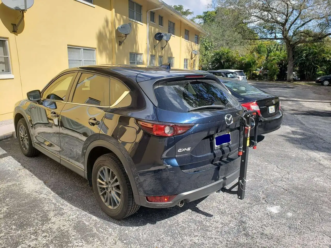

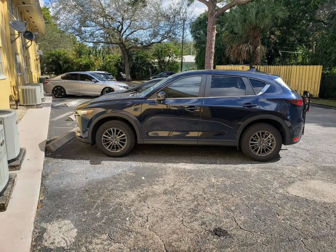

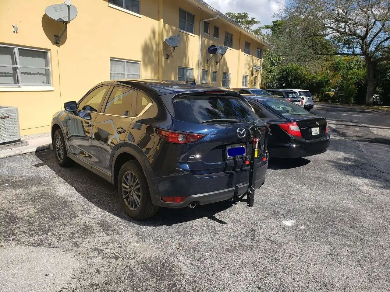

I went with the Etrailer matt black as well. My brother in law helped me install it. Easy enough but definitely easier with another set of hands. It's been on for a little over a year with no problems. I'm using a Kuat Sherpa 2.0 2-bike rack. Very easy to put on & take off. My local bike shop price matched an online deal & I got it for 20% off. I also got a 2"wall mount from Amazon that I use to store the bike rack when I'm not using it.
Nice rack. Pricey but has nice features. That tilt away from the car is nice.

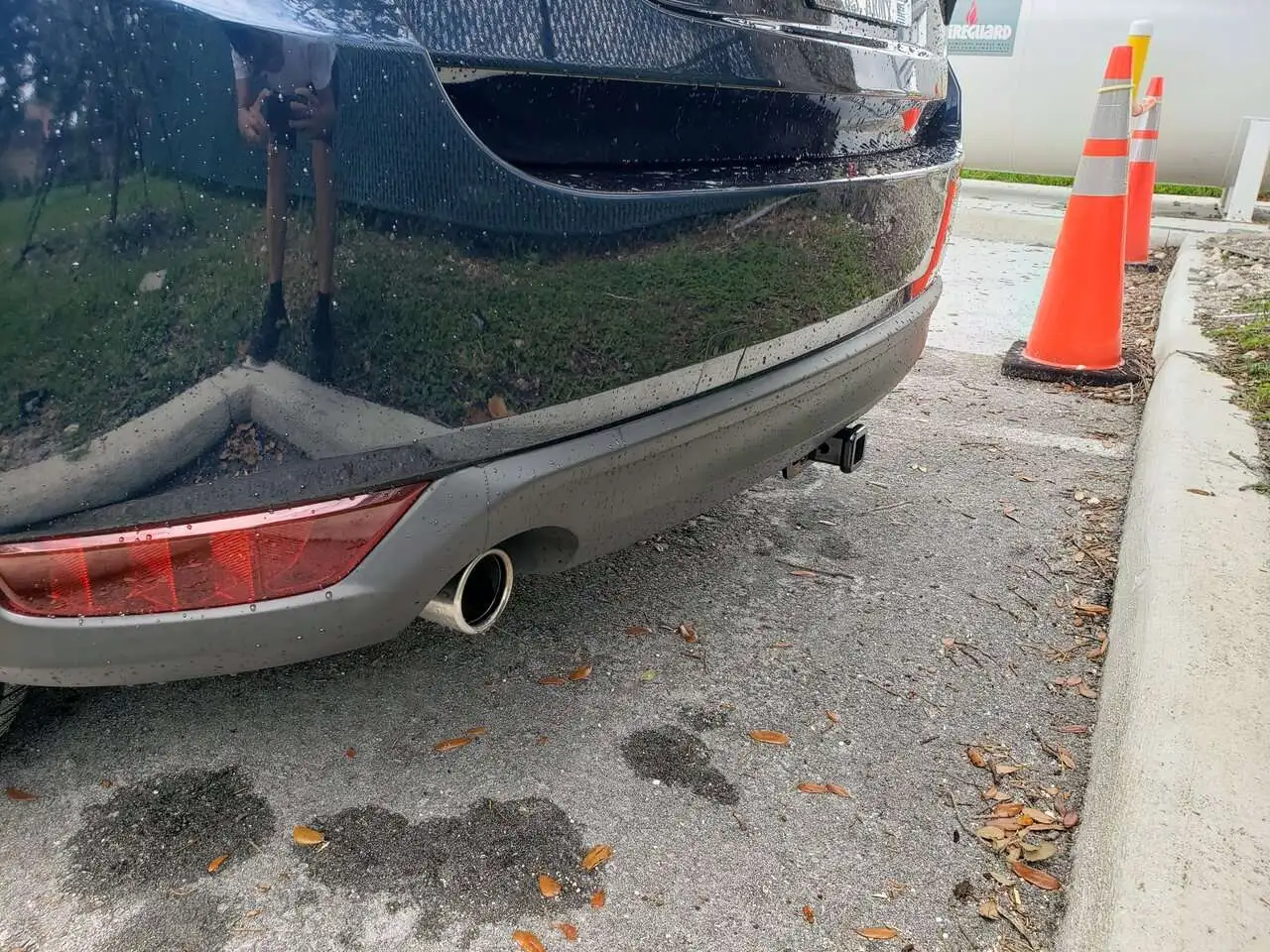

Hmmm. My etrailer/Curt hitch is a 2" hitch and right almost flush with the bottom of the bumper and hasn't scraped yet and not hauling any boats with the CX. Imo, the CX already has lousy ground clearance for the hitch heigth to even matter.

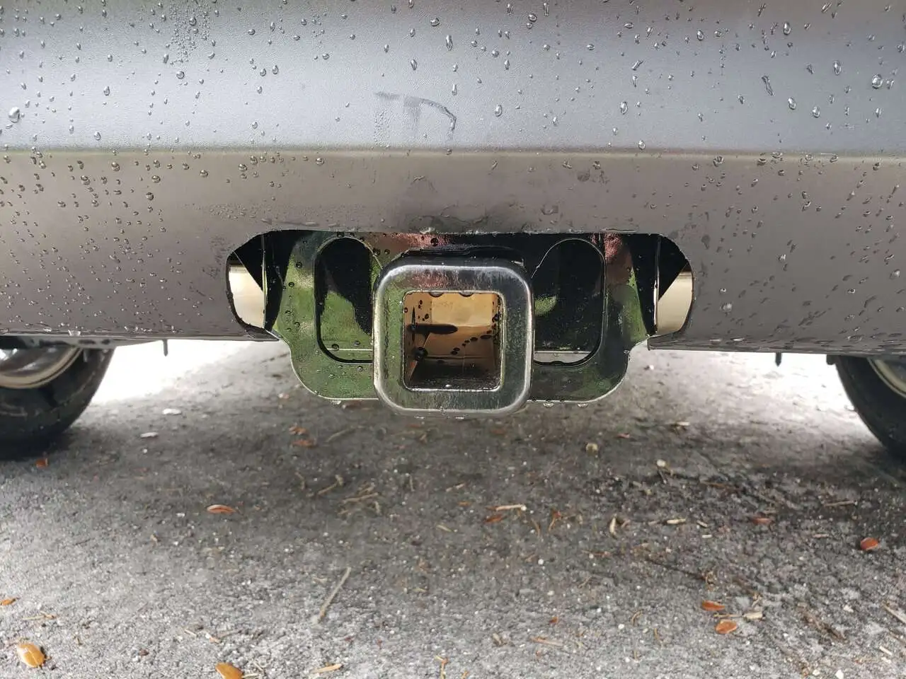

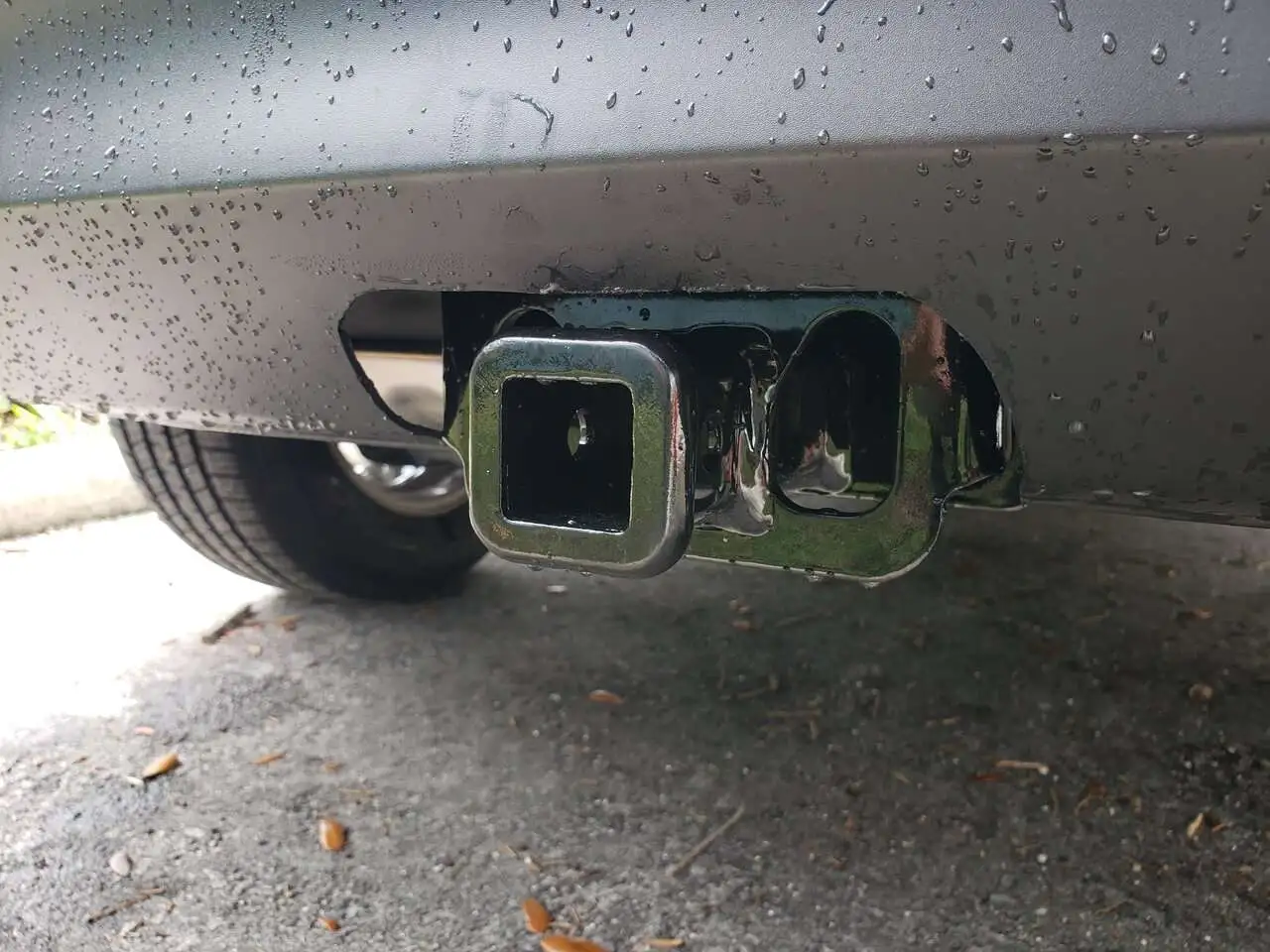

Just curious, I didnt see any plastic pop out cover on the bumper...
Did/do you need to cut out the bumper for the mazda OEM hitches?
Another reason I went with etrailer Curt hitch was it was only $150 while the OEM was over $300 when I looked at them. For anyone considering price, thats a big difference.
From what I've seen, Yes, you do need to cut the plastic bumper for the OEM Mazda hitch. There is no pop out cover on the bumper. There is another thread somewhere on this forum in which someone posted pictures of a horrendous hack job the installer (I believe at a Mazda dealer) did while cutting the bumper cover during an install of the OEM Mazda hitch.
FWIW, I also have the Etrailer 2" hitch and have not scrapped mine either in over a year.

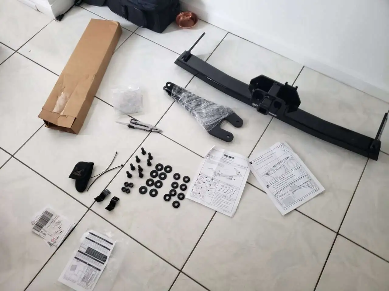

Yes, it is more expensive, and you have to cut the bumper.
It does brings a diagram to do the cut out
