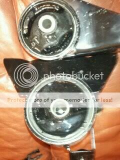

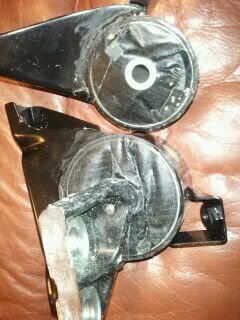

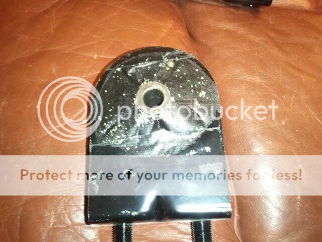

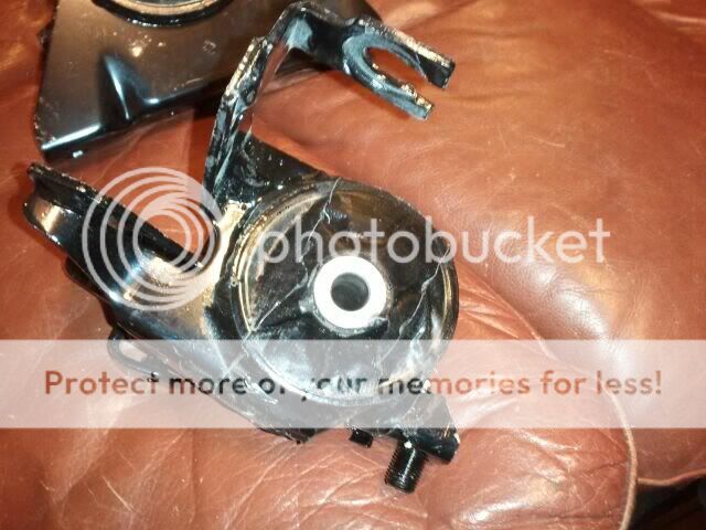

So I finally got around to filling my new stock mounts. It was 129 for all 4 mounts, and 27.99+ shipping for the liquid urethane.
Tape 1 side of the motor mount, seal with some rubber cement. Set all mounts in a box filled with sand or cat litter to catch whatever drips off or through the duct tape.
Make the fix, then fill em up.
These 2 ended up not being full when I went to ck on em, had to order another kit to refill
These 2 came out great.

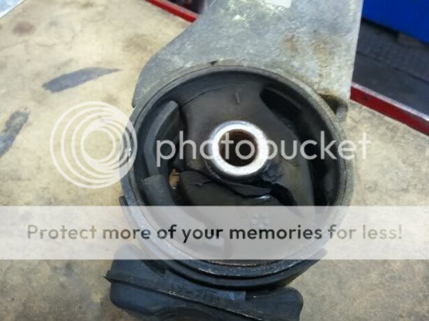

I have done this before. I hope that you cut out some of the rubber "separating" the two sides before pouring. or you may find that the urethane pops out after a while
I got off ebay, they are some knock off ones. The fill is rated at 80a durometer. Cut what out? I didnt cut anything.

Put the mounts in today, took about 1hr 30 for all 4 mounts. The back 1 wasnt as much of a PIA as everyone said it was. The mounts seem solid for now, a bit more vibration then I had, it wasnt to smooth since I got it. The old mounts were destroyed.
