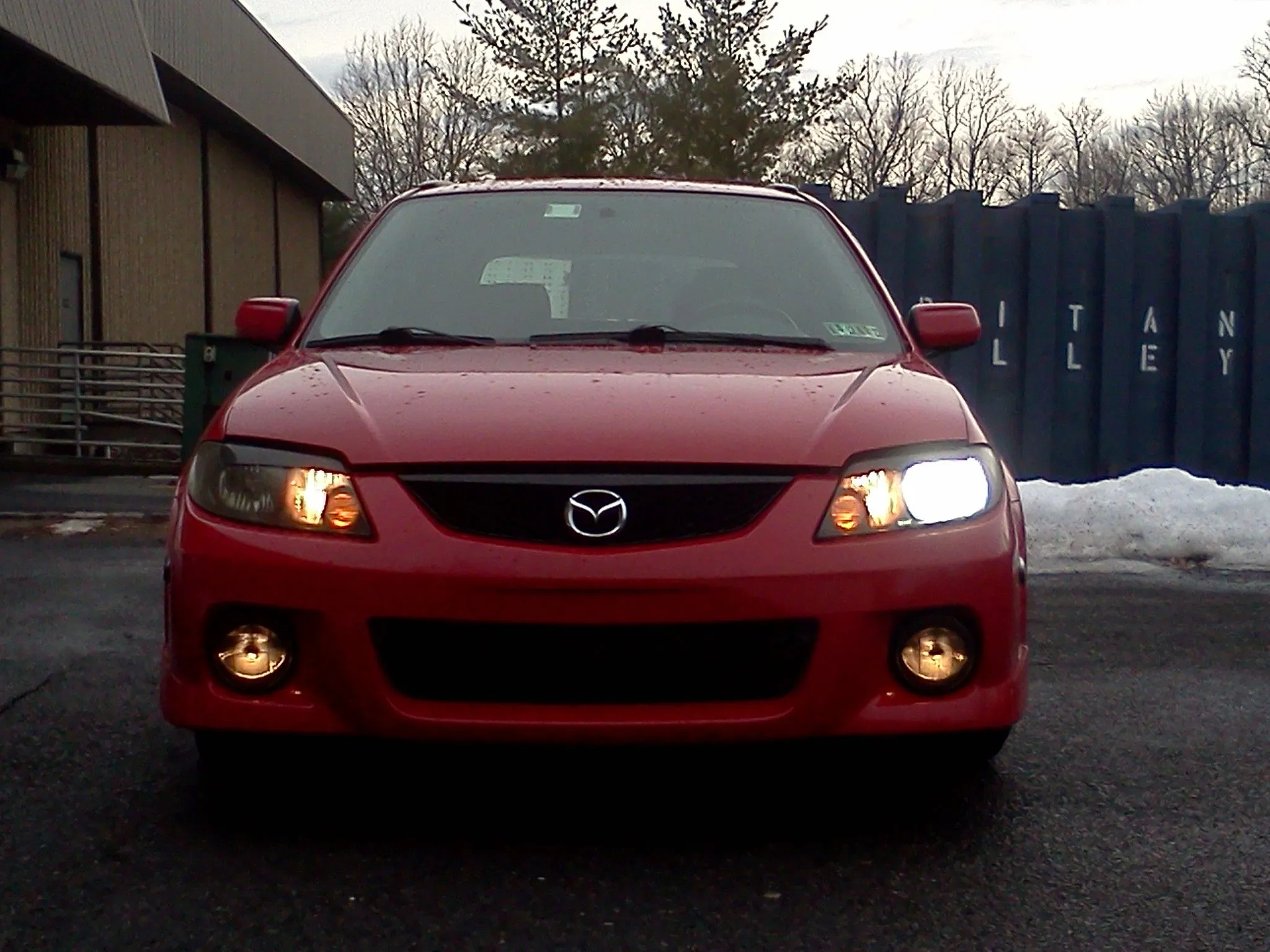

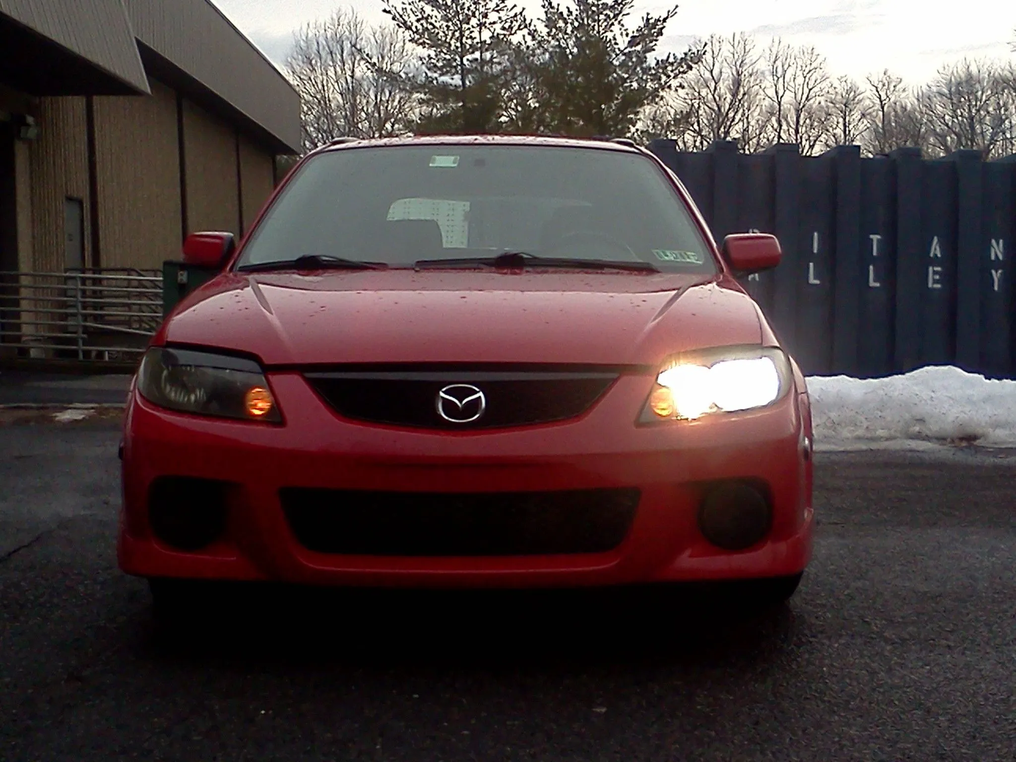

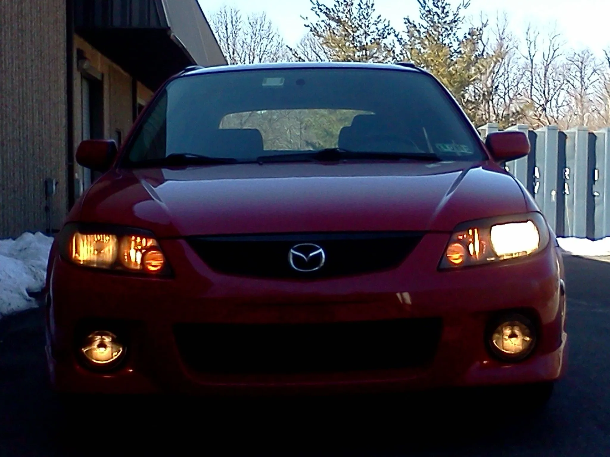

Have you checked your stock connectors? Sounds like a similar issue I had a few years back. Turned out the connector had some corrosion, got it cleaned up and it's been working fine since. This is what mine looked like.

That first photo is more of what mine looks like (albeit on the other side) when i have my high beams on.

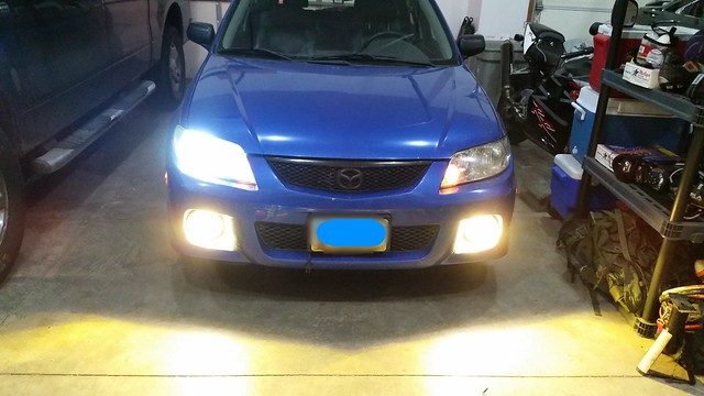

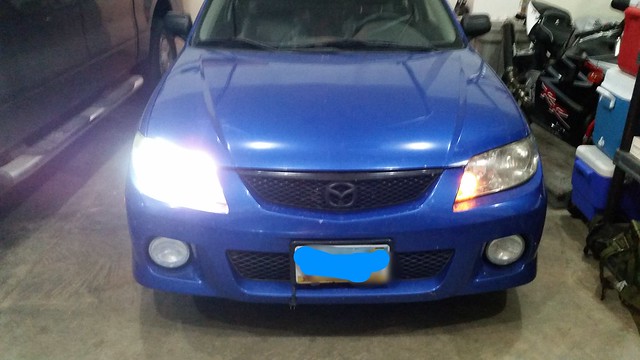

Pics of the problem: First is low+fogs, second is high's (hard to tell as phone camera is average at best, plus HID's are bright lol).
