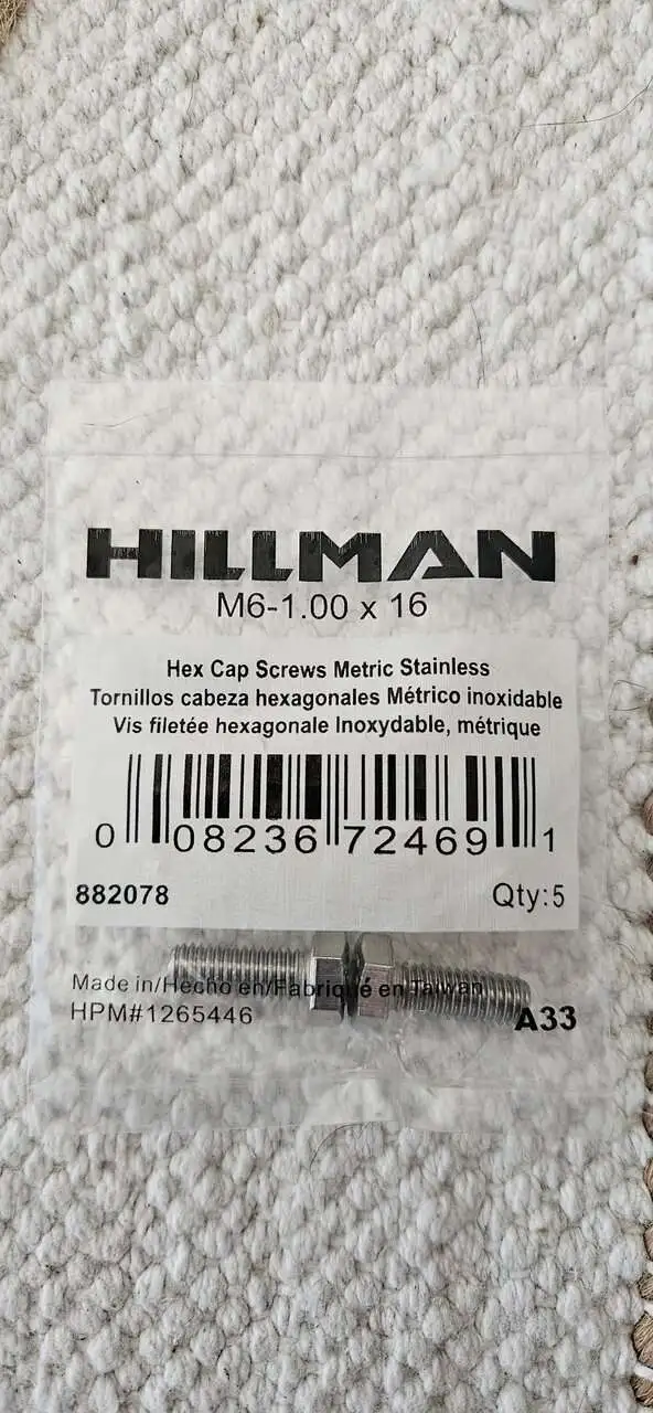

Hello. Brand spanking new Mazda owner after too many years to remember a Toyota owner. So, here we go... At the dealership, ink is hardly dry on the documents and the "sales assistant" is trying to put my transferred license plate on with the incorrect thread size phillips head screws she found who knows where. Anyone know the correct thread size for the license plate holder holes? Thanks in advance. Regards, Leon Geiser.

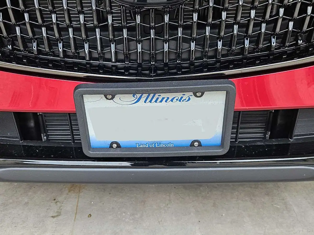

Since I have to have a front plate (and here in Chicago I have been pulled over for no front plate in the past) I use one of those WeatherTech plate bumpers on the front to at least get some useful function out of it. But that stupid Mazda plate holder just has the two slots on the bottom instead of screw holes so you can't even mount a plate frame properly on it. I ended up having to Dremel off the slots and picked up a universal plate holder from Amazon, mounted that to the frame, then the plate and bumper to that. It's a little more obtrusive but at least it helps protect the front end a bit from the park by Braille idiots.
Here's a pic if anyone cares. And yep the bumper is upside down in the pic but I took it before I noticed that little error and flipped it.

Sounds like they're an M6, 1MM pitch, M6x1, length of 14 - 20mm.
Lowes/Home Depot/Ace Hardware/... would likely have them, else online at Amazon and other places.
Perfect! After some wire brushing and carefully re-threading I was able to run the threads in clean up to the head. It's a good man that knows his nuts, lol... thanks for the info;)
