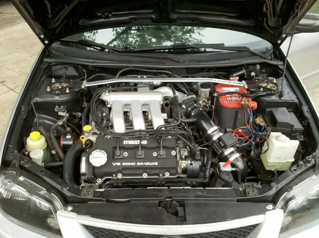

Gates timing belt, TB tensioner, water pump and belts, Fel-Pro valve cover gaskets and IM gaskets ordered. Should be able to button up the motor and make her look all purty this weekend. :)
It will be the same as my old KL. I liked the OEM look of it. But this one's engine bay will be much cleaner. I'm actually excited to work on the wiring harness and run all the sensor wiring and HID wiring in main harness and make everything super clean.

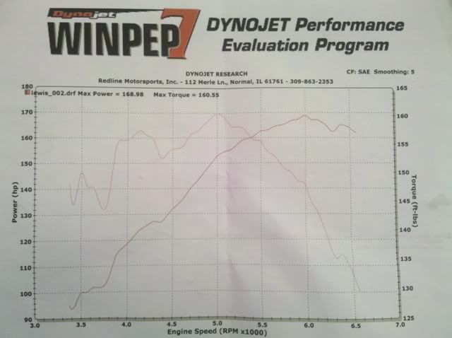

I had 169whp and 160lbs of torque on a Dynojet with the JDM KLDE (rated at 170chp).
I don't see that as bashing. We all know the FS is probably one of the most under engineered motors for boost lol. 60lbs is like the weight of the ac compressor on the FS (lol JK)
