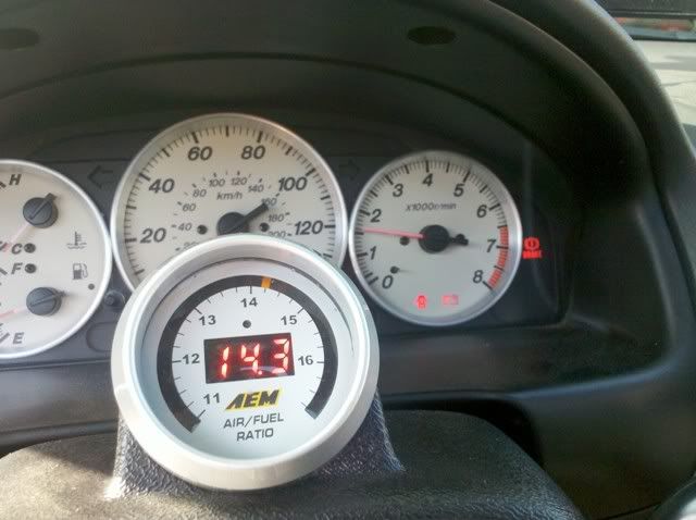

Sweeeeeeet. Speedo and tach works. You were right, Justin, wiring up the Dakota tach converter was pretty simple. Even I could handle it all on my own. heh-heh. And the speedometer works just fine. I've got an ABS light on probably for that pass/front ABS sesnor I snipped but that's okay. I didn't want ABS anyway, just a working speedo. So I'll just pull the bulb.
