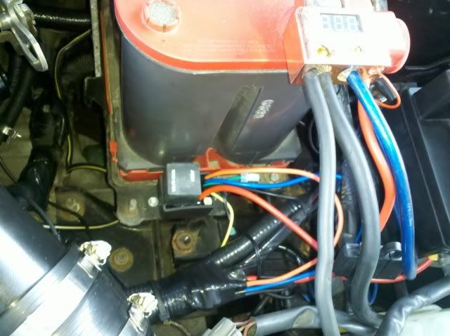

Today was a good day. Wes and I ran to Pull-a-Part and I snagged a vacuum line with the check valve from an FS 626. I'll have to try to rig up a system to get the hose to reach, it's still too short. But it was a $0.77 part so they gave it to me for free. heh-heh. Then we stopped at Autozone and I got the fan relay and got that all mounted. It took about 4-5 hours to do since I work at turtle speed. Then Wes and I took it for a ride around the block. The tach wasn't set quite right so we finally got it on the right setting. I was short shifting pretty early using the tach. After we got the tach sorted out I did a 2nd gear pull to 5.5k rpm and it was very fun. :)
I mounted the fan relay next to the battery.
I tried to install it as cleanly as possible but it still looks pretty messy. I've got some wire loom I'll try out tomorrow.

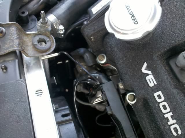

The temp probe just kinda slides into the fins and chills there. I was to put some zipties on each end or something so there's no chance it can wiggle out.

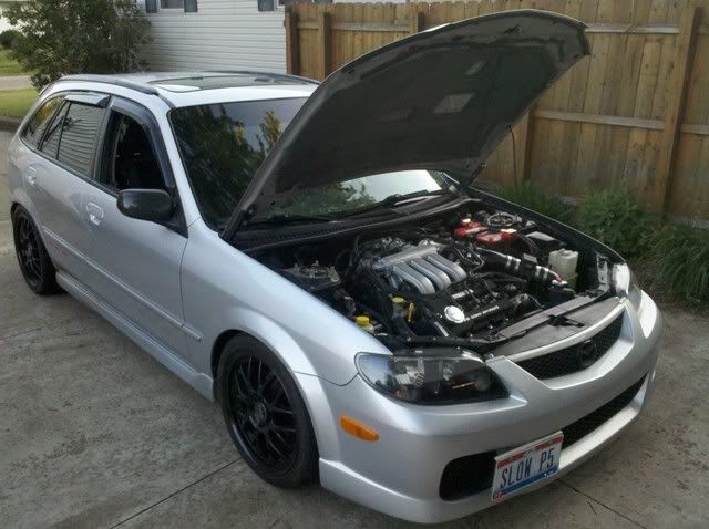

I still gotta do some cleaning up and tuck/snip some more wiring and wire up my HID's again. But it's very fun and sounds wonderful.

Dude, that's like the understatement of the century. This thing freaking rips. I have no other way to describe it, it revs like a bike, it pulls insane, and it sounds absolutely down right nasty. After 4k it gets this really high strung rasp in the exhaust, and holy cow, it's just a blast. That, with the coilovers, the rear sway (all equal no body roll), the awesome tires, the straight through exhaust, the super stiff mounts, the Evo seats and now the KL, it's easily one of the most fun driving (passenger) experiences I've had. I was giggling like a 12 year old girl the entire time. I'll bring my video cam after everything gets buttoned up and pretty, and I'll try to make a vid that does it justice... which is a tall order.
