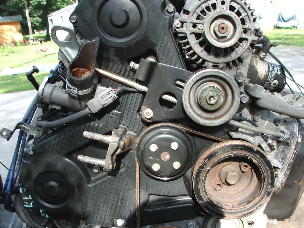

It looks like the passenger motor mount bolts are a lot longer than the ZE counterpart. My Protege MM won't tighten down onto the engine side of the bolts, if that makes sense. I supposed I could fab up some metal bushings or use a die to thread them down but Josh is going to check out the bolts on his broken FS-DE and maybe I can swap them out. Of course I'll have to take the belts off, timing cover and all that jazz to get to the bolts but it could be worse. At least I spotted in now instead of Saturday when the motor is supposed to be in.
Here's what I'm talking about. My "Milly" motor bolts are super long and not threaded all the way down.

Crappy, yeah my bolt lengths are perfect for the protege mount. Almost identical to the FP and im sure the FS. These are little bits of info I am gathering for the website (which i am still working on, taking forever with my busy schedule and preparations for the meets/shows this year on top of finding a house).

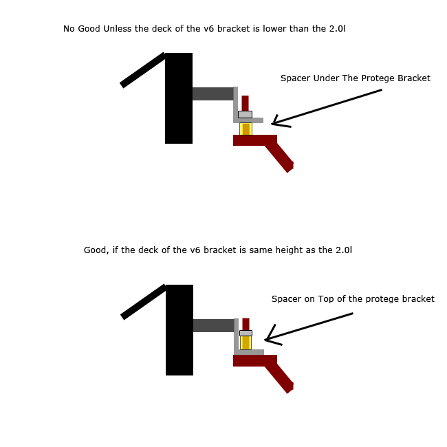

I dont think the spacer idea is going to work though. With Spacers unless the "deck" the studs come through is lower than the normal ZE/DE then the spacers will set that side of the motor down lower and make it slant which cant be good on the other mounts, and axles.
Evan,
That popped into my head as well. I was picturing it, but couldn't think of a way to word it. Haha.
seems like you should be able to fab up some sort of spacer to work. is the motor mount too low or too high?
Good call, spacers are not a good idea. I'll get the FS bracket tonight and pray to baby Jesus they bolt up. If not, I'll just use a die to thread the rest of the bolts down. Looking at the two Mazda manuals for the Protege and Milly don't look like they are anything different so I don't know why the bolts are so much longer on the Milly. Guess I'll find out tomorrow morning.
well his problem right now are the studs are not threaded far enough and the bracket that comes off the protege body mount is too thin to take up that space, unless the spacers were placed on top of the bracket and went between the protege mount and the nuts threaded on. Which, come to think of it, might have been what he meant to begin with for spacers...
Thanks for the diagrams, Justin. #2 is mos def the way to go, assuming the motor is level. I already got the motor bracket off and took pics. Hopefully Josh will be able to bring the other bracket tonight and I can at least eyeball them so I can sleep tonight. And I checked the timing about 5 more times. heh-heh. I'm paranoid about the timing but everything looks good.
