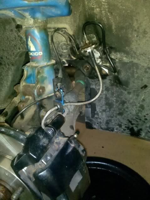

In other news, my friend Pablo and I installed my StopTech front and rear SS brake lines, replaced the front rotors with Brembo OEM's and flushed the brake fluid with Wilwood racing fluid. My arms are still freaking sore... heh-heh.

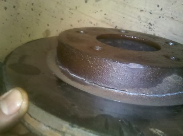

We couldn't get the front rotors off. I pounded on them with a BFH from the inside and sprayed PB blaster all over them. It took forever of rotating a little and hitting them with the hammer for the passenger side to finally come loose. Then on the drivers side I got the bright idea to just whack the front face of the rotor with the hammer to break them loose. I took about 7 whacks and Pablo 2 whacks, and the top hat cracked and the rotor came right off. Haha! Good thing I had replacements. But I usually take care when removing things juuuuust in case a parts supplier gave me the wrong part and I have to put it back together.
The brake lines were pretty straight forward in the front. There is a small 10mm nut for brake hardline that you'll need to remove. I strongly suggest buying a flare nut wrench for this job. Pablo and I ran out to Sears to buy one, they didn't have any 10mm but I still ended up buying $40 in wrenches, they were having a sale... But Autozone had the wrench for $7. Doh! This is a pic of the wrench.
3/4 of the nuts came off with some PB Blaster and the flare nut wrench. The other one I had to use Visegrips on.

Here's a pic of the front lines. (I'll snap a pic of the rear line when I go to the shop later today to secure it better. I can't live with that bloody rattle. haha)
And here's what happens when rusted rotors don't want to come off. They get the s*** beaten out of them until they do come off. heh-heh

I ran into the same problem with rusty rotors on my mom's volvo, I spent a good hour beating the s*** out of them with various hammers but they wouldn't budge. After temporarily giving up (lunchtime!), I called a mechanic-friend who's first question was "You're hitting the face of the rotor, right?". *facepalm* So I got my BFH and got to work, 4-5 whacks later and they're off ... needless to say I felt pretty dumb.
