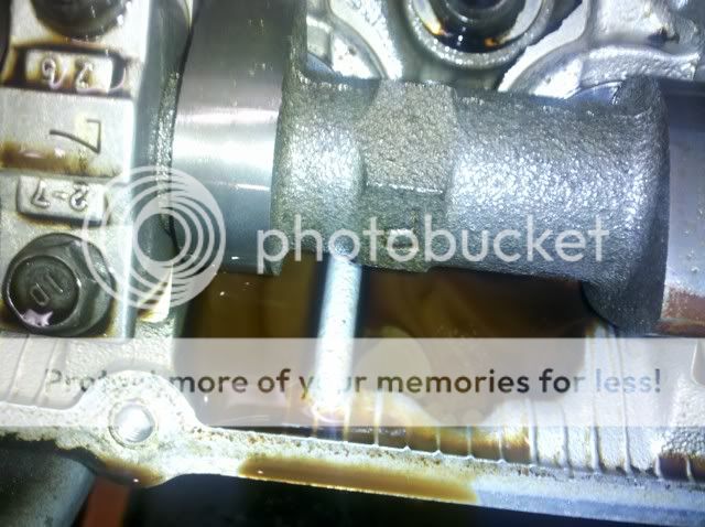

Welp. I'm pissed. I'm thinking that I have a blown headgasket on a USDM KLDE block.
The oil seems too runny and probably has coolant in it. Which would explain the nasty spark plugs.

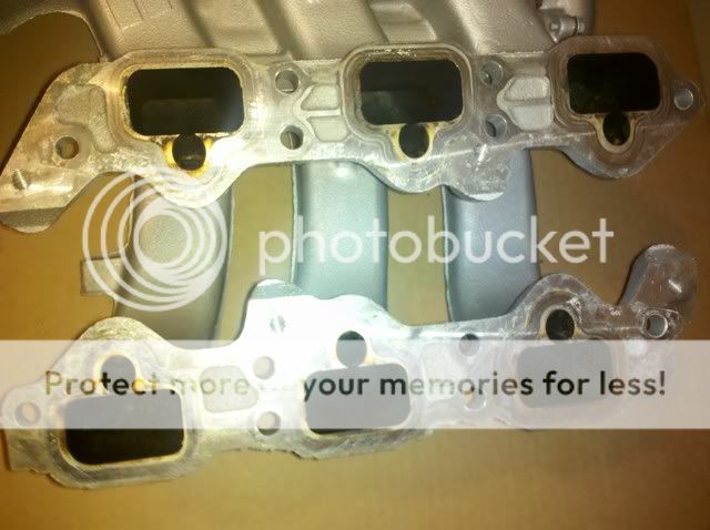

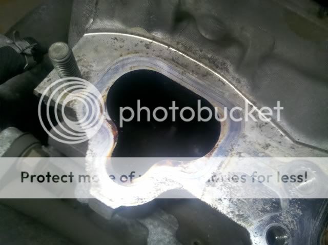

Oval ports on the heads, not square. Even though they are on the intake manifold.
One head is stamped "KL-101" and the other is "KL-1A1"
I'm thinking they swapped a JDM curve neck intake manifold and timing belt cover onto a KLDE block.

I think the Milly motor has square intake ports, but is a regular DE otherwise, apart from the different IM. I think you have a DE with a curve neck ZE IM.
^^^ Yup. I have a KLDE with a KLZE intake mani. I sent the seller an email and I better hear something back on monday.

I was doing some more research last night and this morning. So apparently the Millenia KL (ZE, DE...? I think the Millenia is a hodge-podge of parts from Mazda) has the EGR-less intake manifold with the square runners and oval intake ports on the heads and use the same heads as the A-Spec KLDE. I knew the Millenia uses the same cams as the DE but didn't know they were the same heads. Which might actually be a good thing since the DE heads use the better valve retainers, but I'm not sure if they are the same retainers as the US DE or the same as the JDM ZE.
I found a How-To on porting the IM to the heads as proof.

You need to do a compression or a leak down test to see if it actually has a blown head gasket or if the oil just got contaminated instead of guessing. I have a comp checker, but the leak down is more thorough.

Evan, If you still have time I think that I would pull the heads and take a good look at piston tops and cylinder walls. If the pan is still off pull a rod and main and give them a good look as well. Just by looking at the oil in the head I really can't tell if there is water in it or not, it might be just crappy oil.
that looks like some really milky oil, ive never seen any oil like that lol

Larry and Simon. The oil in the oil pan was darker and thicker but I'm still not sure. Hell, I'm not even sure what freakin motor I have now. The cats at VTEC Motors said I can return the motor but they would just send me another curve neck motor and I need to send ALL the parts back. So what's the point really...
My plan tomorrow is to pull the heads and check the tops of the pistons and see if they are flat tops. That will be the final piece if this is a JDM motor or a UK motor. But as of now, I'm just about to say **** it and ask for a partial refund and keep the motor and check the heads for warping and replace the head gaskets. I'm just disappointed in how this all panned out so far. My optimism is dwindling... heh-heh. Well, regardless, it will still be a good reliable motor when I'm done with it and will still be putting some good power to the wheels.

I will tell you what you have..
You have a JDM Millenia (Xedos I think) motor or a non '95 USDM millenia motor with JDM timing covers (not likely).
Millenia motors have DE (all are oval port) heads unless they are from a '95 millenia. All ZE heads are rectangular port. Millenia IM are rectangular port, regardless of year. All millenia motors have KL01 cams.
