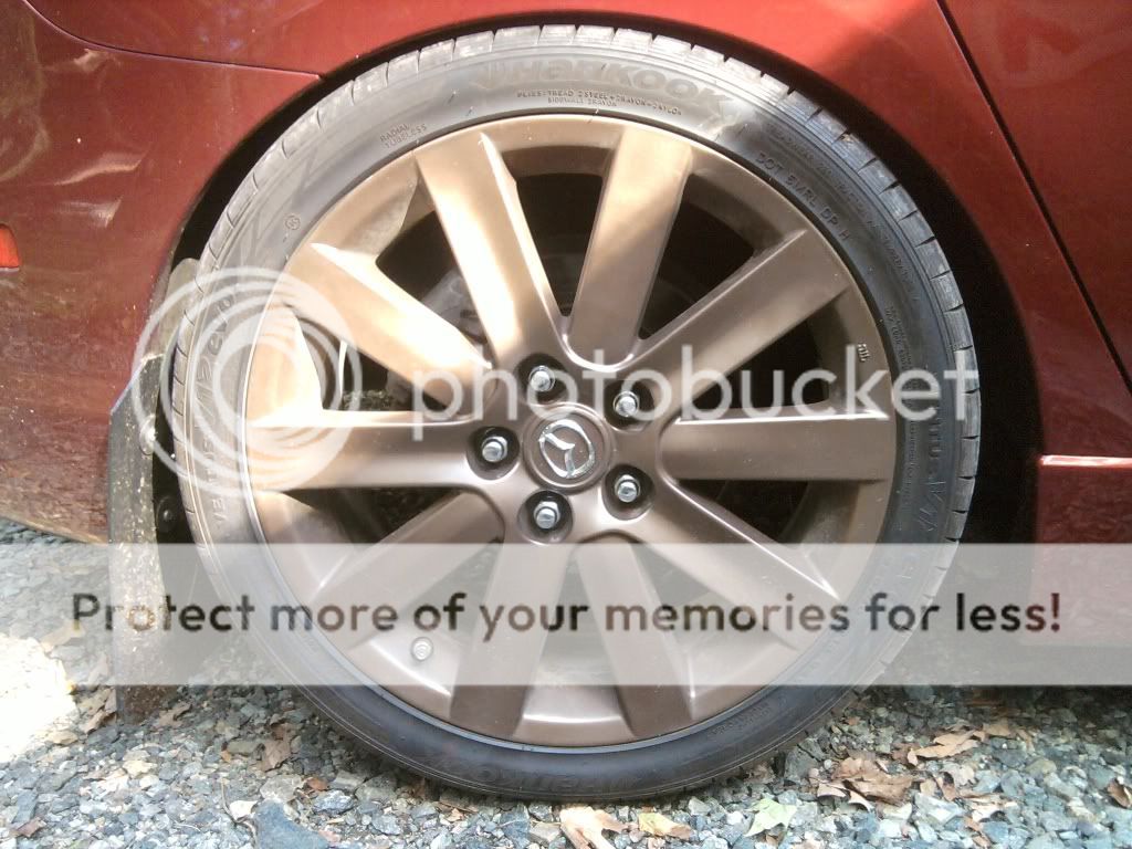

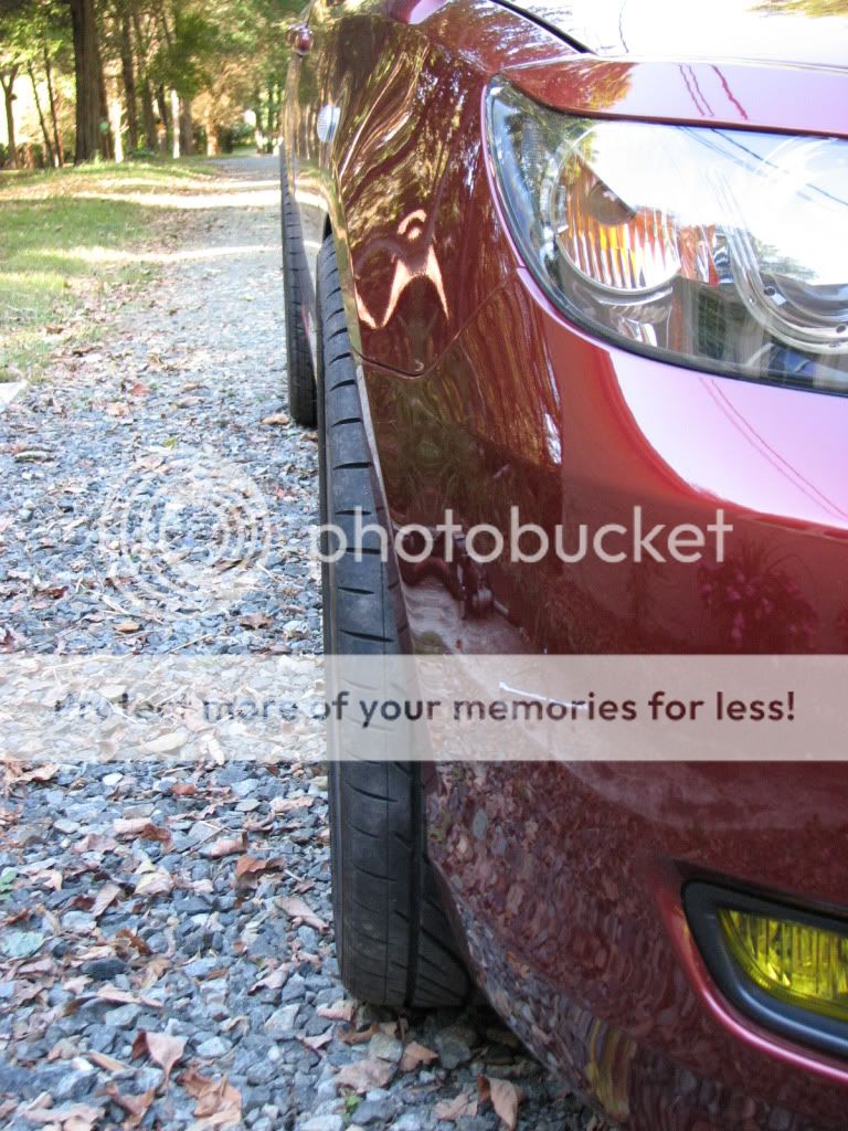

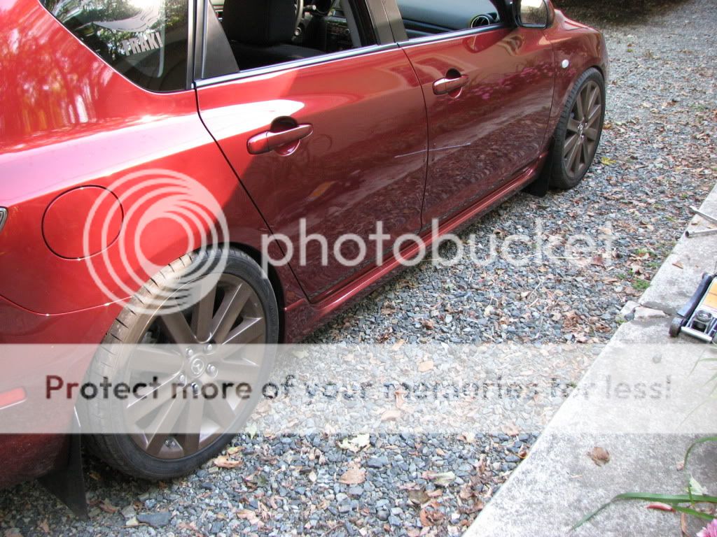

What I did today. Test fit 25mm spacers. I bought them for the rear but threw one on the front for giggles while it was in the air. I'll probably get some 15mm spacers for the front.
Rear wheel poke:
Front wheel poke:
Now I need a good fender roll and I'll be good to go. I can't drive it like this because my rear fender practically sits on the tire. I took it on a 5 minute drive and wore off some rubber and paint.
i have 15mm spacers all around and i think that 15 front 25 rear would be a perfect set up for ms3/ms6 wheels on a 3 hatch
Chef, what size tires are those, can't see in the pics... 225/40? You'll probably have to dial in a tiny bit more camber in the rear even after the roll to completely prevent rubbing, but that sounds like it'll be a great setup with the spacers.
Agreed. I wish I could find a used set for the price I got these 25mm spacers for. It's amazing how a properly spaced wheel makes the car look more aggressive. My rear drop looks even lower now that the tire is pushed out.
Cali- yes they are 225/40. I'm only running around -1.3 in the rear now so I have a bit more to go and it will still be within spec.
