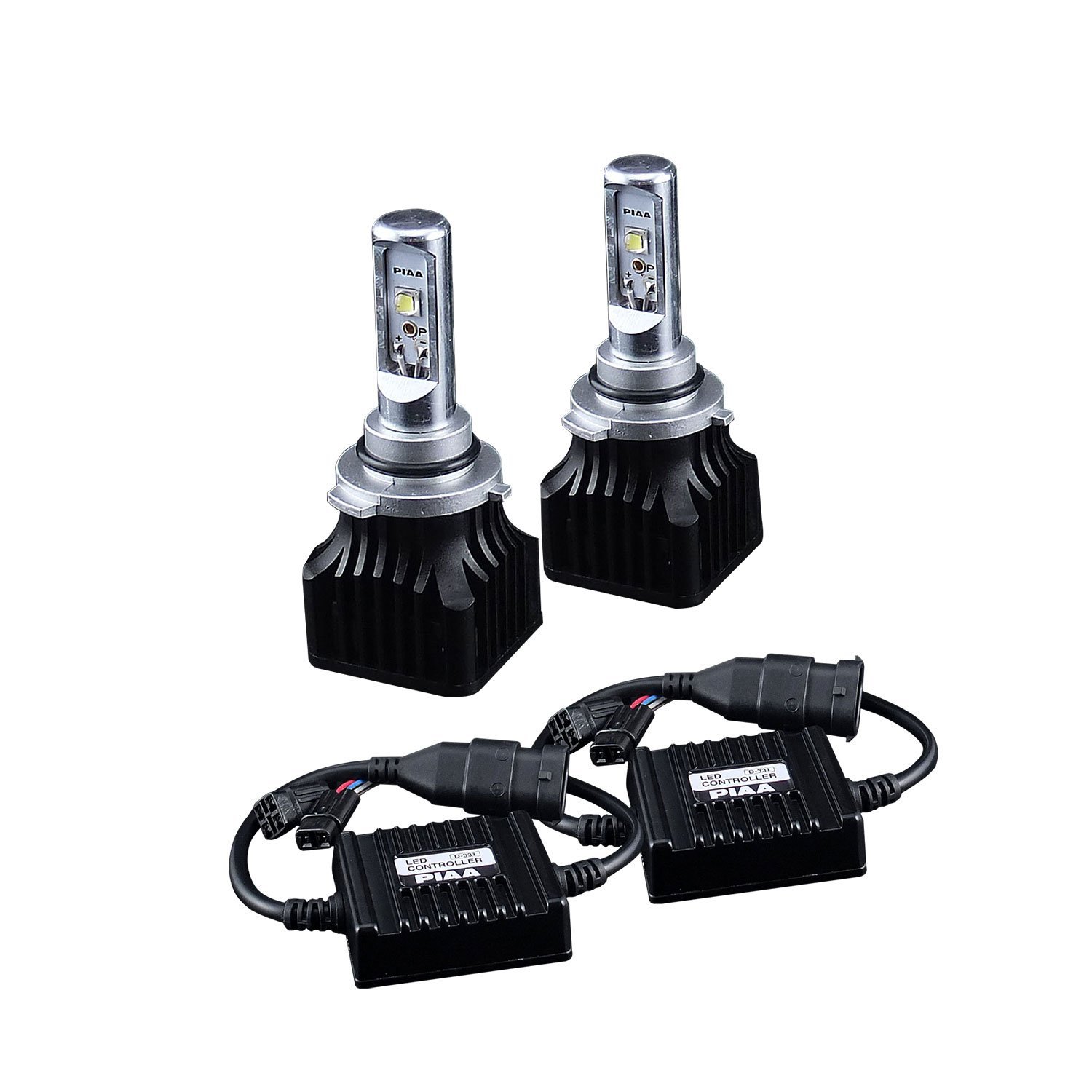

The best buy I made for my mazda
PIAA H11 High Output LED Bulbs 6000k Twin Pack Part No. 17202 - H11
I was waiting almost 4 months, until the low price $207.01 (shocked)

wow, those are expensive. i wonder how long until the fan dies.
i was considering lasfit for around $60, but don't think i would spend anything over $100.
