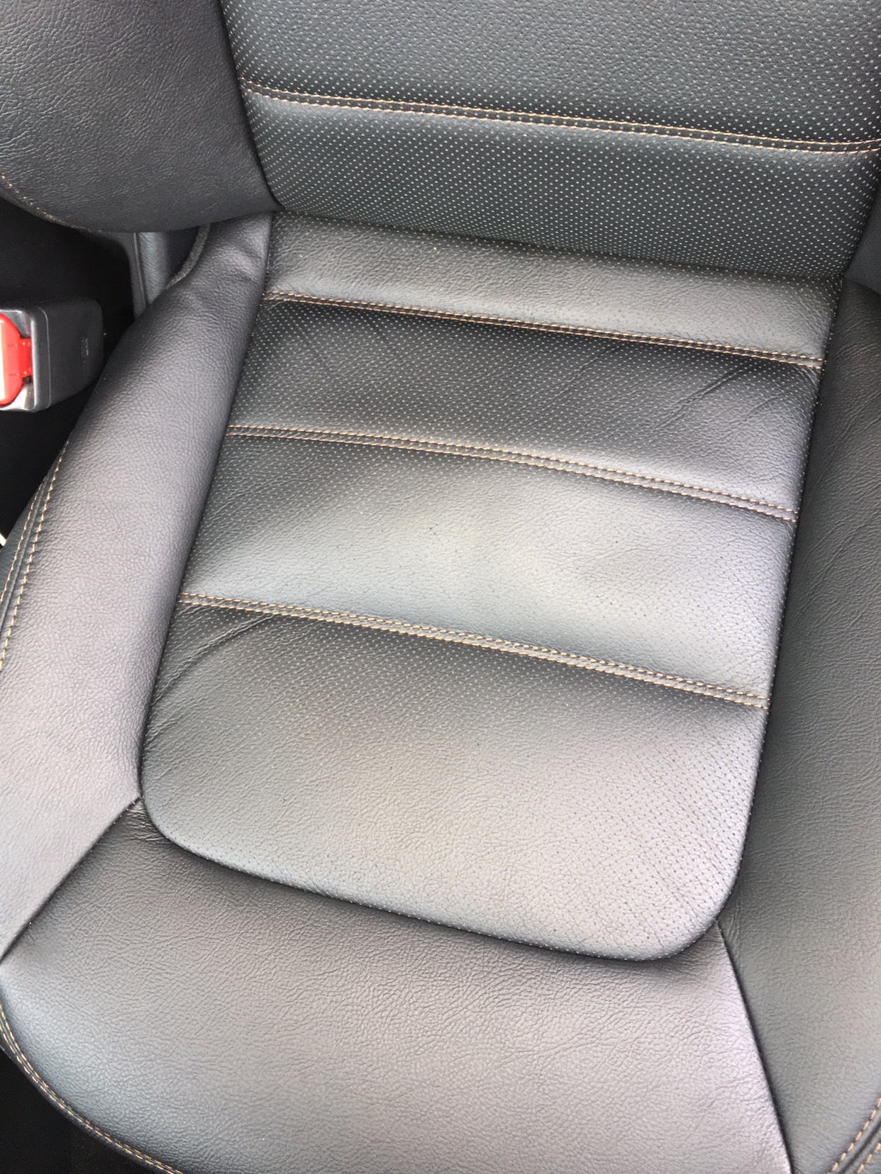

Is this normal for 12k miles on a 17GT? What do your side bolsters look like?
That's normal for any car, if its owner "slides" in and out of the seat. Basically, when you swing your leg over that side bolster, you compress the foam and the leather. Same thing happens if you slide out over that bolster. If you condition the leather regularly (about as often as you would vacuum the interior or wax the car), it shouldn't get any worse than that. No way to avoid this unless you lift yourself out of the seat instead of swinging your legs over and sliding out.
No, it's definitely not normal for a 12K-mile vehicle. The leather seat with ~30K miles on my 2016 CX-5 GT looks nothing like that. There're several discussions concerning about wrinkled leather seats on gen-2 CX-5's. In fact, there's a TSB for this issue unfortunately the TSB attachment provided by Anchorman is gone after our website upgrade. Some did get Mazda replaced their leather seat covers based on the TSB. You should do the same.
BTW, that wrinkled side bolsters is not leather but the leatherette. Our leather seats are not entirely leather but only on seating surface. Anything not touching our body when we sit on is not leather. Headrests are not leather either.

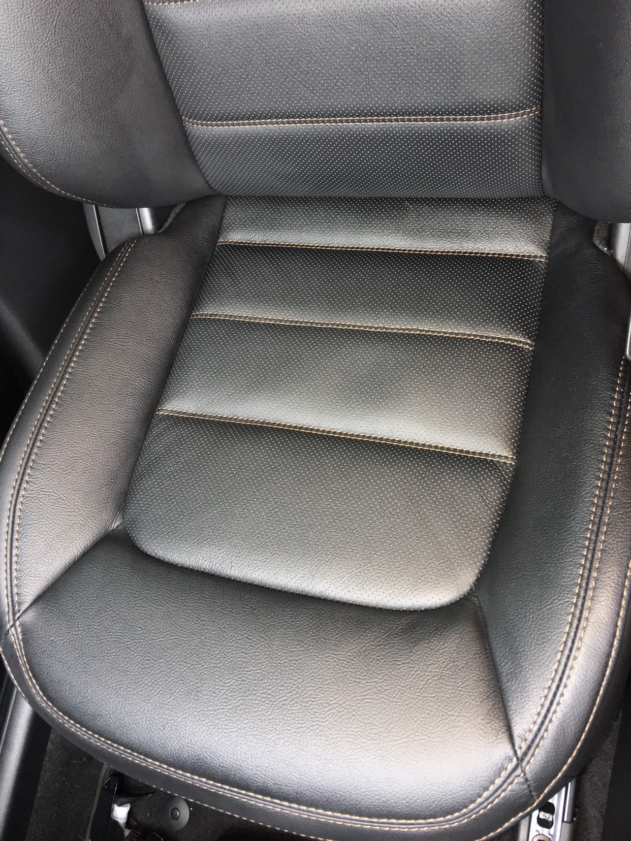

I've only had my brand new 2018 CX-5 for a week, and now the driver's seat is already wrinkling and getting pumpy.
Anyone else having same issue soon after about a week?
Thank you.
attachment.php
I'm the OP. First pic is drivers seat, second in passengers.
NOT normal. Disregard my earlier post, I thought you were referring to creases on the top part of the bolster. Its way too early for this kind of sagginess. Id complain to your dealer about a manufacturing defect.

Wonder if one does moves around in the seat quite a bit might cause that type of creasing (uhm)
Could be? It*s mostly on turns.
I*ll ask when I take the car in again. I*m guessing they will say it*s normal and do nothing about it.

Why? There's a TSB for your issue, and your dealer should search the TSB and replace the leather seat cover for you based on the TSB.
That is the dumbest thing I have ever heard.
The TSB i saw was for vertical leather surfaces on the back seating surface bolster (vertical part of the seat back you are in contact with) - the fix was to have an upholstery shop iron it. Is there a different TSB?
Yes, theres a different TSB replacing the wrinkled leather seating surface including the side bolsters. See my previous post.

Thiss only a cosmetic issue a customer can accept such defect which is caused either by leather / leatherette stretching too easily or poor design / workmanship. Ill never say thiss normal. Gen-1 CX-5s including mine have no such issues, and their leather seats have a lot more miles on them.
