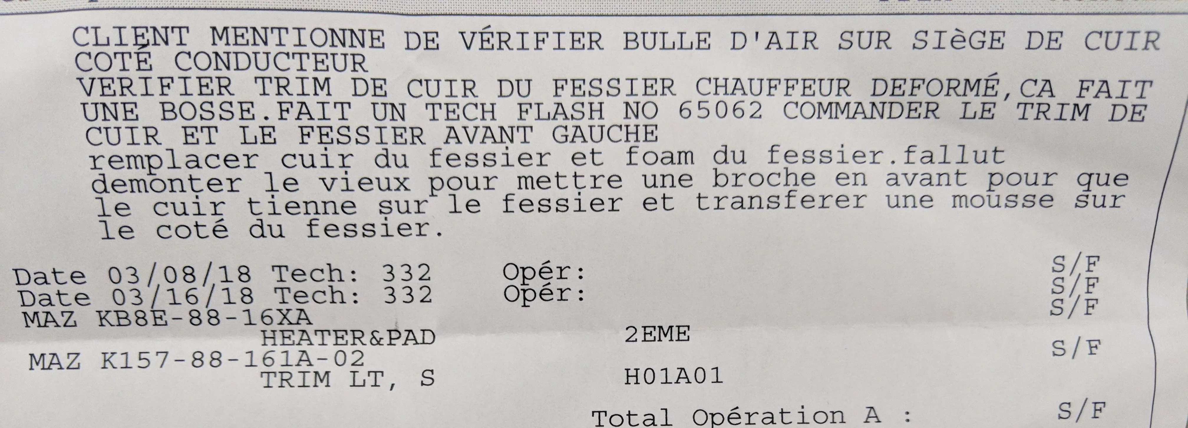

Heres an example of a 2017 CX-5 whose bottom leather trim got replaced under warranty due to the similar issue on seating surface.
Had the work done, here are the details:
Before Photo:
After Photo:
Work Order Details (French)
Translated to English:
CUSTOMER MENTIONS TO CHECK AIR BUBBLE ON LEATHER DRIVER SEAT, VERIFY BOTTOM LEATHER TRIM FROM DRIVER SIDE, IT MAKES A BUBBLE. DID A FLASH TECH NO 65062. ORDER THE LEATHER TRIM AND LEFT FRONT BOTTOM CUSHION. replace buttock leather and foam buttocks. The old one had to be dismounted to put a pin in front so that the leather could hold on the buttocks and transfer a foam to the side of the buttocks.
Yes, there*s a different TSB replacing the wrinkled leather seating surface including the side bolsters. See my previous post.

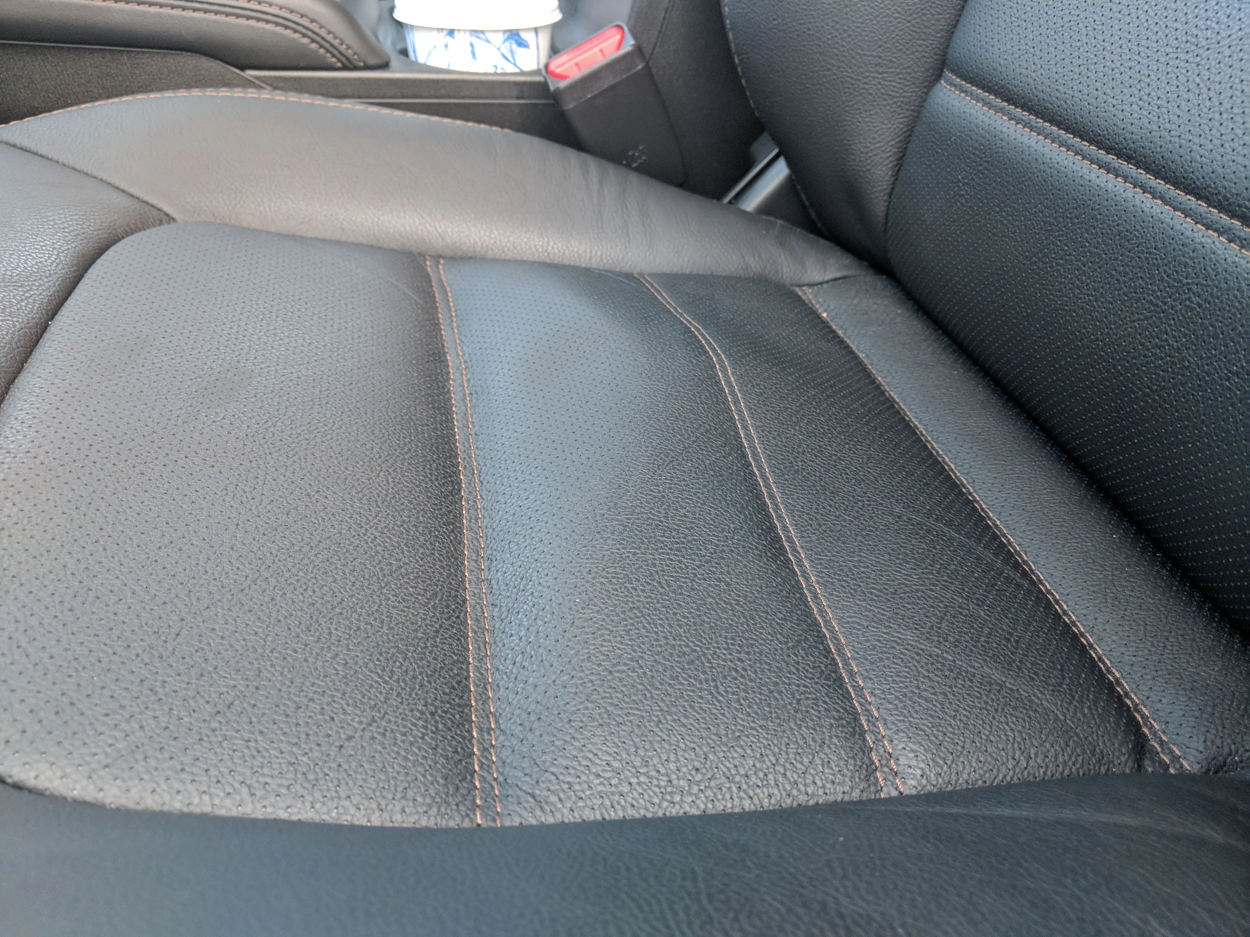

I just checked mine and I have some creasing on the side above the power seat buttons as well. Not as much but it is there.
IMHO it is normal.
The leather having a wrinkled look is due to the material under the seat changing form from being sat on.
The foam under the leather compresses and the leather conforms to the new shape of the foam.
Its not really an issue with the leather, but whats underneath. Happens to most every car.

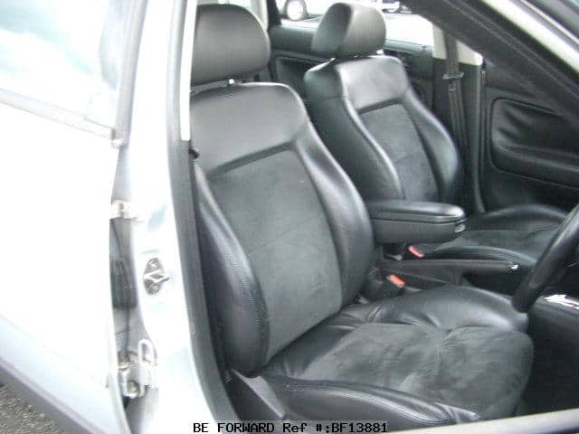

After a quick google search:
2013-14 Mazda CX-5
gallery_used-car-carlist-mazda-cx-5-skyactiv-g-suv-malaysia_2525672_cd4808615534924960525_v1sm.jpg
2000 BMW 528i
2001.5 VW Passat
Of course, the wear varies depending on mileage and owner habits, but you can see that it does happen to most seats.

All the reasons you said about the wrinkled leather are not applicable to OP's case, as that wrinkled part is not leather, but synthetic leatherette! Strangely this 12K-mile leather seat does not have any issues as you mentioned it should happen within the first few thousand miles on seating surface which is actually leather.
Again, there's a reason why Mazda issued a TSB which simply means there's a problem on gen-2 leather seats, or there won't be a one.
Is this normal for 12k miles on a 17GT? What do your side bolsters look like?
