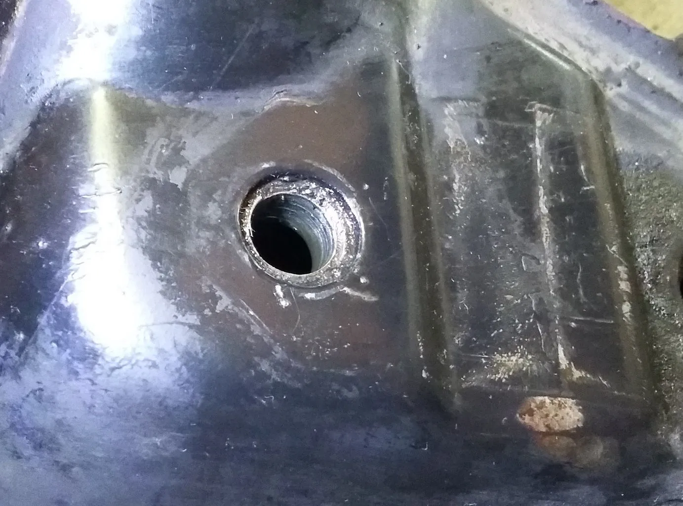

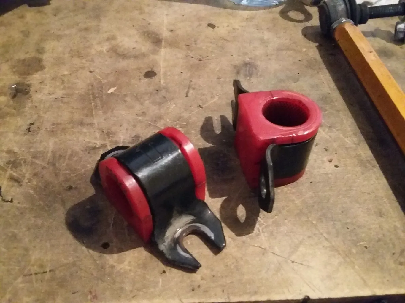

One of the very first mods I did was nolathane front swaybar bushes, way back before I joined here. Seeing as it's slightly easier to get at them with no motor I pulled them out to check, lube and replace if needed. A lot of people don't like nolathane as they don't last long, but these bushes look brand new! I chucked some more lube on them and threw them back in....
And promptly stripped one of the threads on the subframe :(
Cue an hour of swearing at bolts and wrangling the steering rack, now the subframe is out and waiting for me to try a helicoil for the first time. Should be fun!
Was hoping to avoid pulling the subframe but it's not a massive job and gives me a reason to clean it and replace all the other bushes while it's out

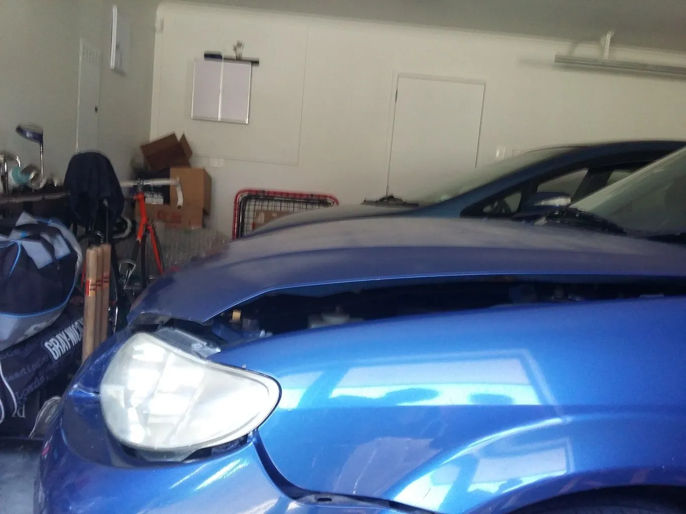

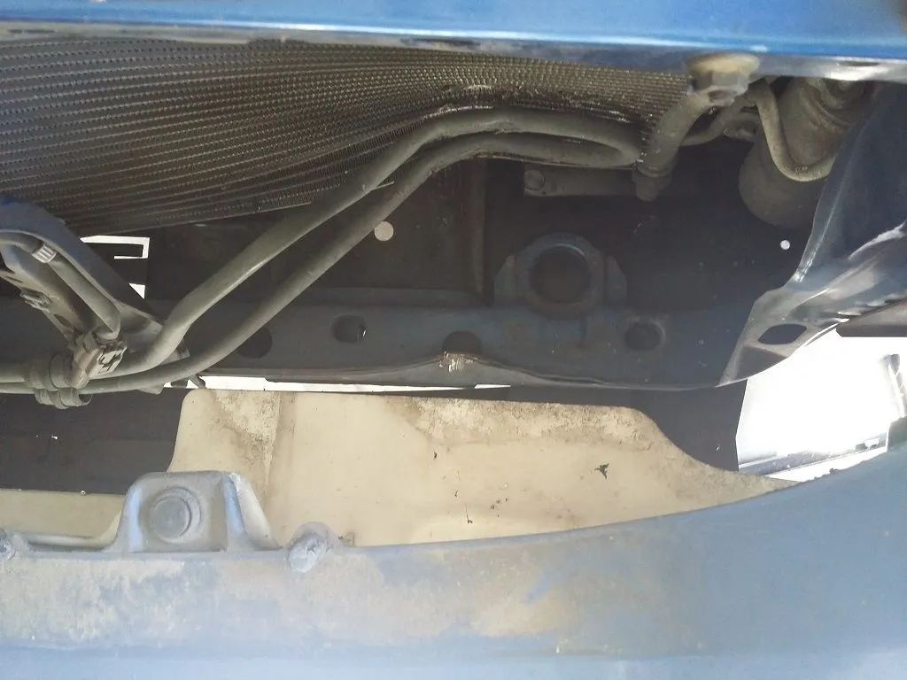

Somebody decided my blue car was super cool and fast and stole it from my driveway, crashed it into something and dumped it about 1km away :( Police have done their thing so now it's up to the insurance assessors.

They've hit something square on the front. Bonnet, top rail, rad supports, rad and coolers are all bent. I'm hoping it's repairable, I really really don't want to scrap this car!
Damn scum! The scumbag lives nearby. And is probably a little s*** joyriding.
If NZ is anything like AUS, insurance will right it off. Cost too much to repair compared to value. I'd buy it back with the insurance payout (don't ever take their first offer) and repair it.
Thanks guys, yep probably a local going for a joyride, apparently there's been heaps of these lately.
Everyone that's seen it has gone 'yep, that's a write-off' so it's not looking too great for this car.
I've been thinking about repairing it, but I think that if it gets written off then it gets deregistered as well which will mean a major hassle to undo, plus it's been thrashed without coolant so the engine is suspect too.
We'll see what happens with insurance...

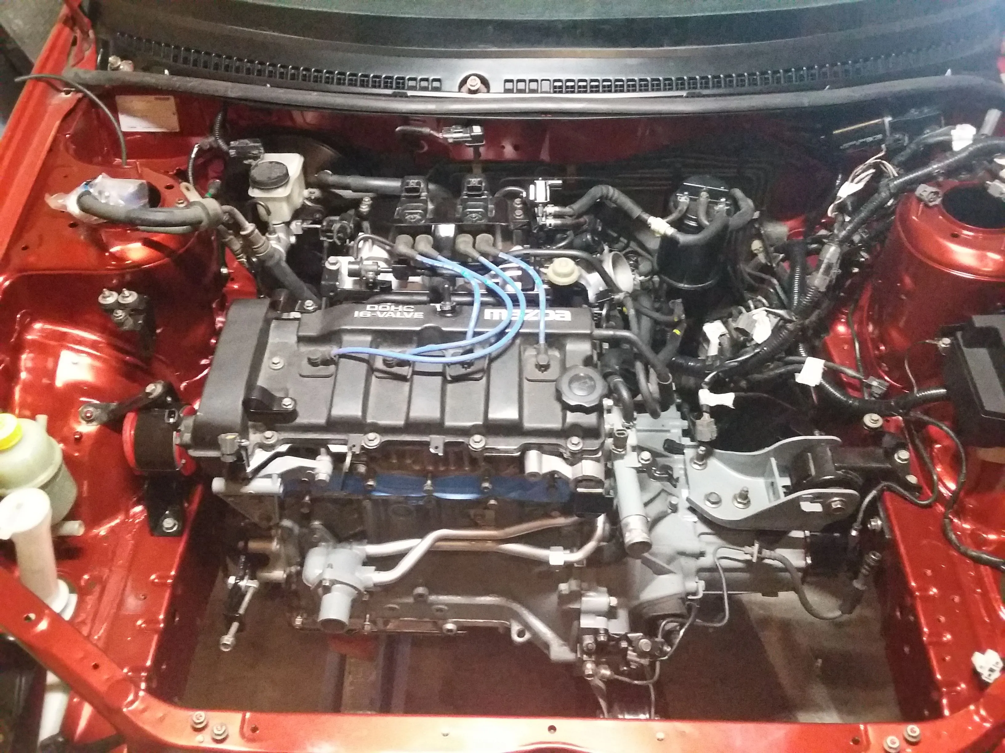

By some miracle, the engine is back in!
I did it by myself, and somehow managed to do it without busting any knuckles or scratching any paint! the hardest part was wrestling the gearbox on to the clutch and engine. It's on and everything moves nicely now.
Glad to have this milestone achieved, now the heavy lifting and major maintenance is done it's a downward slope to completion and driving again! Next project is to button up the brakes and get all the fluids back in the engine before finishing off the SC piping and getting stuff tidied up

nice! one thing worth mentioning, the passenger side motor mount inserts, i've seen other people use a skinny bolt with some washers to hold in the inserts better. the zipties never really make it sit in the mount completely. it bothered me to know that i never learned about the bolts until after i went onto solid mounts lol.
Thanks 323, yep will probably replace the zip ties as the outside insert is bulging badly, thanks for the tip! Still waiting on the gearbox mount inserts from AWR but they should be easy enough to get in once they arrive.

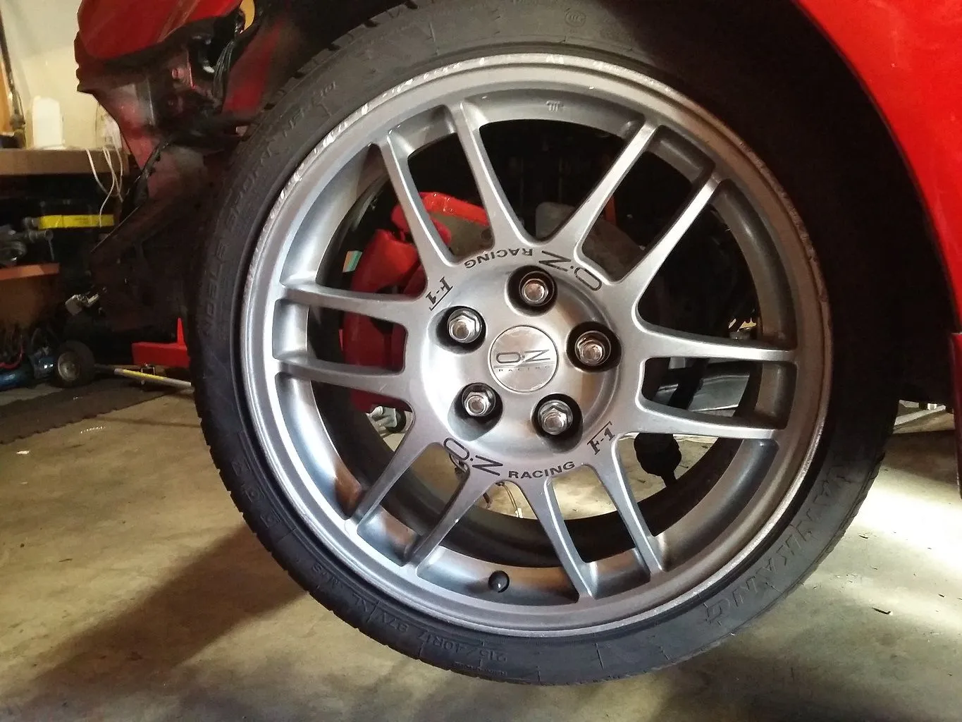

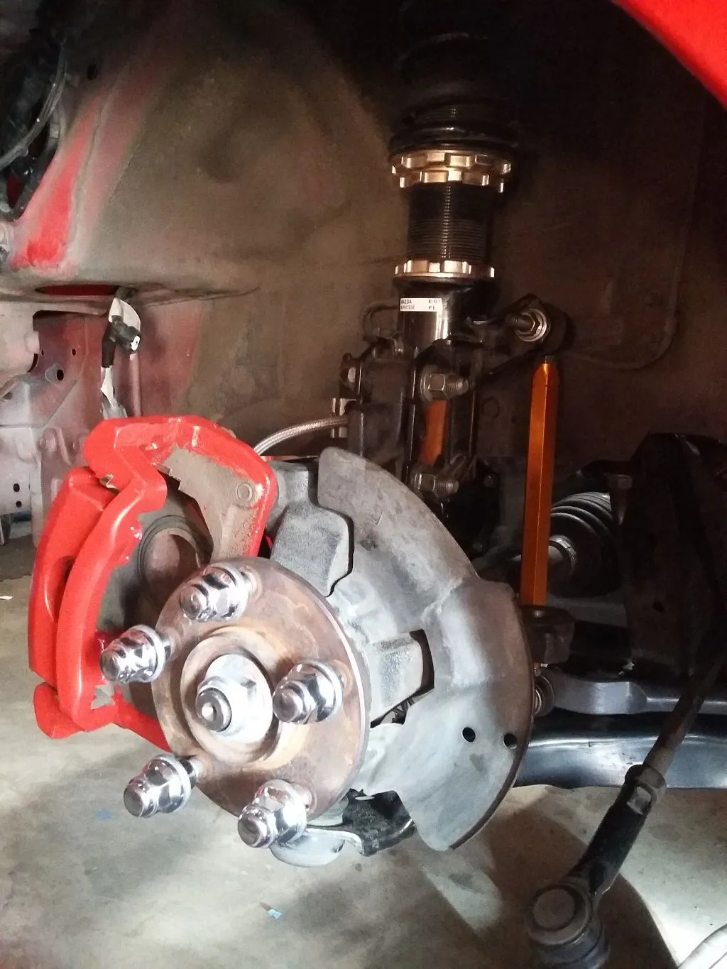

Driveshafts back in, hubs cleaned up and wheelarches scrubbed of all that dirt

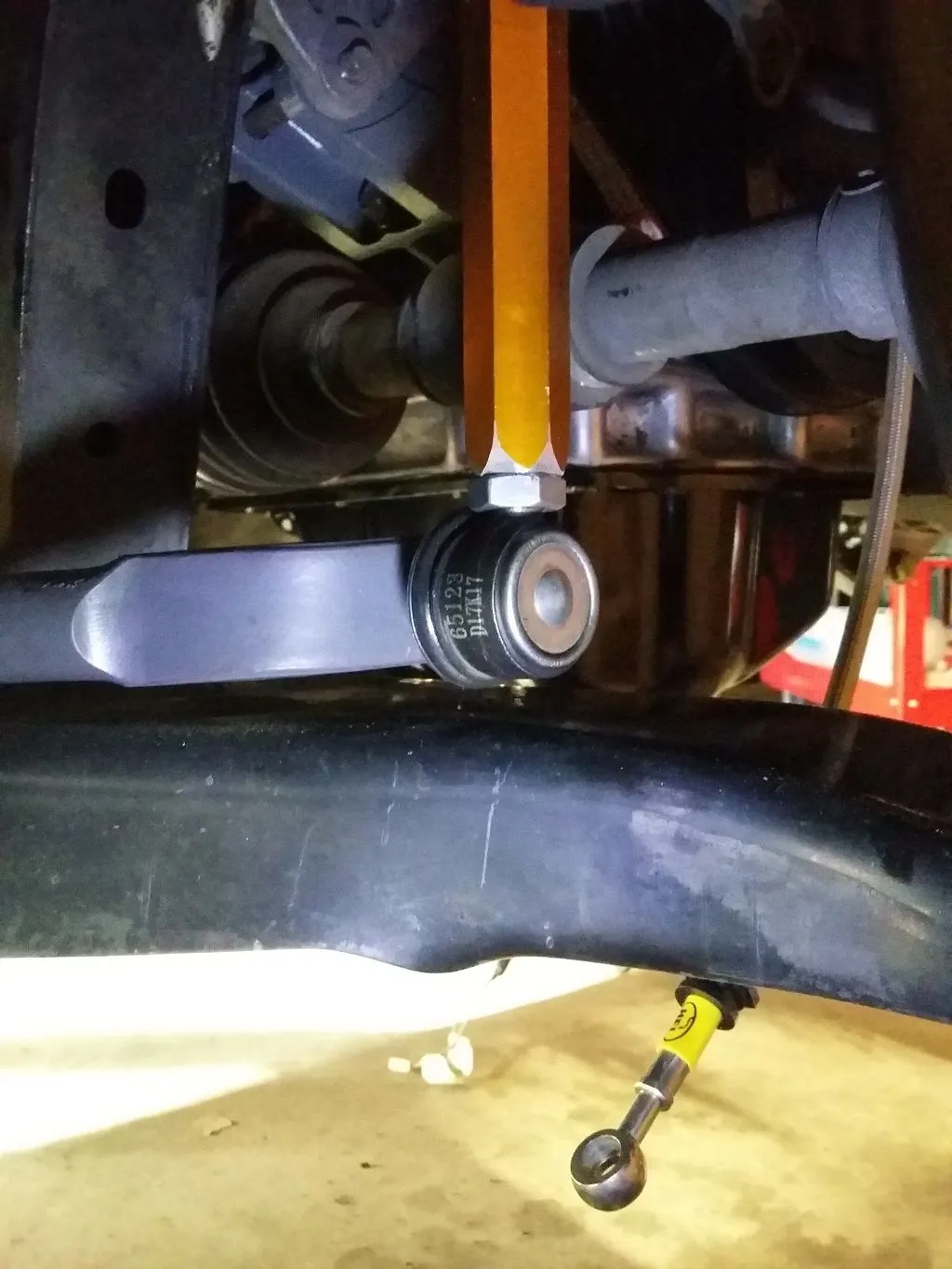

Coilovers in, swaybar links ended up being a tad too long and were hitting on the control arms so I had to cut 15mm off the length
New stainless brake lines in, calipers in, looking gooooood :)
Filling out the wheels now, the stock brakes looked tiny in there!

Looks so good man, I cant wait to hear that thing start up. You gotta do a sound clip, are those some BCs I spy in there? Also what endlinks are those?
Thanks! Yep, video will be taken!
This one was before I pulled the motor, SC isn't plumbed in so its way louder than it will be once finished
Yep, BC gold coilovers hiding in there, Endlinks are from whiteline and are really well made (just a bit long lol)
