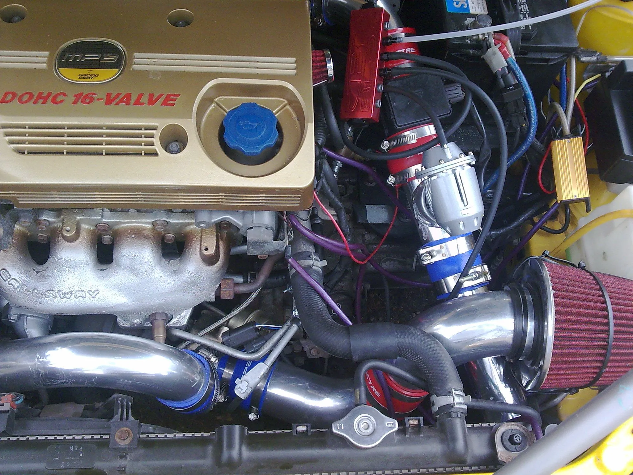

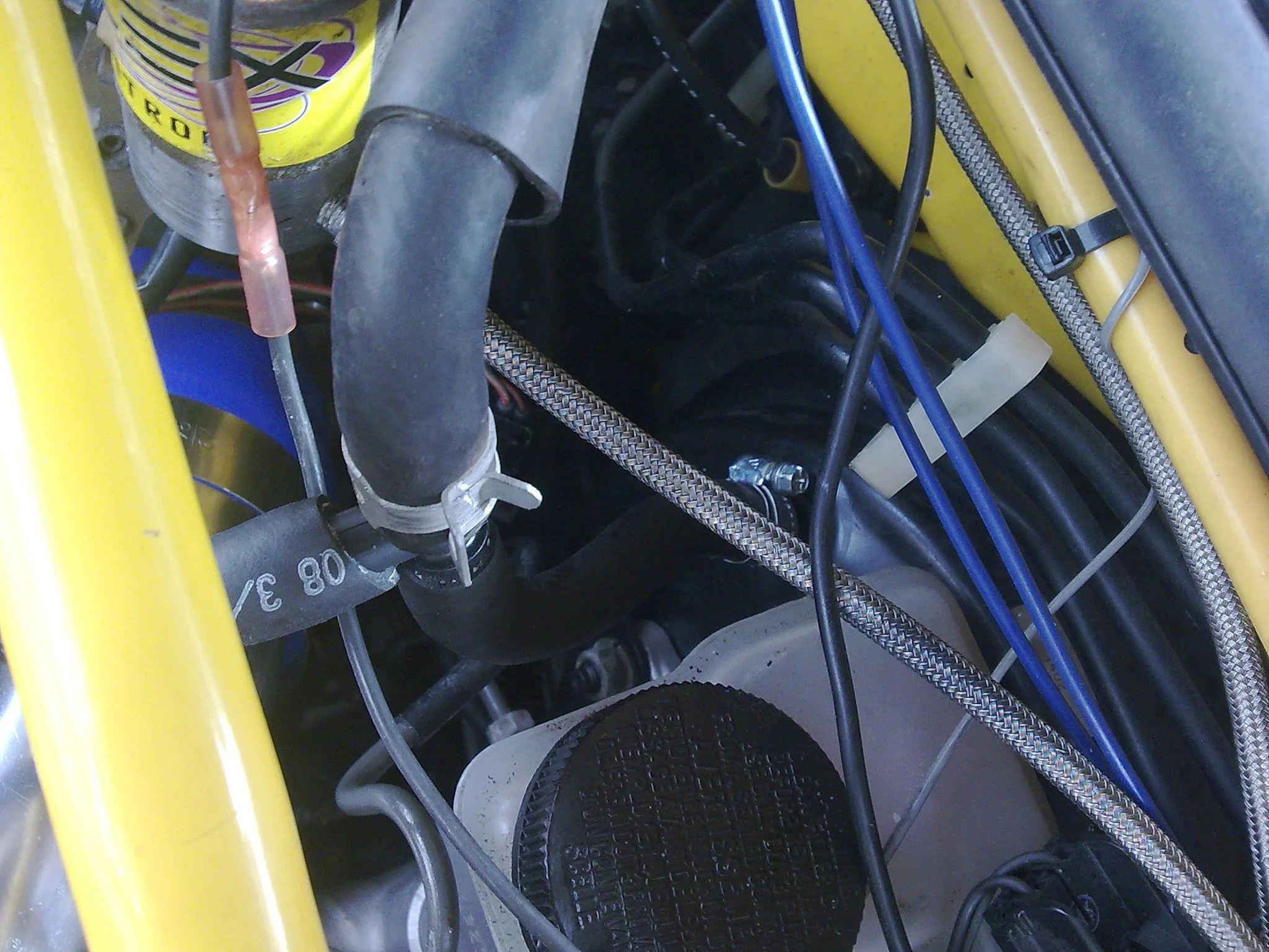

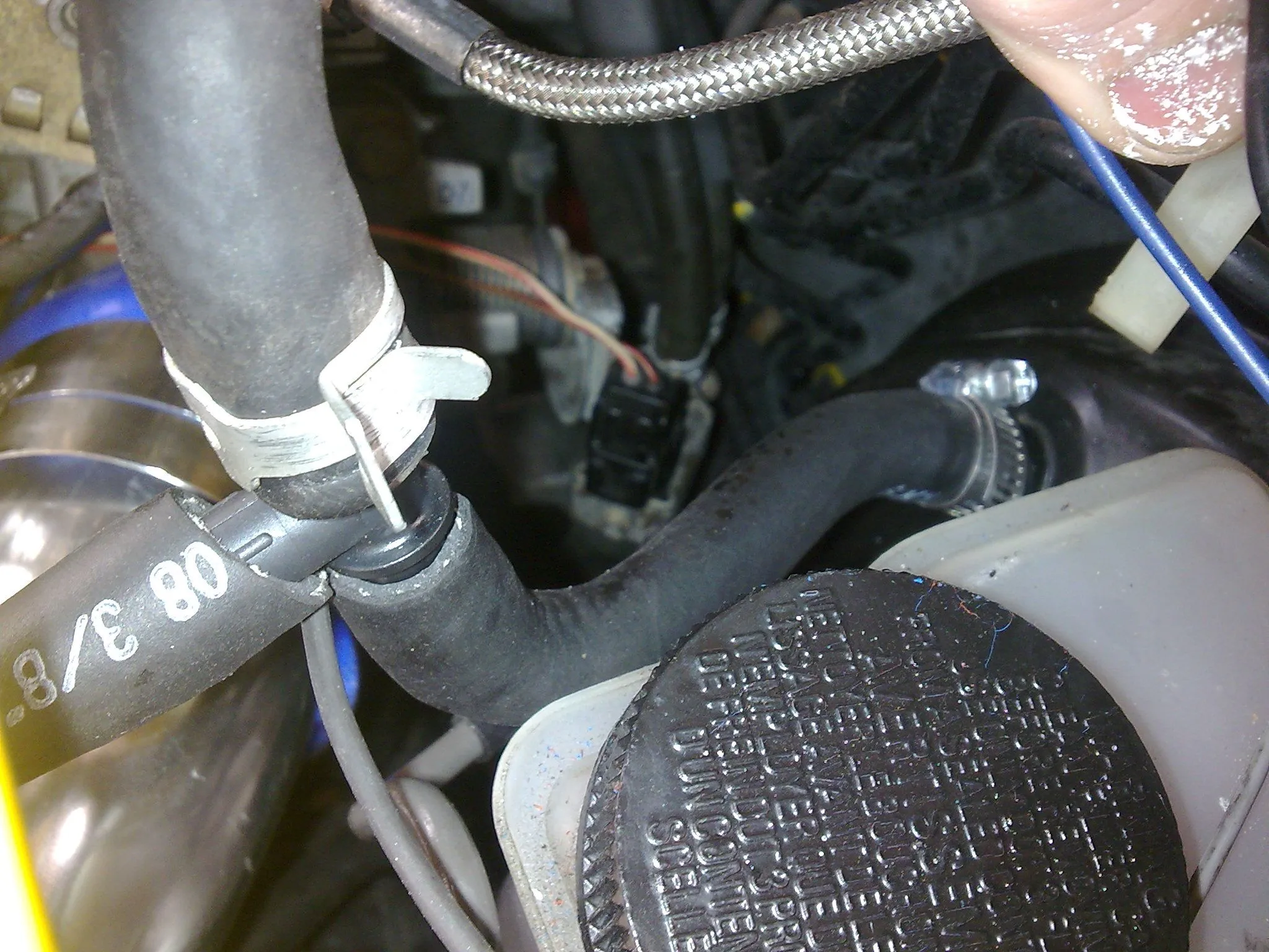

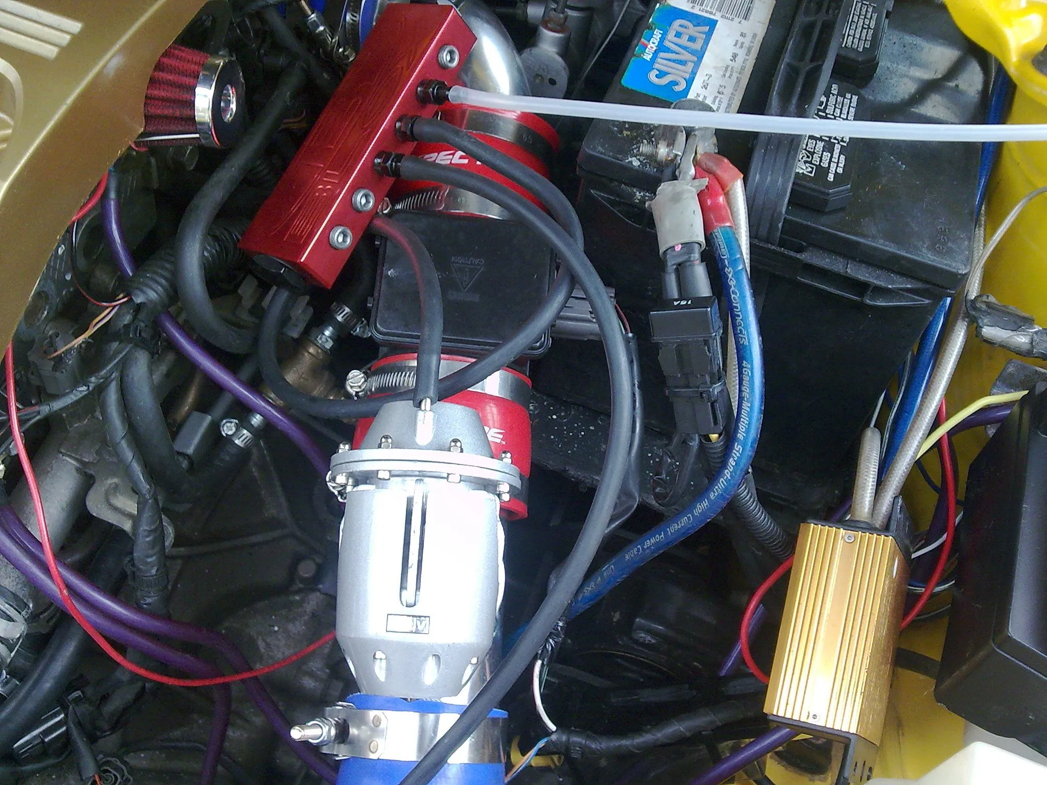

ok guys here are some pics. Not sure if they will do any justice or not but maybe you can see something I dont. I included a pic of the T setup for vac to my vacuum block. You can see it T-ed into the brake booster (not sure if its the right spot or not) Either way this will solve my boost gauge prob.... waiting on the ss afc to arrive so I can hopefully solve my main issue.

hahah yep theres your problem the t is definitely on the wrong side of the check valve because you put it at the very end. so fell down the line and a few inches after the check valve, cut it and put the t there
lol dude one thing at a time. Right now the car is red but I havent gotten to the door jams or engine bay either and I had to use the couplers I could find, so yes its quite colorful.... By the way thanks alot mp3-79bronco
