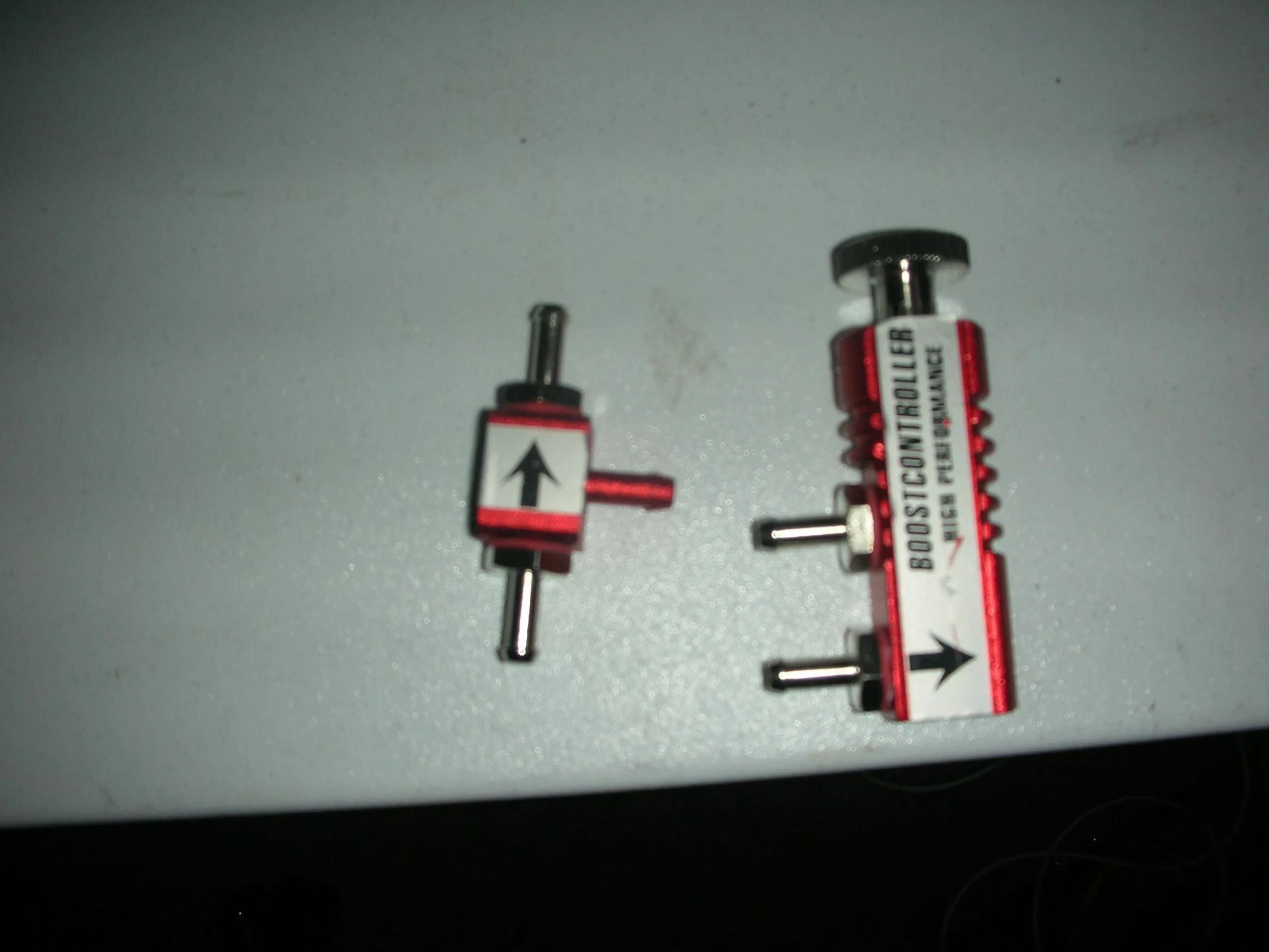

hey ok so now you only have a 2 prong boost controller and i have DSCN0556.webp.... i think this is how you atttach it but i have the ebay version of the manual boost controller and i want to know because i have 2 peieces.. 1 big one with two ends and 1 small one with 3 ends so how do i hook this up without messing it up
help me please!!!1
so how would i hook this one up because it has more hose fittings and i am so lost lol....... have a uni-chip comming so i want to put boost at 9psi so please help me......... and i know what one to remove but how do i remove the stock boost controller...DSCN0556.webp

OK, so I think I've got this strait, but want to double check... the side port goes to the WGA, the bottom port (opposite the adjuster) goes to the vac/boost source, right?
And looser (counterclockwise) lowers the boost...
