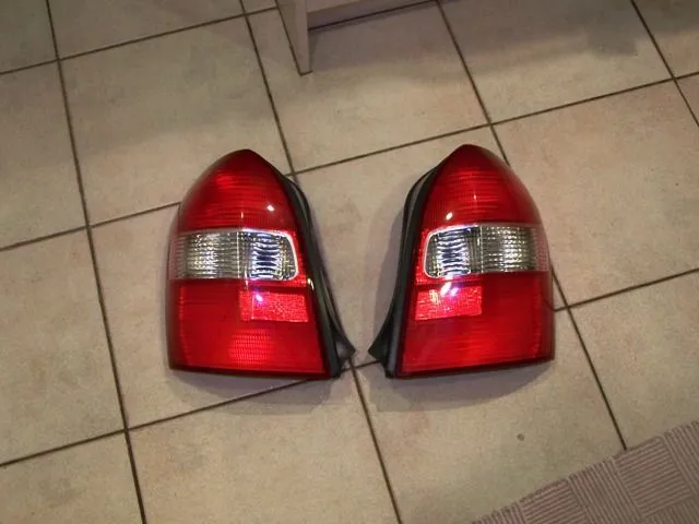

maybe a stupid question but are these the same as the jdm lights:
cause this are the ones that come standard here in europe.
If they are the same I could check how much they would cost here....

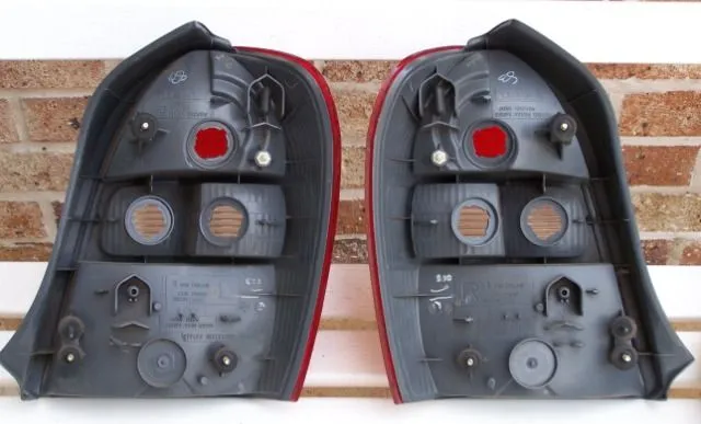

The edm is the same as the jdm except the edm does not have the 4th hole on the bottom for the brake light. There is a slot to cut out but doesnt have it punched. in otherwords the bottom wont light up on edm tails. Either way, to add these tails you will need new harnesses for both. So buying from a vendor will be the only way. Or you have to customize it yourself.

I have the edm ones and the stock harness doesnt fit. There is 3 holes but you could punch out the bottom but it doesnt help since the stock harness only has 3 bulbs
Heres what Im talking about

I wonder if the sedan taillight harness would do anything for us. The sedan taillights are a very similar setup to the JDM taillights, as there is a lower light that is just always on, an upper light that gets brighter when the brakes are on, and then of course the reverse lamp and turn signal lamp.

Hey Johndg - Where did you pick up the EDM tails? I prefer these over the JDM tails because they don't have the orange piece. It would involve a soldering iron, but these can be made to work with minimal effort.
