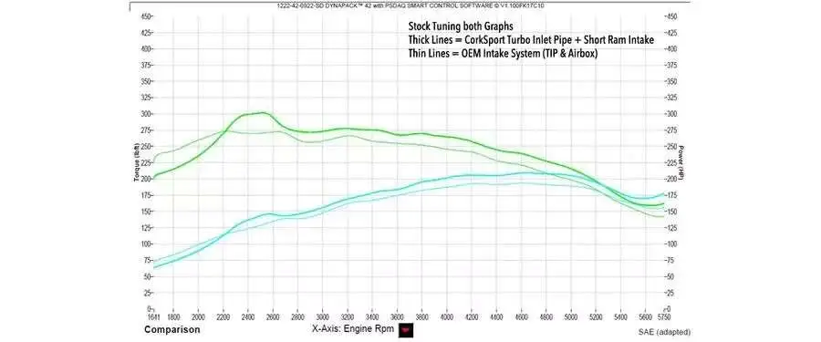

CS. But as with most mods that increase airflow, they also decrease velocity. So I would expect (and CS graphs appear to show) a reduction in power below 2200 rpm.
Me, I think we have enough on tap that I'm not worried about it. But I think the TIP with a tune could open up some big gains over the entire powerband.
I might recommend you skip the TIP. As with most mods that increase airflow, they also decrease velocity. So I would expect (and CS graphs appear to show) a reduction in power below 2200 rpm.
I've looked at this WOT dyno graph.
The lose of low end power at WOT will be amplified at partial throttle. At WOT, CS TIP takes a big jump in power above 2200 rpm. Assuming boost is coming on this exponentially increasing volume.
It would be faulse to assume at partial throttle this TIP increases power at 2200 rpm.
