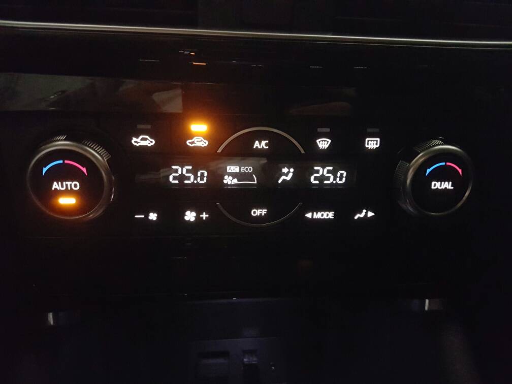

Does your Automatic Climate Control system have our missing "ECON" AC mode?
Eco mode activated, it does by itself when the outside temp is within 2 degrees from the set temperature on the inside.
Sent from my SM-G935F using Tapatalk
AC "ECO" Mode
Thanks for posting a picture! So the AC "ECO" mode is not one of the mode selections on "AC" button, but rather it's activated automatically! I believe "ECO" means the AC compressor is off or on depending on the temperature been set. Without it the AC compressor is on all the time when "AC" is on, but by introducing heated air from heater core mixing with cold air by AC's evaporator for desired temperature.
You can also select it manually with the A/C button, but if you hit the auto button the car will decide whats best suited for the temp you selected.
