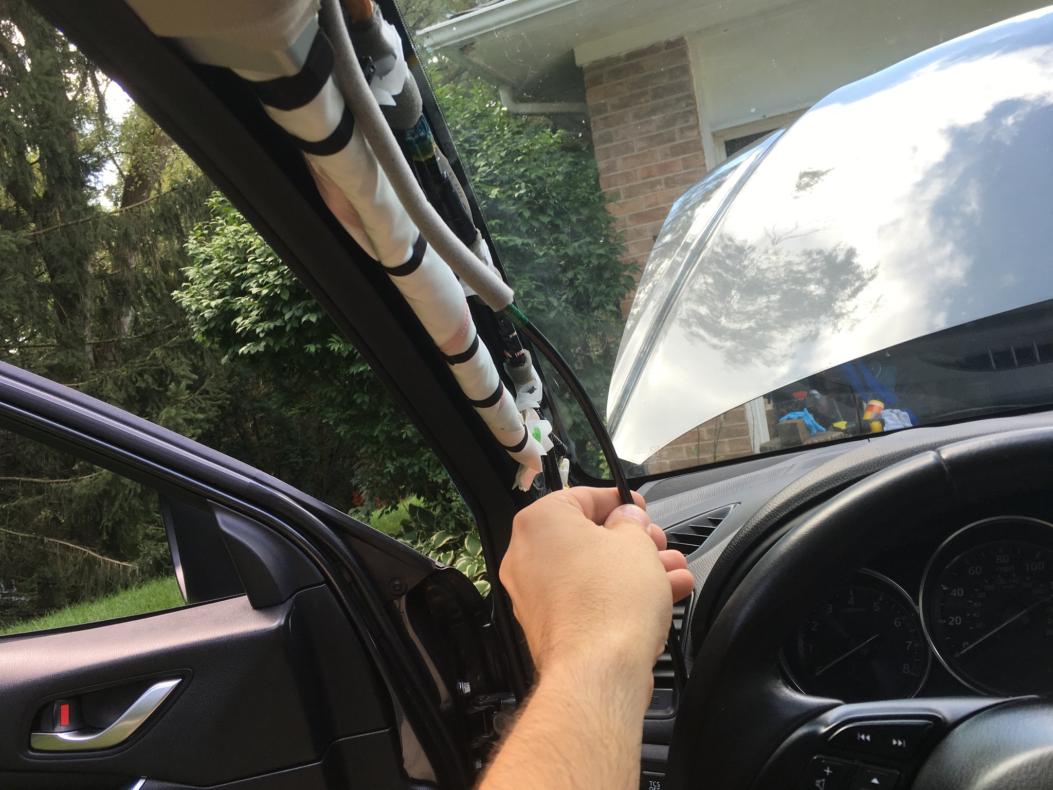

Harness down the A-pillar, used the existing clips to hold it into place
Down the A-pillar, used the existing clips to attach by seajus s, on Flickr

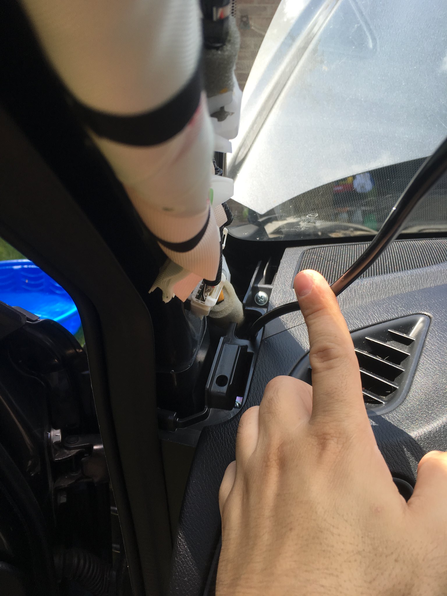

Dropped it straight down this hole with no problems...
Dropped harness into this hole by seajus s, on Flickr
Gotta figure out where to plug this in though...
[/url]Hmmm by seajus s, on Flickr[/IMG]
