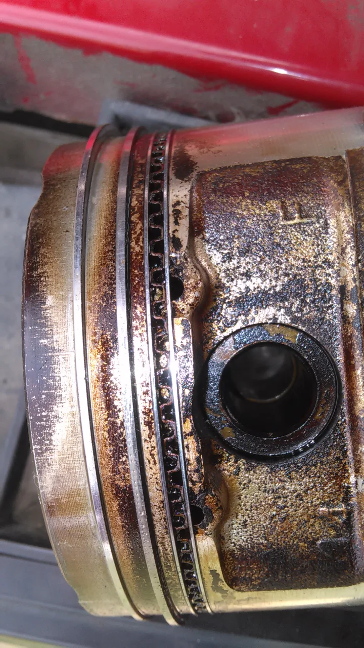

Apparently the Japanese take Way Better care of their cars than North Americans, so an engine from Japan shouldn't have pistons like this,..
