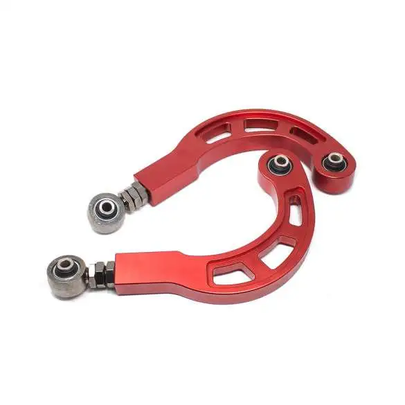

I think others make them too but here is one option. I just ordered a set and will let the forum know in time how they work.

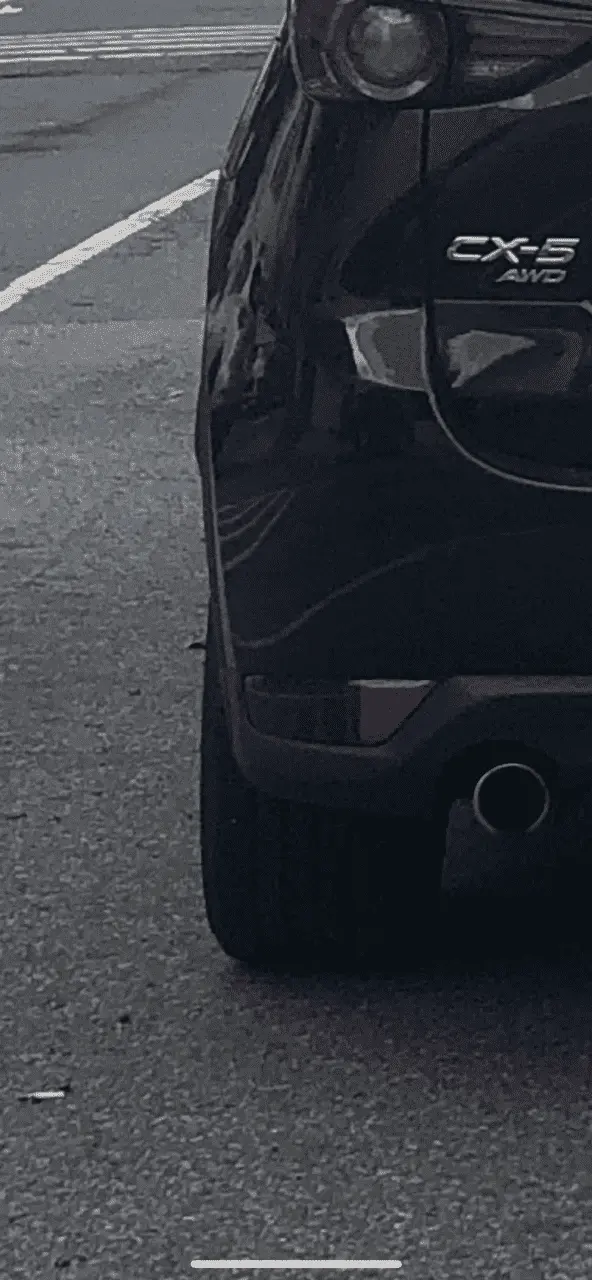

I have these installed on my corksport dropped 19’. I had about 3 degrees of camber prior to install and these fixed it.
But in typical cheap materials, they did rust quite quickly.
Zoomed in photo for reference. Don’t mind the quality.
Which part of the Godspeed camber arms rusted? I know the arm is aluminum so I'm guessing the rest of it?
Update:
On now. So far, so good.
Hefty things and there is a lot of adjustability although for whatever reason, I appear to be right about 0 camber before I put them on after lowering the vehicle via a coilover setup (actually, divorced spring and shock on the rear of course). Others set up with lowering springs seem to have a lot of camber change and that's why I thought I would need these. Probably not, but at least they are on for tweaking.
A quick follow up everyone with the Godspeed option... still holding up okay?

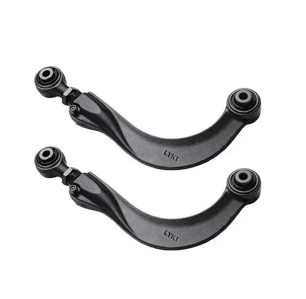

I just ordered the SPC lower arm. This arm is listed as a camber/toe adjustment arm so I am also confused. Will I not be able to adjust camber on the rear? The SPC arm looks nothing like the rest.
picked these up off ebay for my project. They were the most OEM that I could find.
Search "cx-5 rear control arms" and they show up nestled in with the other options available.
