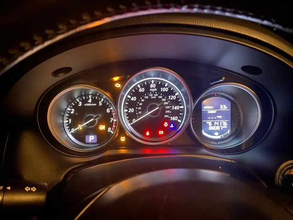

As the title says, I have a 2014 cx5 in great shape. Never had any issues or modifications (outside replacing my horn a few years back). 88k on it and I’m the original owner. The battery might be 3 years old. I tried both mine and my wife’s key fobs.
Starting yesterday, I went to start my car and all the lights came on and radio with all the warning lights on but no crank. I never had a crank issue. No clicking or anything, it seemed like a computer error. That happened a couple more times since. I shut it off. Put the fob on top of the start button and it either starts fine or errors out and doesn’t start. Any ideas on a trouble shoot?

I seem to recall something with the shifter lever having a switch that tells the car when it's in park going bad but can't remember exactly what happens when it does. But it's worth moving the lever back and forth a couple of times and seeing if it helps...
As mentioned above there is a switch connected to the shifter to ensure it doesn't start in gear but there is also the brake switch ( which has to be functioning properly) to ensure the brake is applied before the vehicle is allowed to start.

I would probably check each in that order
Shifter switch although your pic shows P on the dash.
Start button (if fob batt is changed). Also do you have a second key to try?
Starter last. And most likely there is/are a relay somewhere which receives signal from the start button. Have to look if we can find a starting diagram somewhere.
