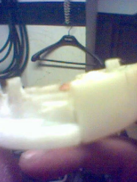

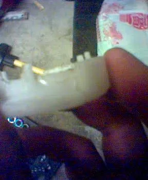

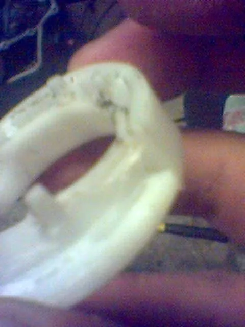

I didn't measure the height that needs to be shaved off the bushing, you can go back and forth with it, you will not be able to re-use the rubber ring so you have to be pretty precise, i like mine snug. Anyways sorry for the terrible picture quality (cellphone).
