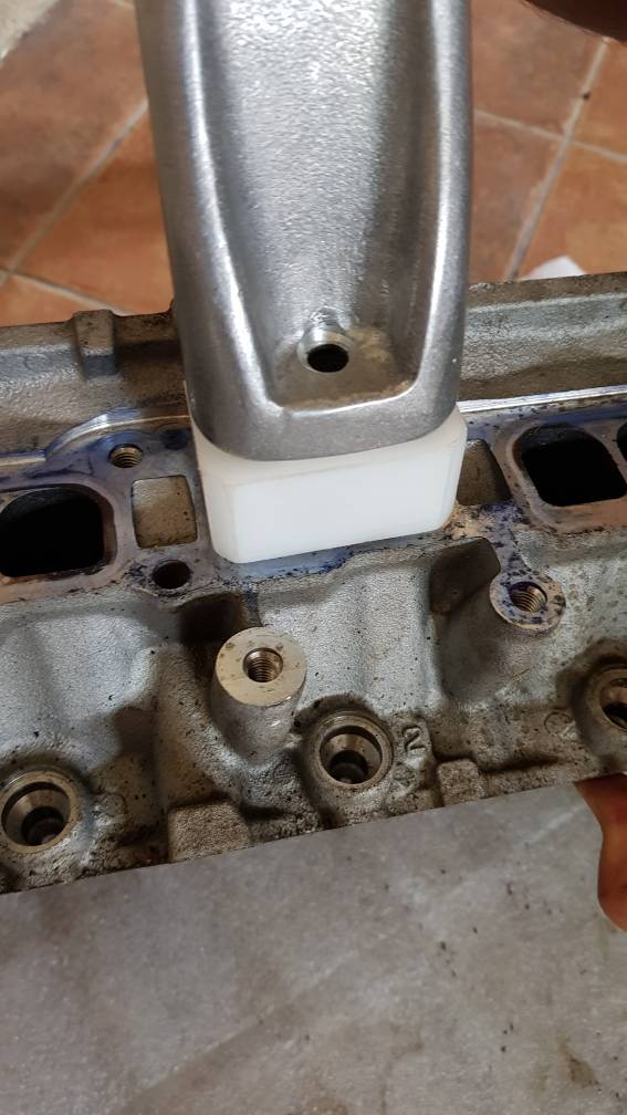

Walnut blasting is the only thorough way. Getting adapters ready for the need...if/when it comes.:)
This photo is confusing.. you mean to tell me you/someone removed the head to access the ports? That looks like part of a rebuild.
