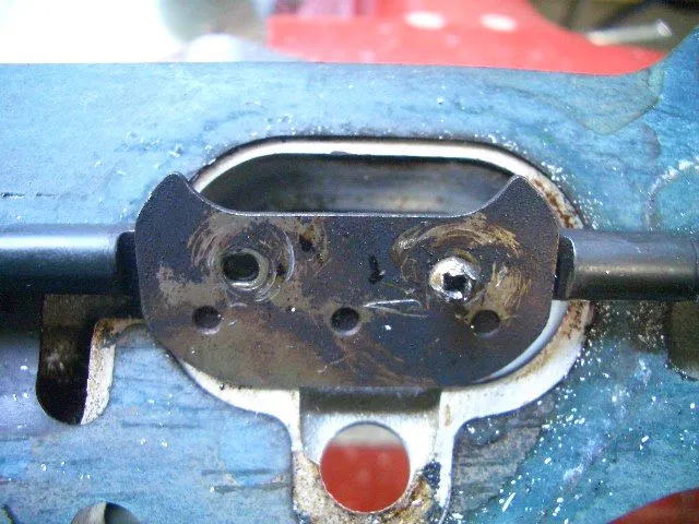

Sunday I had some extra time so I pulled the intake manifold off of my spare motor (came out of a '02 P5).
When I started looking at it I couldn't help but laugh, so I went to my MSP and checked, sure enough the MSP has the same set-up. Those shutter valves at the end of the intake manifold block over 23% (after quick cal.) of the port opening to the head. And then to top it off the difference between the intake manifold port to the head port is HUGE. The head ports dwarf those small intake ports. There is a HUGE amount of power to be made with alittle time and a dremel.
I split the intake manifold and looked at the vics......I can't see improving the setup too much without making another lower half of the intake manifold, so I think I'm gonna leave that portion alone.
I already removed the other shutter valves and jb welded the holes, lined the gaskets for gasket matching the intake manifold, and also made plans for a porting the throttlebody bore...(already ported the throttlebody a few months ago.)
Just thought I'd throw out my plans for the intake manifold.

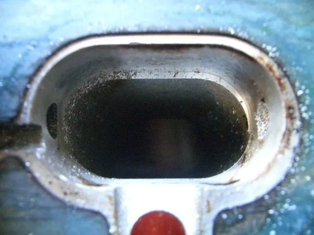

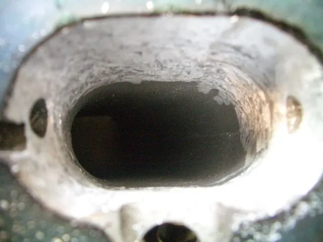

peepsalot- Nothing was touched with the vics system. Thats a whole different set of shutter valves. The ones I took out are for the ulev system on start-up. I'm not sure if the ecu monitoirs this so I don't know if the check engine lights gonna make an apperance.
Pretty much finished up with the porting, just a couple of hrs. worth of polishing left. The ports on the intake now match the size of the ports on the head quite well. Plus I got rid of the step/stoppers for the shutter valves and smoothed it out dramatically.

Its in, on, done. Check engine light came on upon intial start-up, probably due to someone f'in with me and disconnecting the maf sensor (gave me a heart attack, wouldn't idle, smoked, surged......eh...bastards). After that was straightened out, it took alittle playing to get it to idle down properly. Couldn't clear codes, or really play with it too much because the WDS is broken....
Couldn't tell you too much on performance....everything feels faster on the street. I can tell you it runs alittle leaner above 4k. And it sure feels strong... Have to wait for tommorow night to see if any real gains were made.
I do have some nice pics. comparing the stock intake ports to the ported ones....I'll post them tommorow.
