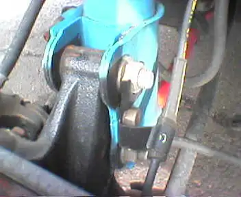

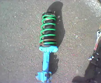

2.Take the clip off the brake line with a screw driver it just pops off.(pic 2)

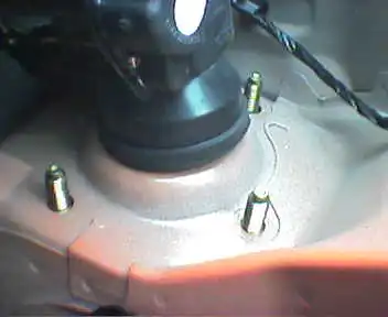

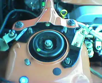

3.Take off the nut that is connected to the linkage of the sway bar it's very tight.(pic 3)

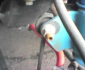

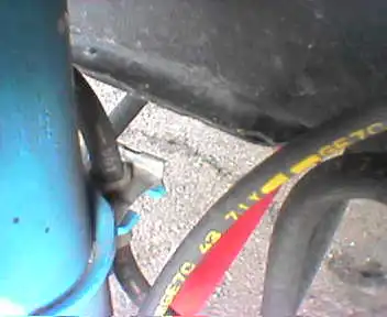

4.Take off the 2 nuts that are connected to the rotor also very tight (pic 4)

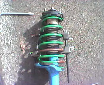

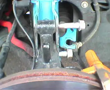

5.The spring will fall out now use your spring compresser and compress the spring and take the top nut off. (pic 5)

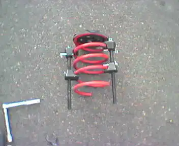

6.Now your spring is done (pic 2)
7.Jack up the rear to help you out on the install of the spring (pic 3 )

1.Take off the bolts on the shock tower in the engine bay (pic 4)
2.take the brake line off (pic 5 )

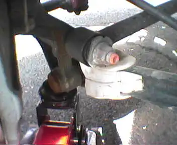

3.Take off the nut to the linkage of the sway bar (pic 1)

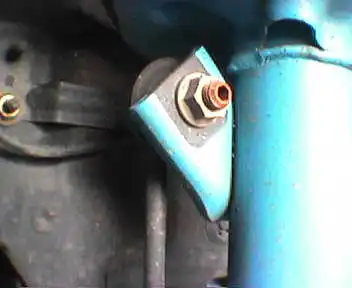

4.Take off the 2 bolts that hold the rotor(pic 2)
5.Remove the spring and compress it to remove the spring (pic 3)

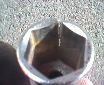

7. I told you that the nuts and bolts are tight it broke my socket haha(pic 4)
